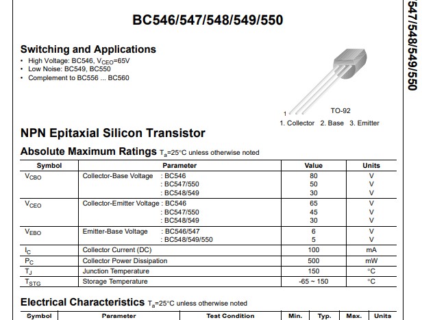

When BC550C/560C are still available, shall one keep using them or is it better to change to BC546/556 anyway?

I would say that they are not similar at all as the BC550 is only a 45 volt device whereas the BC546 has a 65 volt rating.

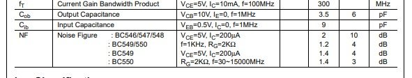

Curiously the noise figure is quoted as being much worse for the BC546.

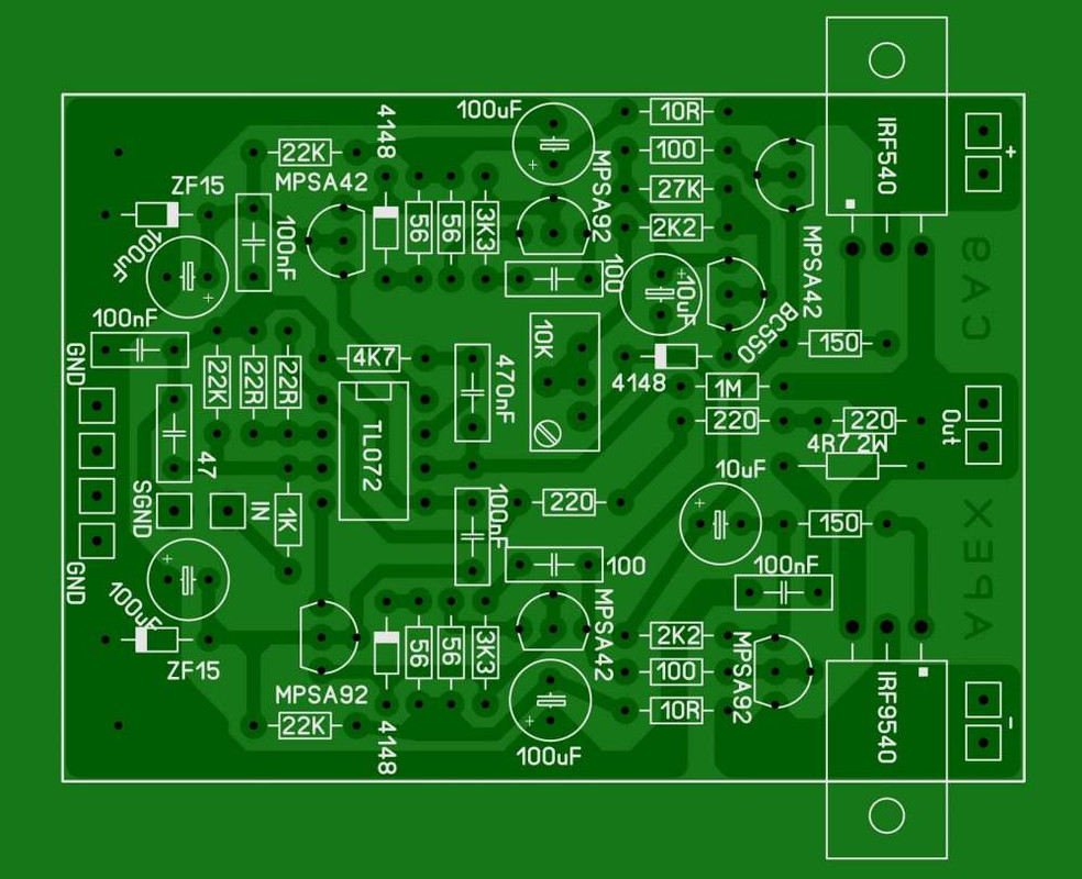

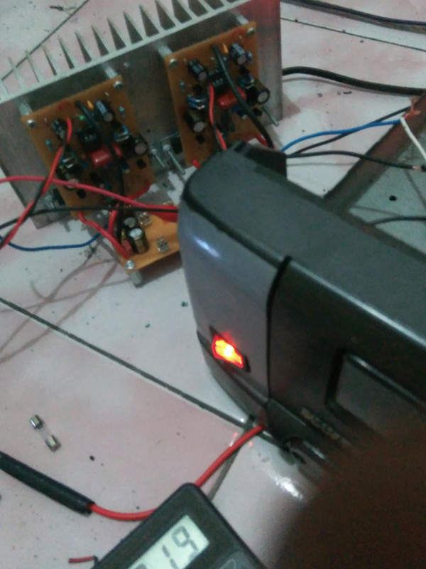

hi mr. mile, is this layout correct?
i build this one and got 12vdc on the output with 35v rail.
i use ksp42/92 insteads of mpsa42/92.
the rest is same as schematic and no short found
gate-irf540--15v
gate-irf9540--15v
ic-pin4--14.5v
ic-pin8--14.5v
ic-pin1--13v
ic-pin7--13v
where should i check, sir? please your help. thank you

Connect SGND to GND
Apex CA9 music test - YouTube
thanks for your reply,Connect SGND to GND
but i don't really understand. the SGND and GND is already connected by 100nf, should i replace them with jumper wire, sir?
thanks
SGND and GND must be connect to PSU GND with separate wires.
thanks, it's sing now!

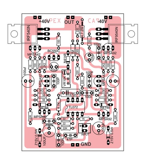

hi alainHy,
Good job kiloz!
Can you share the PCB layout in PDF?
Thanks by advance.
yes, no problem. i will upload this weekend.
