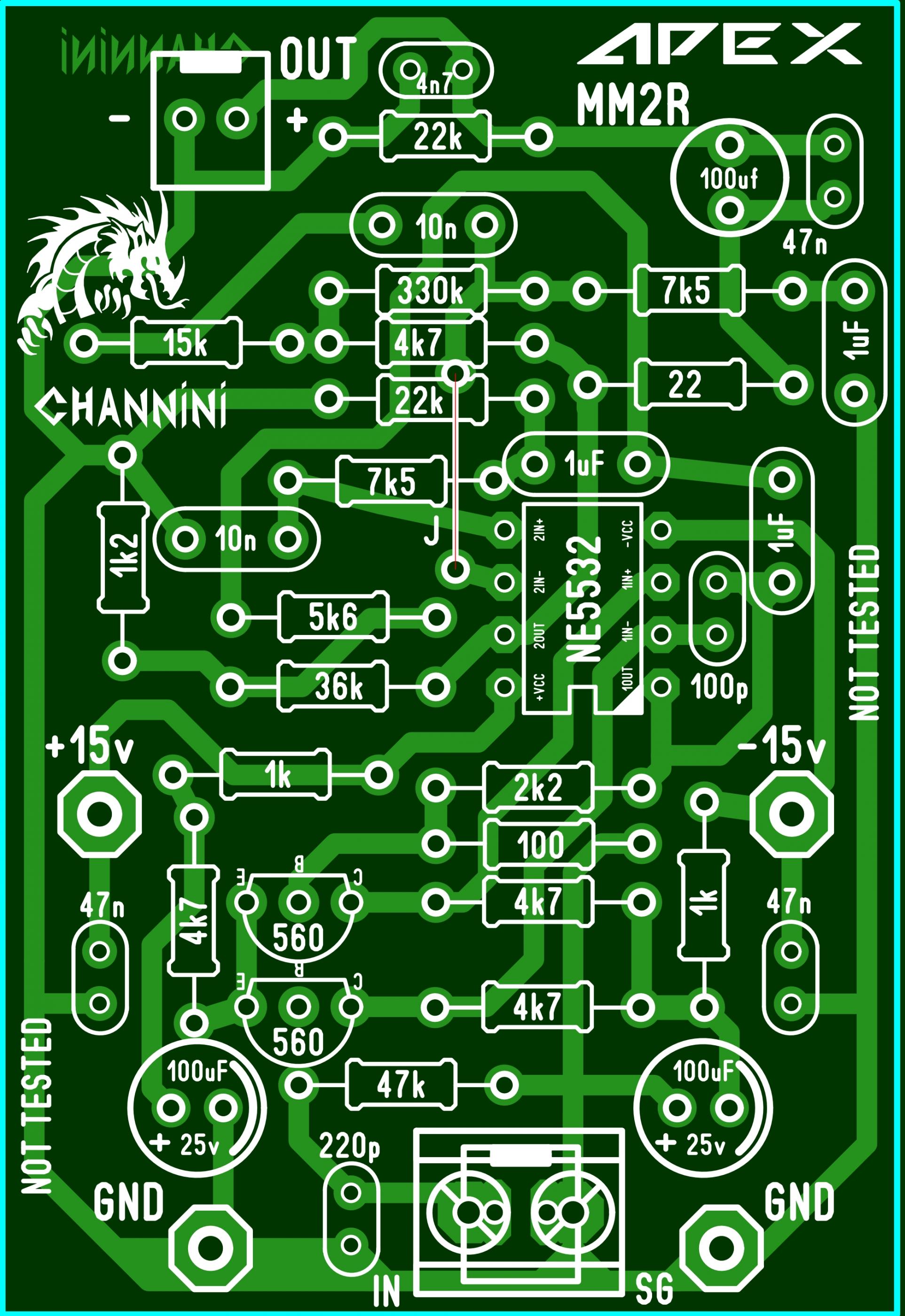

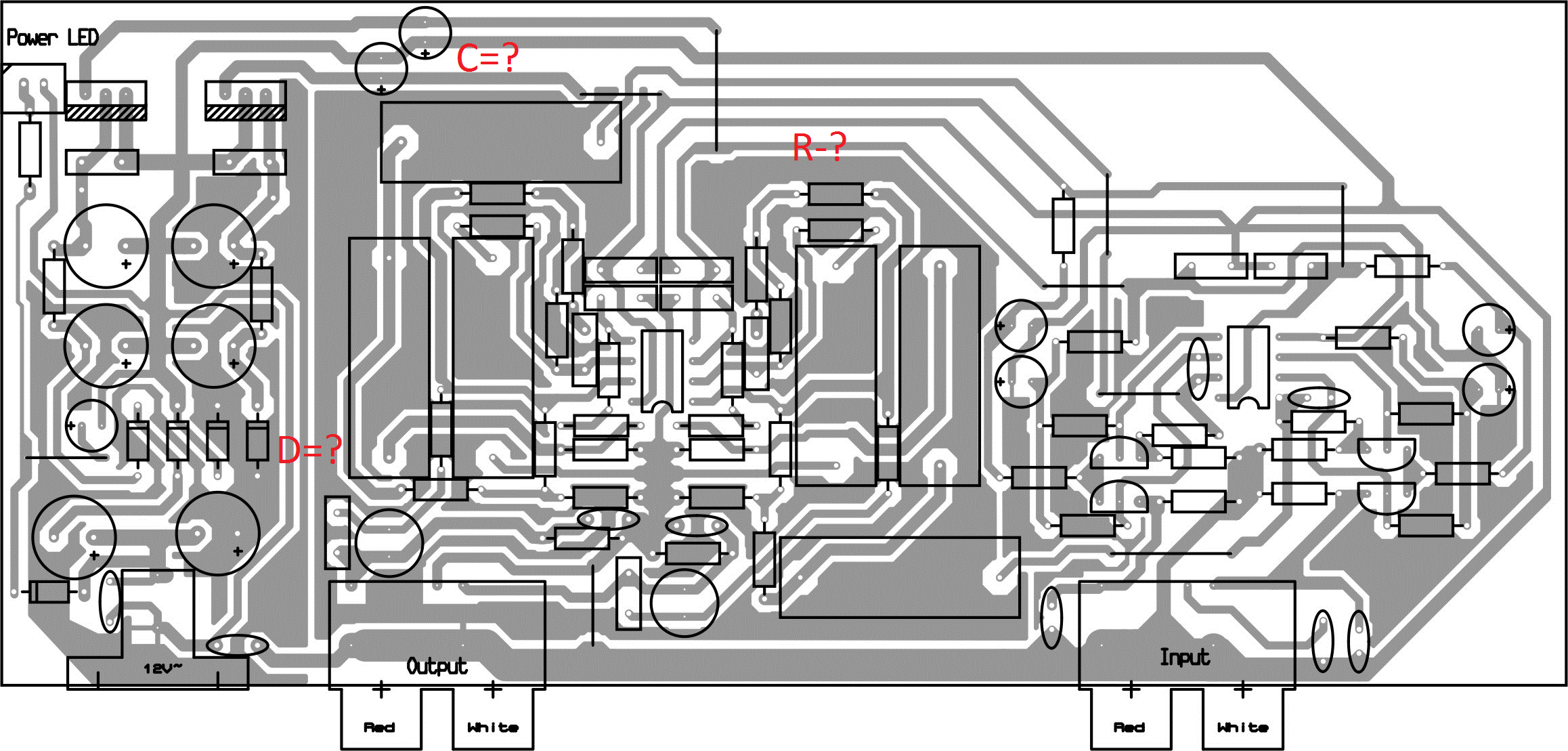

CA9 PCB

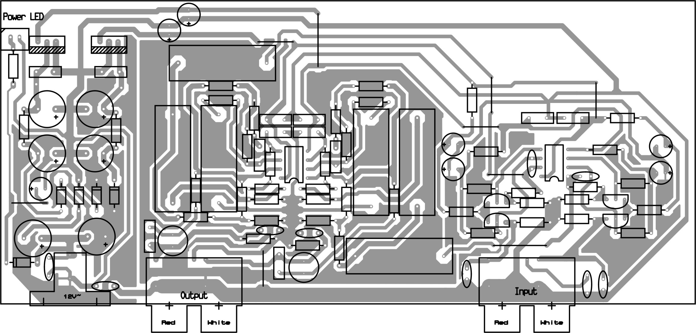

I'll make this one,

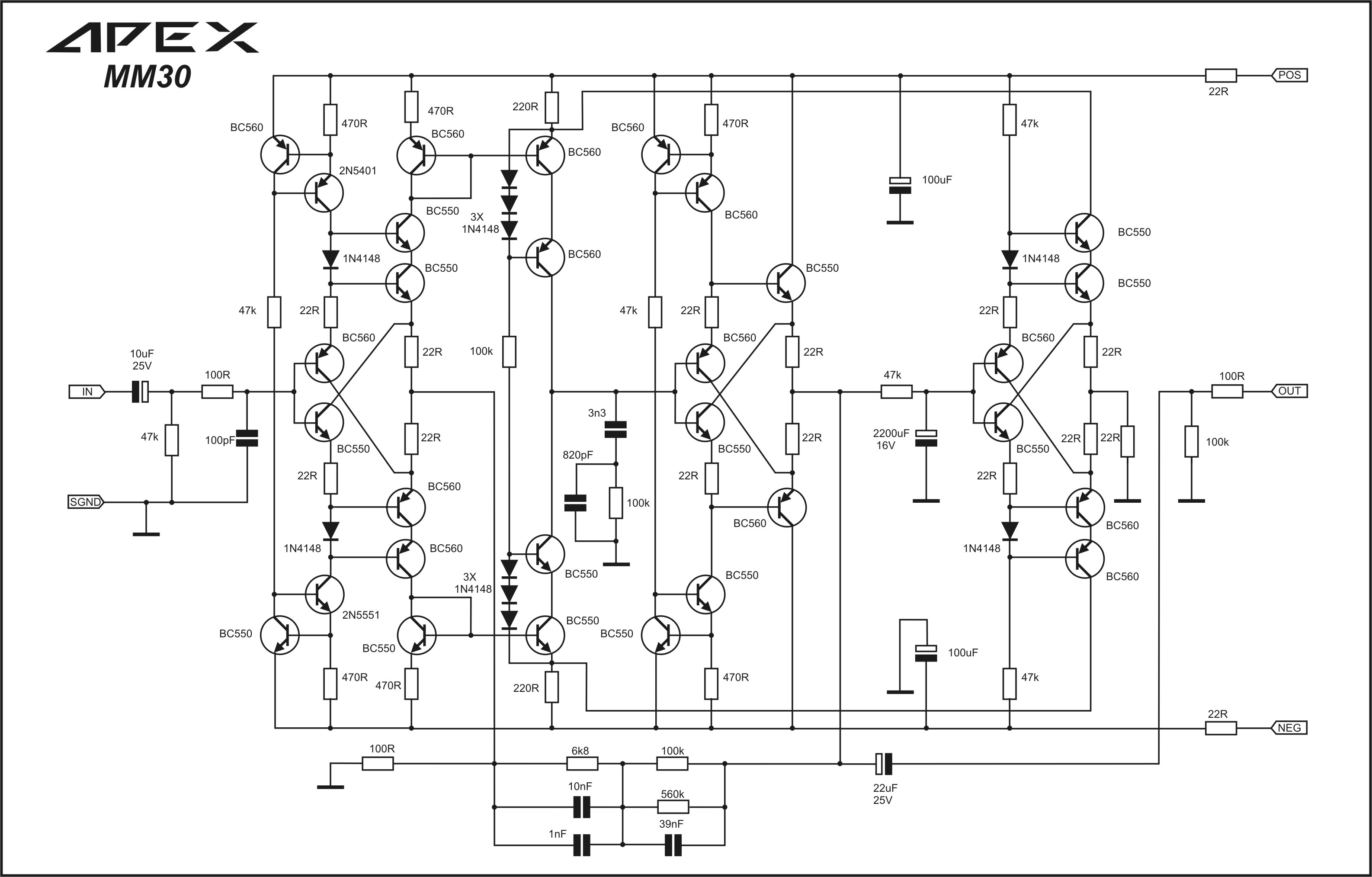

would the vbe multp. will work if they weren't place into main heatsink, sir?
thanks
not tested there could be errors
Nice work, 1uF wrong size...

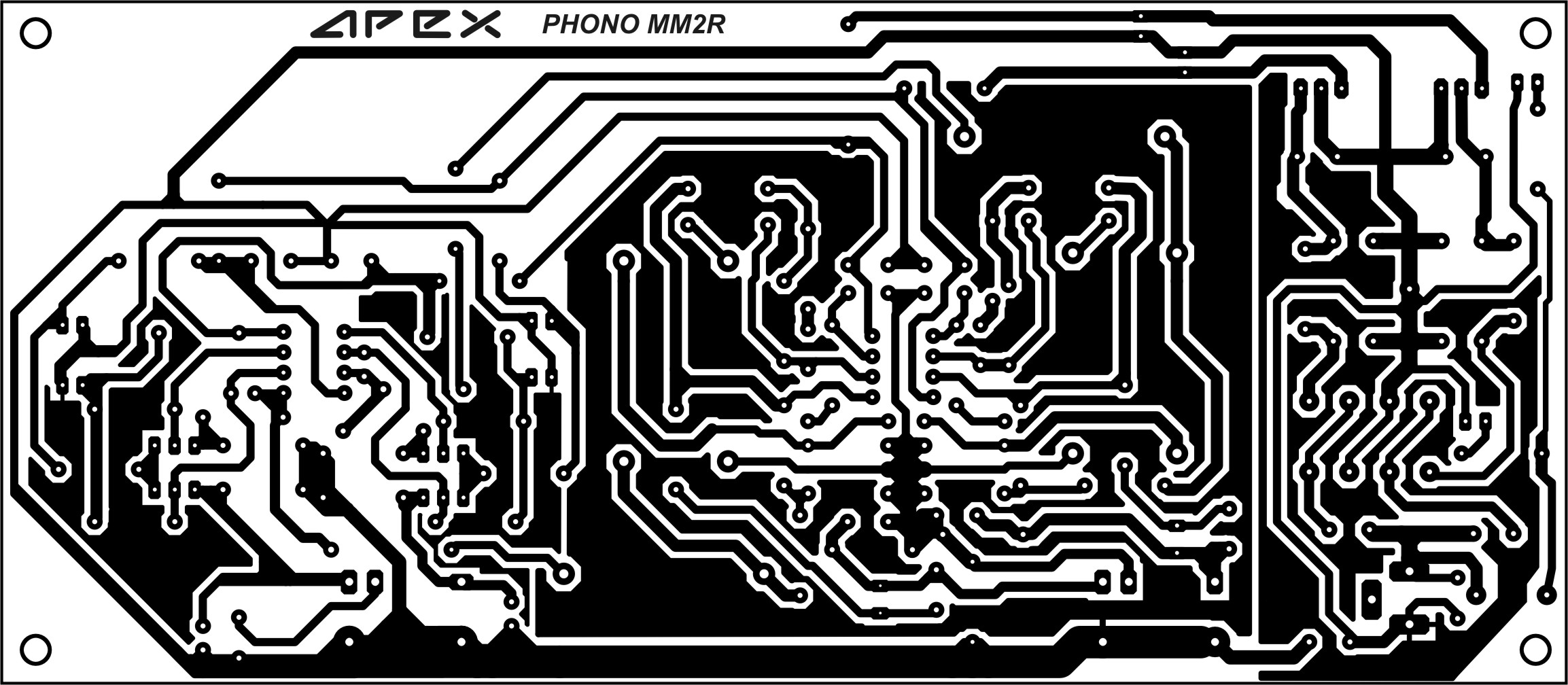

Black&white for home etching?
195x85mm
Yes, that is better with the amp connected to the preamp output, thanks Mile.You must test preamp with amp connect to output, amp input impedance load preamp with 22k... P30ZF DC offset is very good for circuit without global negative feedback.
Regards
Gerbers attached
PS: i still have one spare available

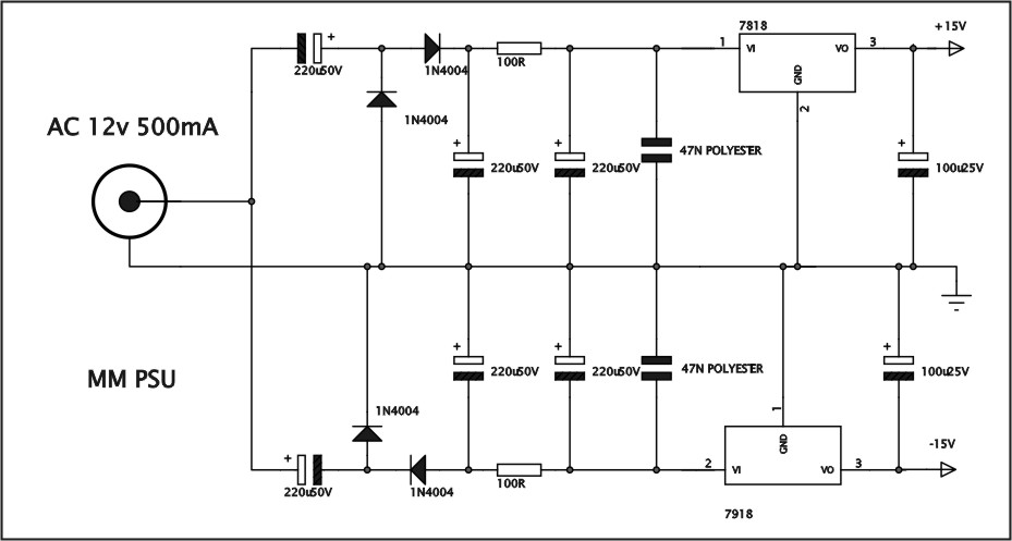

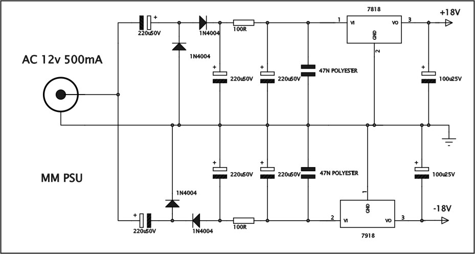

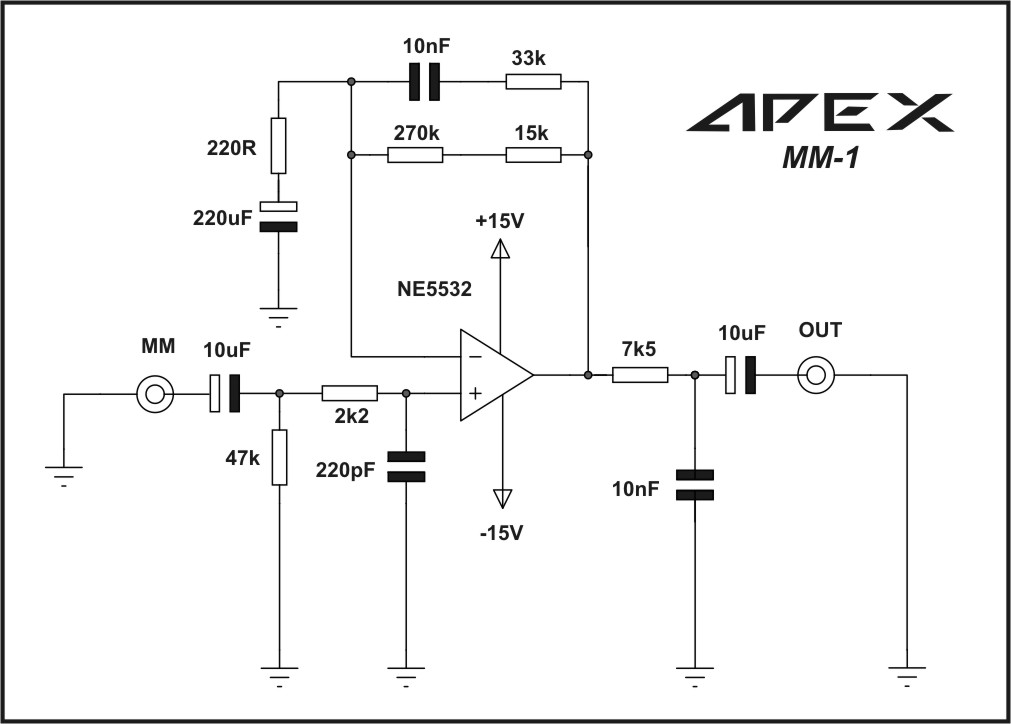

15V out of 7X18?
It’s an error, should be 7815/7915, since a 12vac will only give you 16-17vdc.
In this case, a voltage multiplier. I think you'll get some higher figures there.
https://www.electronics-tutorials.ws/blog/voltage-multiplier-circuit.html
15V out of 7X18?
You are right, output voltage is +/-18V.
Voltage multiplier give over +/-30V DC from single 12V AC.
