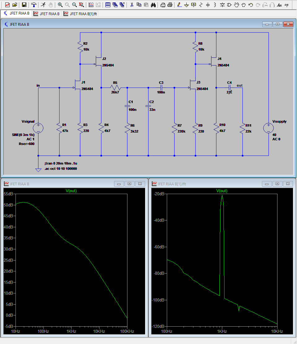

LTSpice filter simulation masterclass: 0 to -100dB in five easy steps!
Posted 19th February 2016 at 12:14 AM by rjm (RJM Audio Blog)
Updated 7th April 2016 at 06:58 AM by rjm
I've never put everything into a single LTSpice worksheet like this before: I find it fascinating. You can really pull apart a circuit to see what makes it tick, before solder ever hits the iron.
Power supply ripple, frequency response, gain, and crosstalk can be established. You can look at turn on and turn off transients, inrush currents, and conductance angle, and check peak currents in the filter capacitors. It's all there if you care to peek in and poke around.
I'm such a huge fan of LTSpice...
The only problem, really, is it is too perfect: all devices are perfectly matched, every part value is exact, and the temperature is always 25 C. Ground loops, wiring inductance, and thermal runaway do not exist. So no, of course there are no guarantees - but as a tool to get you 90% of the way there with the minimum of fuss and bother it is truly indispensable.

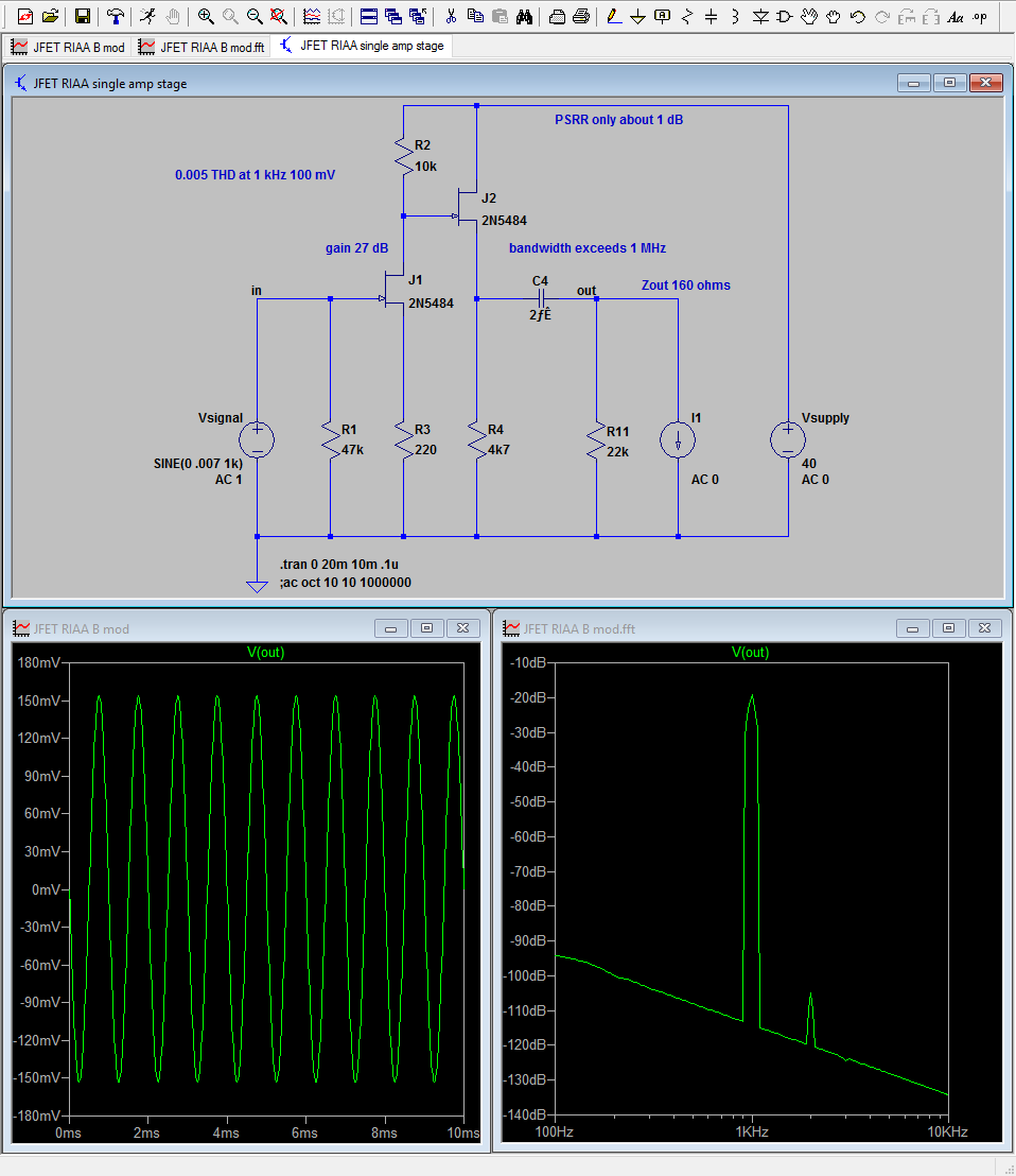

Old
jFET passive phono preamplifier circuit idea
Posted 16th February 2016 at 02:27 PM by rjm (RJM Audio Blog)
Updated 17th February 2016 at 12:51 AM by rjm
There are various tricks, like parallel input devices and active current sources, that I have avoided here in the interests of simplicity. If you want to go down that road, you can get an idea where it leads, here. Instead, the circuit below is basically a JFET version of my old 6DJ8 amp, here. A single JFET was getting me nowhere in terms of output impedance - around 10kohms! - so I moved to a compound stage buffering each amplifier with a source follower.
Noise and distortion figures look okay. The gain is only 30 dB. A bit low. The main trick is the PSRR, which is awful. The two stage circuit actually amplifies the power supply noise onto the output. So considerable effort must be put into the power supply regulation and filtering. I note that this is pretty much par for the course with this circuit topology where resistors are used instead of current sources on the JFET drains.
The circuit below leaves out the usual RC filter inserted between the power supply...

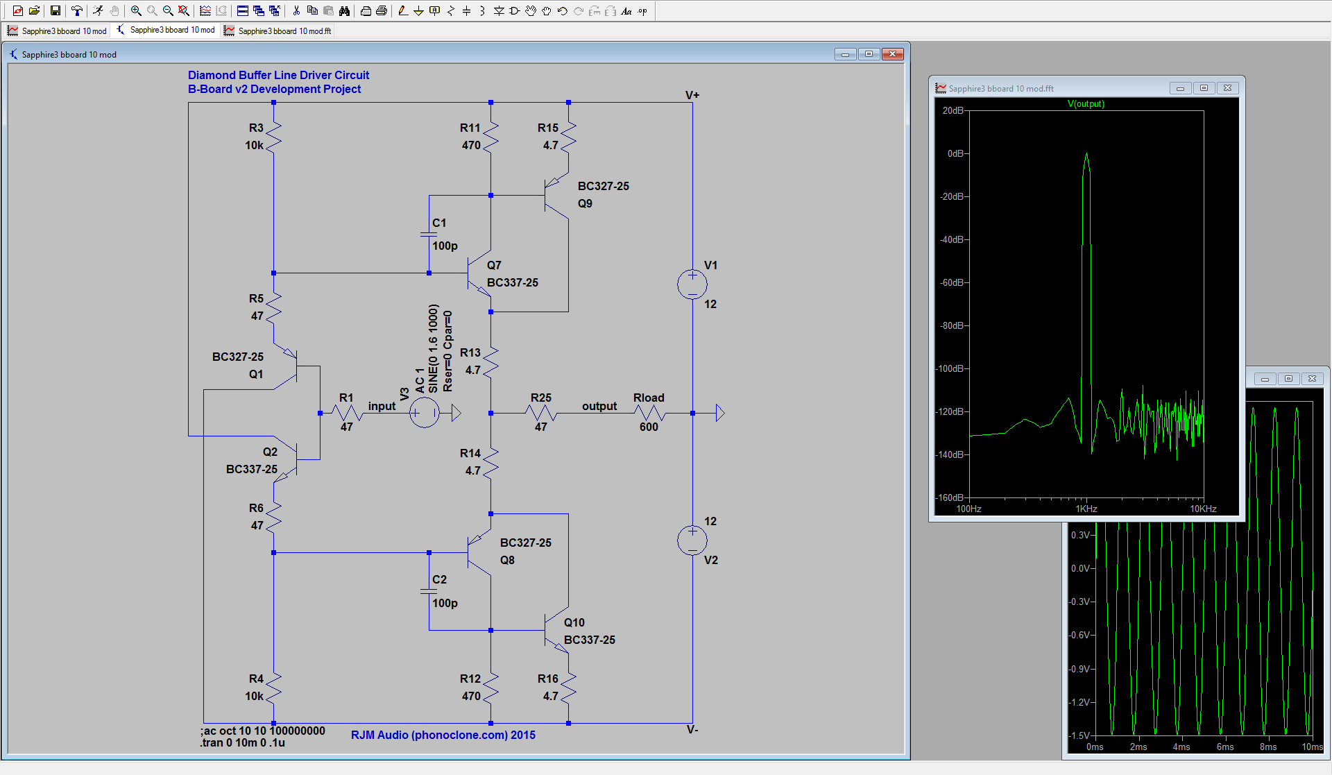

B-board v2 line driver : development circuit
Posted 30th October 2015 at 12:49 PM by rjm (RJM Audio Blog)
Updated 30th October 2015 at 12:56 PM by rjm
Original version is here.
I've been meaning to get around to updating this by folding in the improvements to the diamond buffer stage made during development of the Sapphire 3 headphone amplifier. Here is the first look of the bboard v2 under LTSpice.
I've gone back to simple emitter resistors on the input, running under much lower current to keep the input impedance high. The output is simplified to a basic Sziklai compound transistor pair with the bulk of the bias current running in the second transistor.
In terms of distortion, for line level output level, CCS loaded input has no advantage. I'll have to double-check PSRR and a few other things before signing off on this version though.
FYI only, not a production circuit.

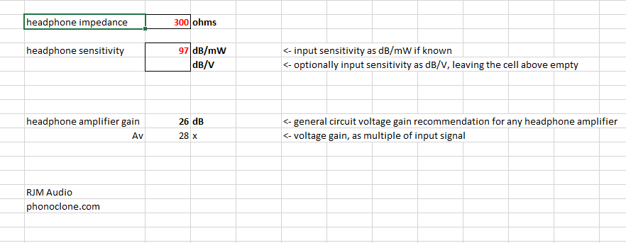

A headphone amplifier gain calculator
Posted 2nd May 2015 at 05:30 AM by rjm (RJM Audio Blog)
Updated 2nd May 2015 at 05:33 AM by rjm
You input the headphone sensitivity and impedance, and it spits out what I think is the ideal amplifier gain.
Even if you disagree (personal preference, difference input levels, etc.), the difference will be consistent regardless of headphone as long as the specified parameters are correct.
The gain value setting is tailored to normal line level input and listening fairly loud with the volume control at 9~10 o'clock. The output series resistance is assumed to be zero ohms.
Adjust as desired, and note that 3~6 dB either way will still be a usable. If your amp has a large output series resistance the gain Av should be scaled up as,
(Routput + headphone Z)/(headphone Z)

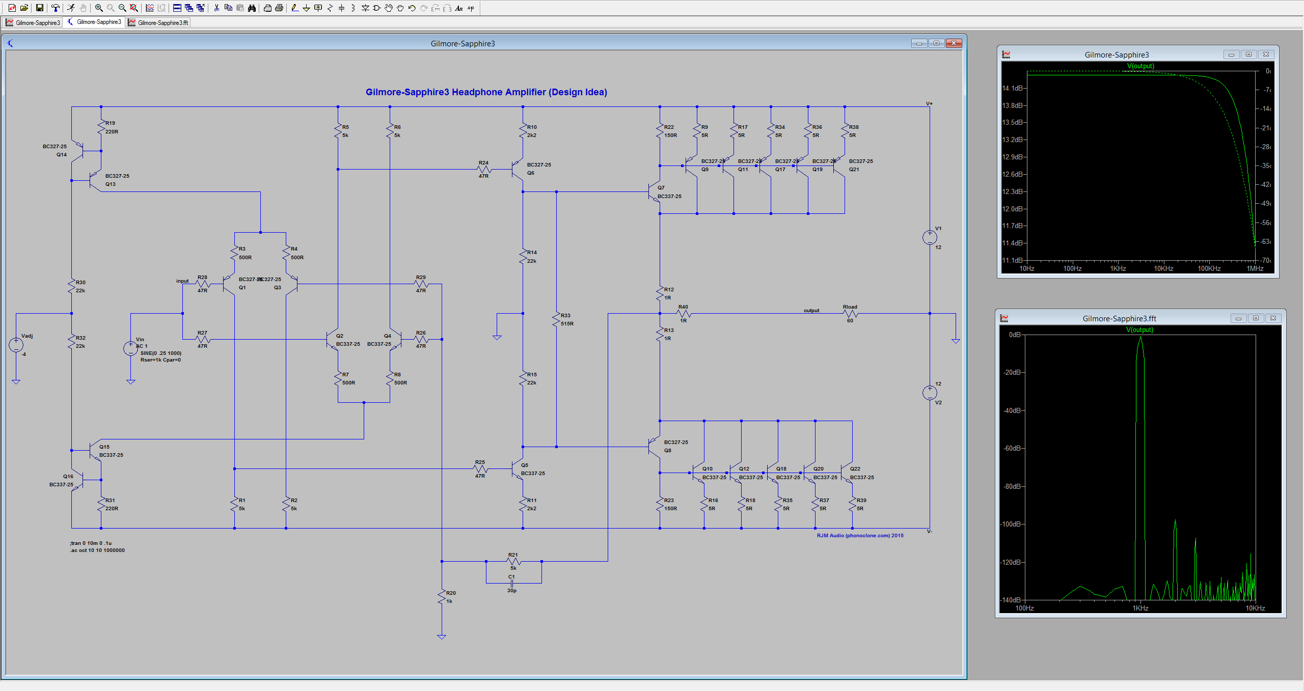

Doin' a "Gilmore" : a discrete transistor headphone amplifier
Posted 10th March 2015 at 12:17 AM by rjm (RJM Audio Blog)
Updated 13th March 2015 at 10:42 PM by rjm
Recently I spent some time updating the diamond buffer of Sapphire headphone amp circuit. Later I stumbled on Kevin Gilmore's headphone amp circuit. Well, I'd read it before, but it had slipped my mind.
On seeing the Gilmore circuit again the thought process re. a Sapphire+Gilmore went something as follows,
"Toss out op amp, convert the Gilmore dual-LTP front end to bipolar, bolt the Sapphire3 buffer stage to the back, and substitute in the Sapphire3 current sources. Wrap in a mild feedback loop."
The result is shown attached. The Vbe multiplier is still a simple resistor (R33) ... that may need to be refined to add thermal throttling. The offset servo is not shown, but the action is shown as Vadj. Alternatively a trim pot would be placed between R30 and R32 to provide a small measure of offset adjustment. Most of the open loop gain is controlled by R14,R15 ... it seems to me that some work could still be done in that area. Despite going...

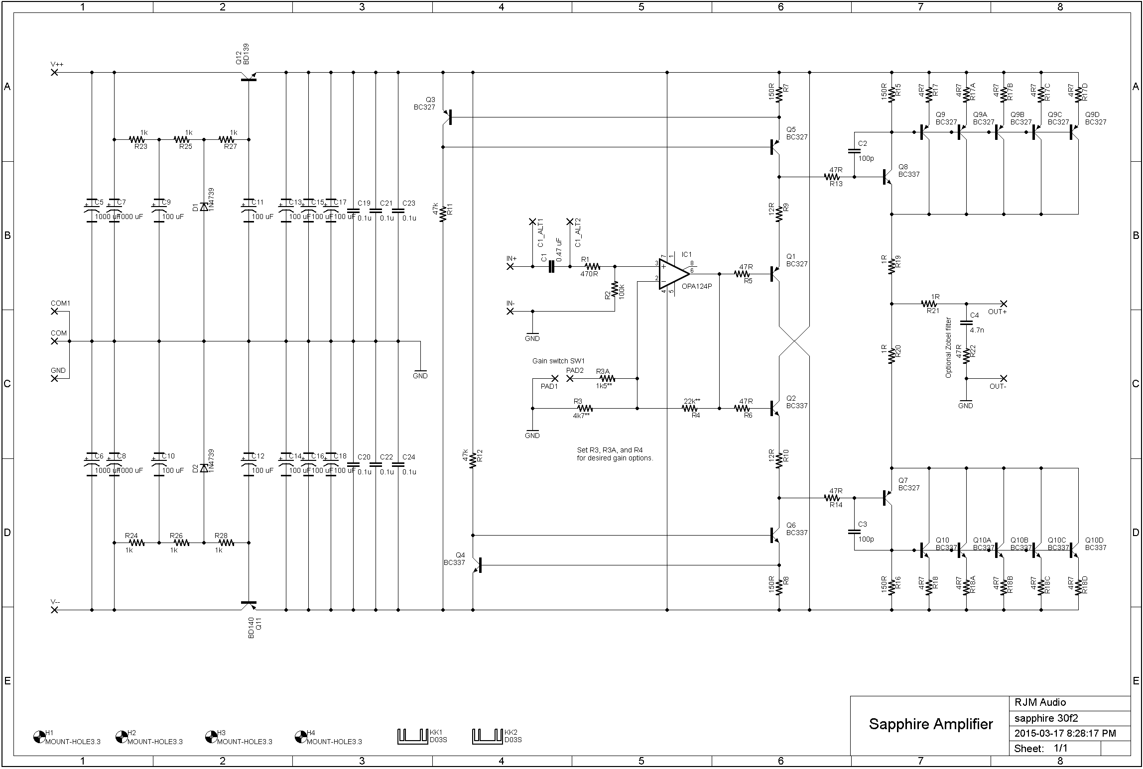

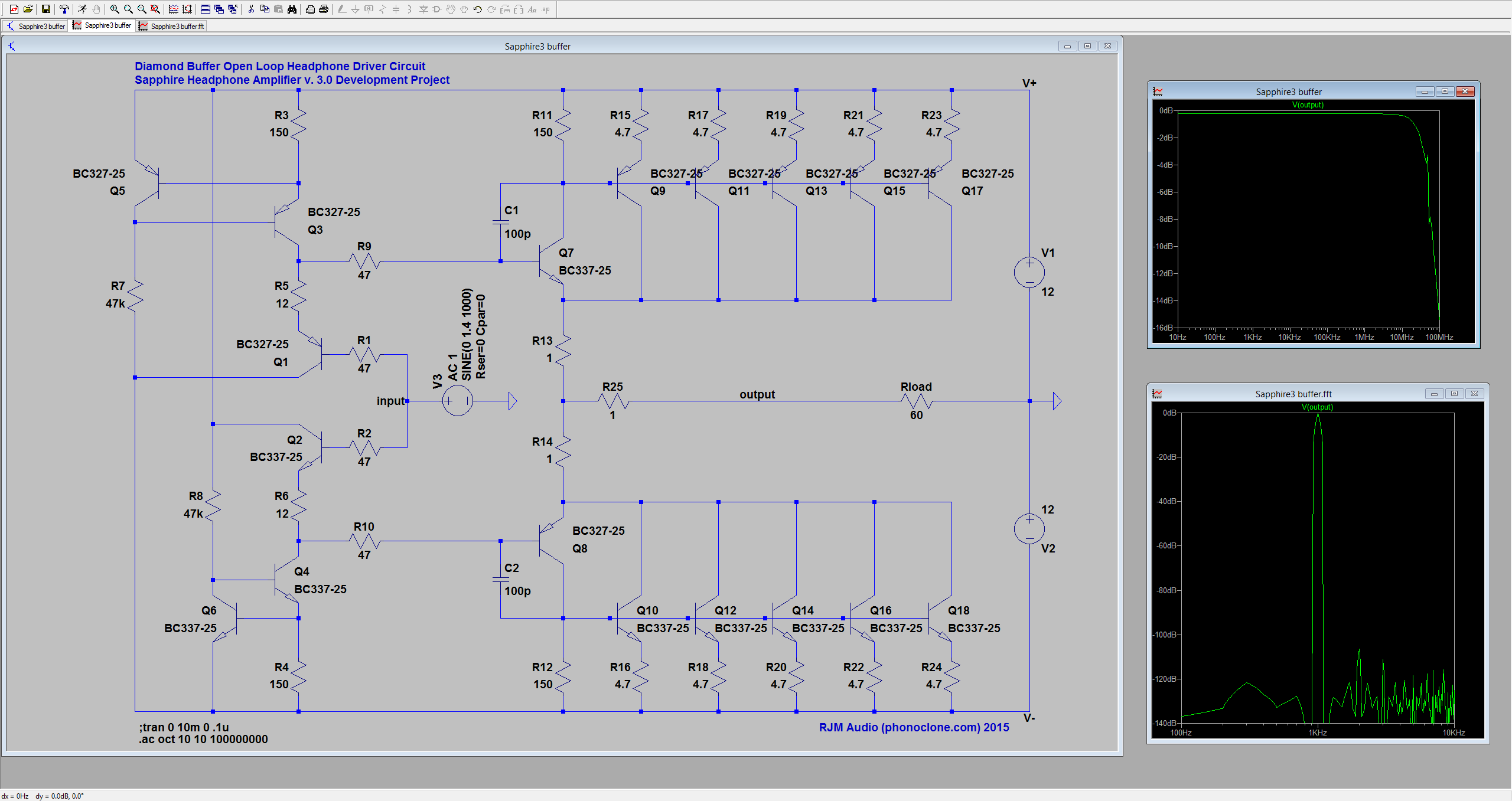

Refining the Open Loop Diamond Buffer Headphone Driver (RJM Audio Sapphire 3.0)
Posted 31st January 2015 at 01:28 PM by rjm (RJM Audio Blog)
Updated 18th March 2015 at 01:52 AM by rjm (add photo of finished amp)
A couple of years ago I built a standard op amp + diamond buffer headphone amplifier, called the Sapphire.
My original circuit (Sapphire 1.x) was the simple four transistor four resistor diamond buffer of the LH0002. Later small resistors (Sapphire 2.0) were added to the emitters of the driver transistors to boost the output bias current.
In this next go-round (Sapphire 3.0), I've replaced the emitter resistors with current sources. This provides a significant improvement in PSRR, over 20 dB in simulation. The output pair has been reinforced in a Sziklai configuration for lower distortion, and the primary output transistors five-way paralleled for improved thermal stability. The output impedance is 1~2 ohms, limited primarily by the output resistor.
It simulates to <-100 dB harmonics for 0 dB (1 V rms) output into 60 ohms. The total circuit standing current is less than 50 mA per channel.
LTSpice files below. R5,R6 on LTSpice...
