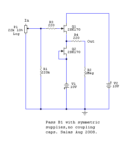

how would pass b1 type buffer fair out instead of ef's in such situations?
what voltages are required for the class a ef buffer?Posted 1st December 2016 at 12:07 AM by nige2000 -
EF buffer needs supply voltage about 1V more than the signal its handling in both directions. So suppose its handling 1VRMS that's 2.8V peak to peak, you'd need a 5V supply as minimum. You'd also need to control the DC offset tightly if you used the minimum supply voltage. Do you have a link to the pass b1 schematic, I'm not familiar with it?

Don't those FETs have rather tricky availability? Do a similar thing but using bipolars, its easier and cheaper. But it makes no sense to put the load across the current source, the load should be across the active transistor. Putting the load across the current source makes the circuit ps sensitive.
If you use bipolar transistors then you can make a buffer which can handle 1VRMS with two LiIon batteries for supply (7.2V).
Notice the JFET is needed to get zero input offset voltage because its fed by a pot (pots are very DC sensitive), but with no pot the input offset isn't very important. The FET needs an output cap all the same as its Vgs is not going to be zero.Posted 1st December 2016 at 01:24 AM by abraxalito

There's loads of 2sk208 FETs about though

I think the pot needs to be after buffer not before as it is now
If the pot is DC sensitive it would either need a traffo or DC blocking cap before signal enters a pot?
I'll definetly try a tvc on amp out too as I think it would be nice not to use a potPosted 1st December 2016 at 01:56 AM by nige2000 -
You mean you'd use the amp's power supply to feed a buffer? 32V either side? Or you have another one? If you tap off from your batteries that'll have a fair bit of load-dependent noise on it, wouldn't want to feed that into a line stage.
Yeah you either want a trafo or a cap to ensure no DC on your pot, preferably replace it with TVC.Posted 1st December 2016 at 02:12 AM by abraxalito -
