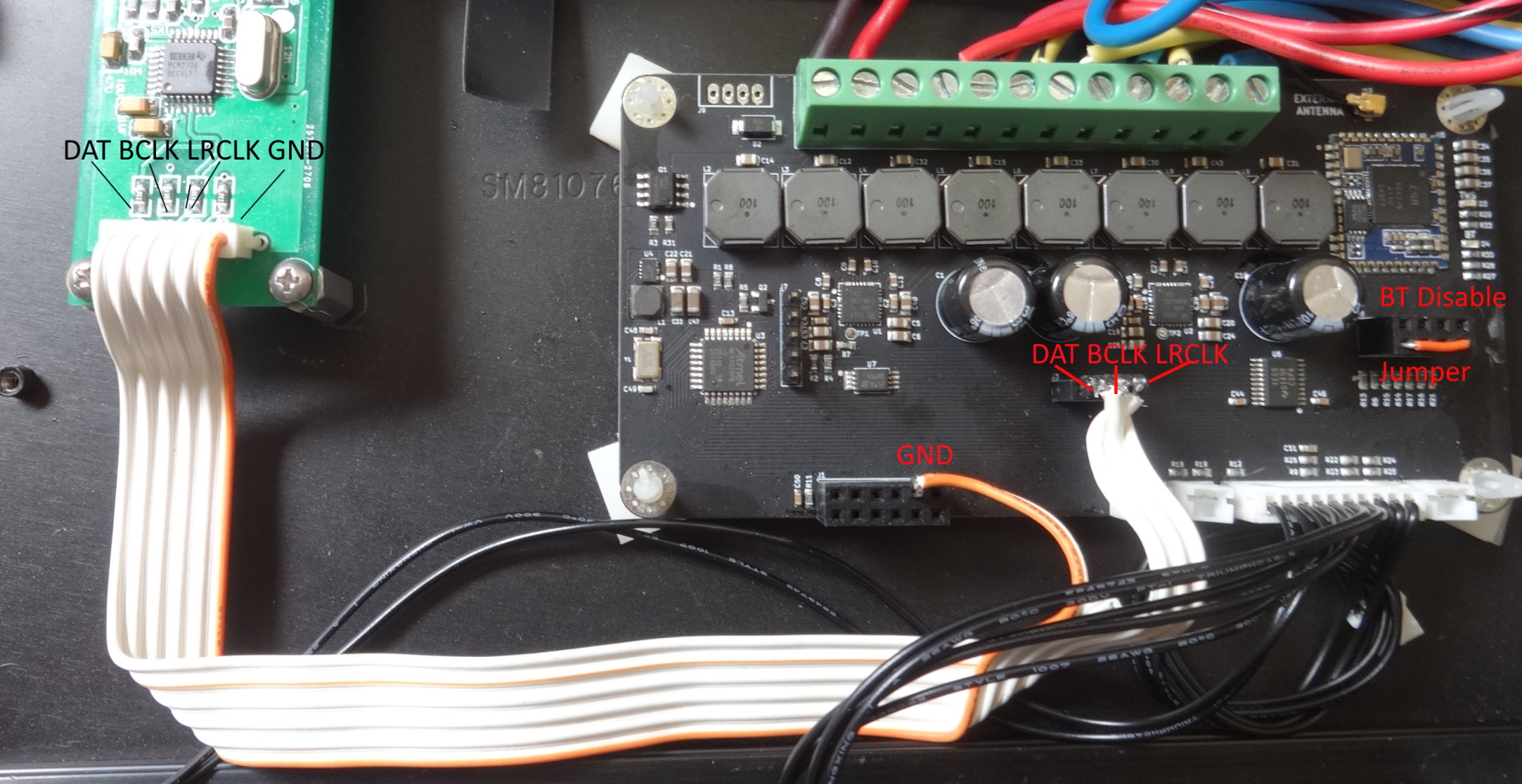

I successfully wired up a USB to I2S converter to my AIO4CH. Here's a picture showing the connections - while playing, of course! It's an ebay / aliex PCM2706 board, works for the 44.1 / 48 k stuff. Works using my W10 PC laptop and my rPi 3B running PiCorePlayer.

What you see there is a cheap PCM2706 module off ebay. I dont see the same one there anymore there, but I do on Alibaba. There's many modules available that take USB in and produce I2S. Unsure if there's something that takes Toslink or coax in and makes I2S signaling. Taidacent Es9023p Aux Analog Output Usb To I2s Iis Converter Raspberry Pi Digital Audio Input Stereo Dac Decoder Board - Buy Dac Board,Raspberry Pi Dac,Usb To I2s Converter Product on Alibaba.com - this looks like a better designed version of the module I used. Price is right to experiment!

You can hack a USB to I2S setup together like jjasniew did, but its not officially supported.
So I would not recommend it if you have limited DIY experience.
The 5 pins on the board are an expansion header with I2C and power pins. Its only used by advanced users that need to hook something external up.

BTL = Btidge tied load (as opposed to connected to ground on one end)
PBTL = Parallel BTL to get more current.
