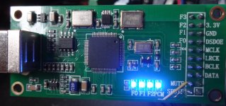

I successfully wired up a USB to I2S converter to my AIO4CH. Here's a picture showing the connections - while playing, of course! It's an ebay / aliex PCM2706 board, works for the 44.1 / 48 k stuff. Works using my W10 PC laptop and my rPi 3B running PiCorePlayer.

I got my XU208 XMOS based DAC card connected to the AIO4CH via I2S. So add another card style to the list of working modules.
Regarding the BT switch, I'm hoping it'll be as easy as the jumper shown previously and in the doc for this. With the jumper connected, BT receiver never wakes up, leaving the clocks and data lines "open circuited" I assume - allowing those to be driven by an external USB to I2S device.
I'm hoping if the USB to I2S board doesn't get 5V power, it does pretty much the same, allowing the internal BT chip to take over the I2S. So the switch would - in one position;
1. Make the jumper connection.
2. Apply +5 to the USB DAC card.
In the other position, the opposite of course -
1. Break the jumper connection.
2. Remove +5 from the USB DAC card.
The switch would have to be positioned before power up the amplifier - I wouldnt expect it to work on the fly.
