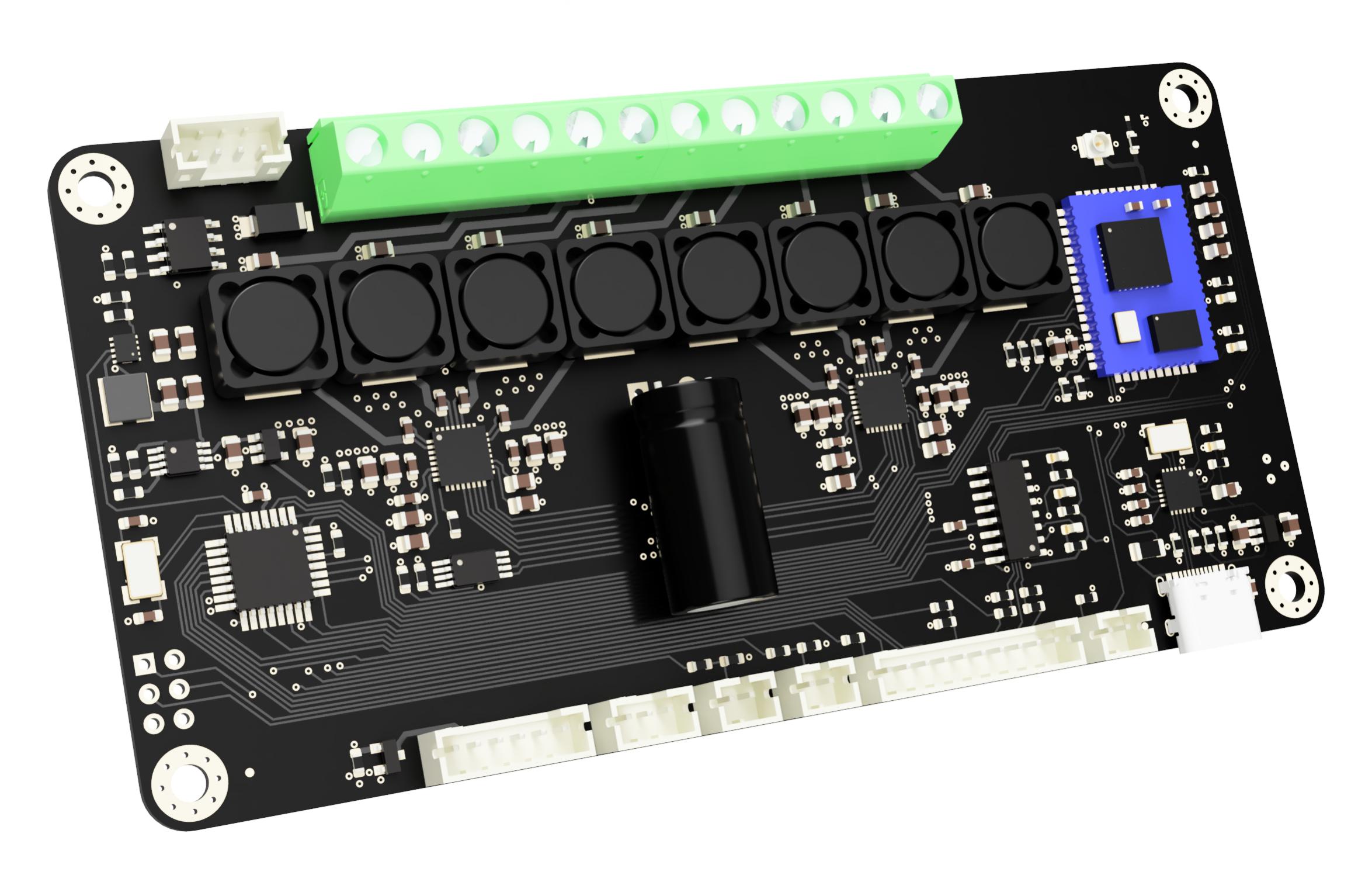

Update!
The TAS5825M has been impossible to source lately. I ordered a large reel, so I thought I was safe for the coming months. The sample ICs were working, however the chips from this new reel do not respond to commands at all. I am actively working together with the supplier to find a solution, but my hopes are not high. Even if I get a refund, I am still stuck without chips.
What this means for the near future is that the AIO4CH is out of stock. The downtime will be used to get its succesor ready. The design is already pretty far, the main challenge is getting the bluetooth firmware ready.
The current design is based on the CSRA64215, the new design uses the QCC3031 BT5.0 chipset. There will be free beta hardware available soon for anyone that is willing to help with firmware development.
Other improvements include an onboard programmer, onboard antenna (with the option for an external one) and USB audio streaming.
Meanwhile I will keep an eye out for a reliable source of TAS5825M's. Let's hope some stock comes available in the nearby future so we can get this new board to market soon.

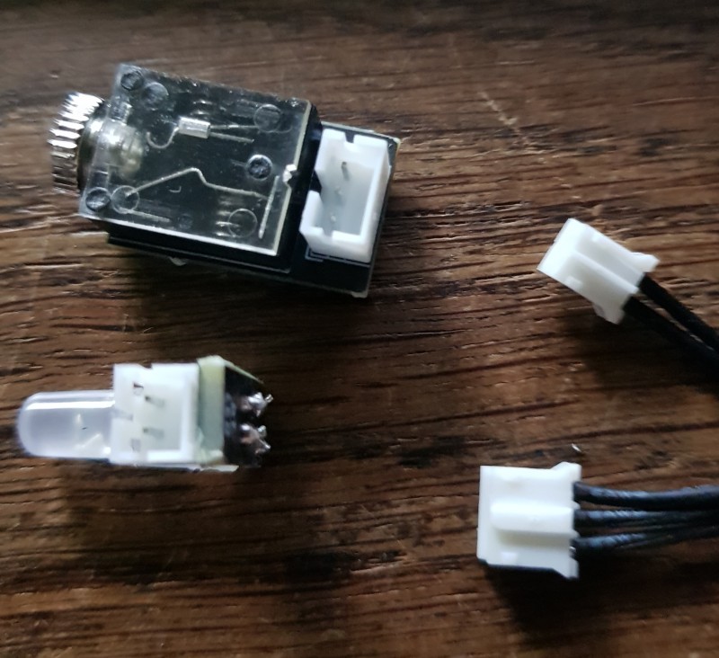

@Christian K
Those are from the JST-PH series. You could make your own version, the pin functions are on the backside of the PCB

@Christian K

AIO438 announcement
As is known, the AIO4CH is currently out of stock.
The downtime has been used to work on its successor, the AIO438.
The AIO438 is based around the same amplifier chip as the AIO4CH but adds a list of improvements:
1) Upgrade to BT5.0
Improves the sound quality, range and power consumption.
2) Onboard antenna
Ideal for compact installations. Connecting an external antenna is still possible.
3) Onboard USB-C port
This can be used to reprogram the DSP and to stream USB audio, which is possible at the same time. This removes the need for external programmers.
4) Improved configuration tool
Easier to use with faster upload speed and a more robust data transfer protocol. The beta version has been send out quite some time ago, and the feedback is good. Currently it is released with a limited feature set. The version with a full feature set will be released together with the AIO438.
The website is currently offline to prepare the pre-order page. The amplifier will be released with the same functionality as the AIO4CH minus the TrueWirelessStereo function.
For those interested, there will be a developer software package available, which allows developers to access the firmware of the bluetooth module. There are multiple features that are nice to have (SPDIF, TWS), but too time intensive to include at the release date. Hopefully with the help of other community members we can expand the BT functionality over time and release the updates to other users.
The amplifier will start to ship on the 10th of januari in order of payment.
The price for the amplifier including wiring kit will be 99.95€ excluding VAT.
More updates will follow as development progresses.
