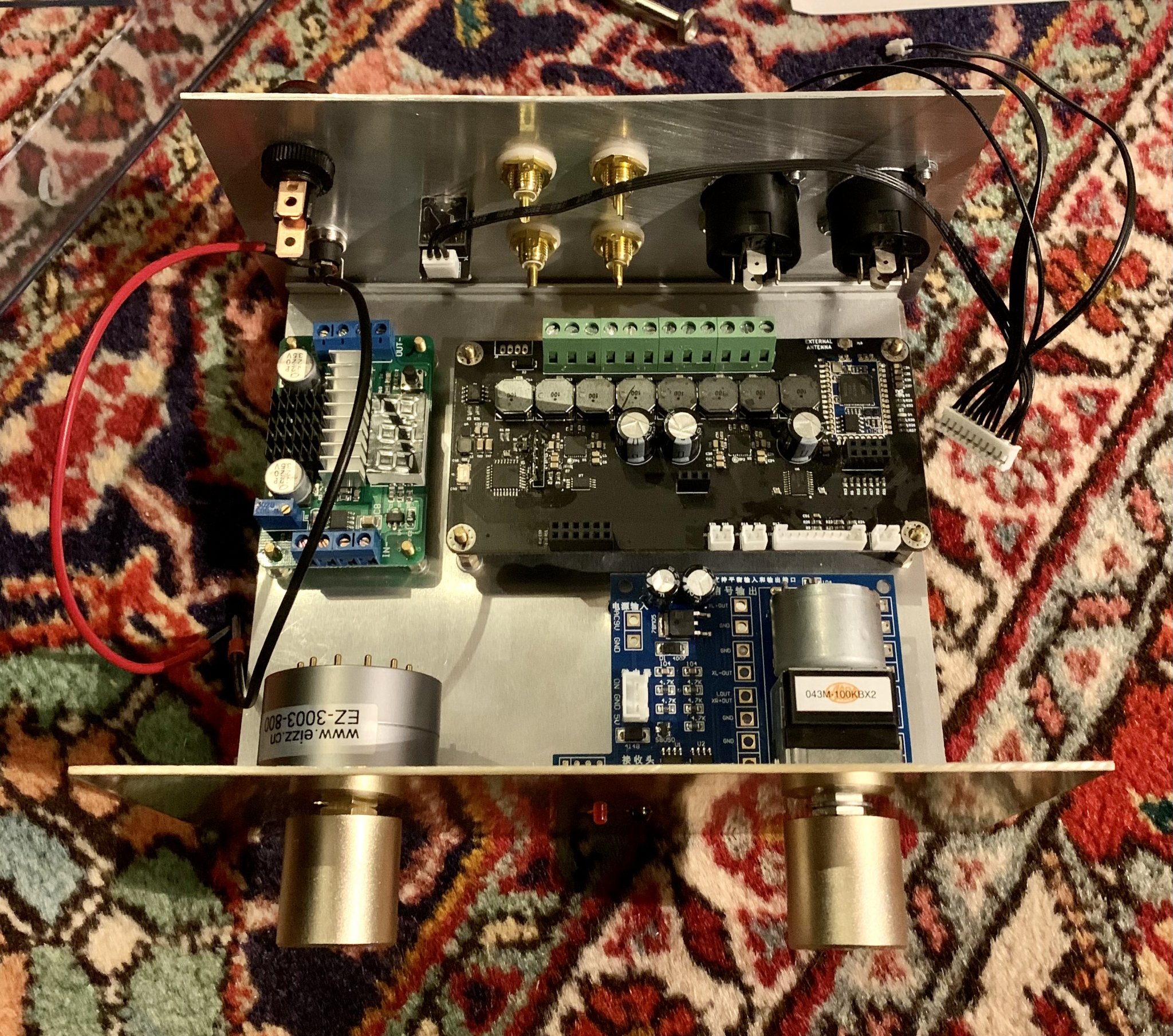

I am using a Li-Ion battery pack 18650 6s3p with onboard BMS. It outputs less than 25v. It is similar to this one:
2021 new 6s3p 24 V 18650 Li ion battery 25.2 V 19800 MAH E bike, moped / electric / Li ion battery pack with charger for sale|Battery Packs| - AliExpress
I have just tried the amplifier with a 19v laptop brick (smps I presume). The standby noise is the same.
The hissing/whine increases when the volume knob is turned up.
My speakers are 4x FaitalPRO 4FE32 4ohm 91dB in stereo dipole configuration.
A fix is needed. It is not really liveable with as it is. Any ideas would be appreciated.

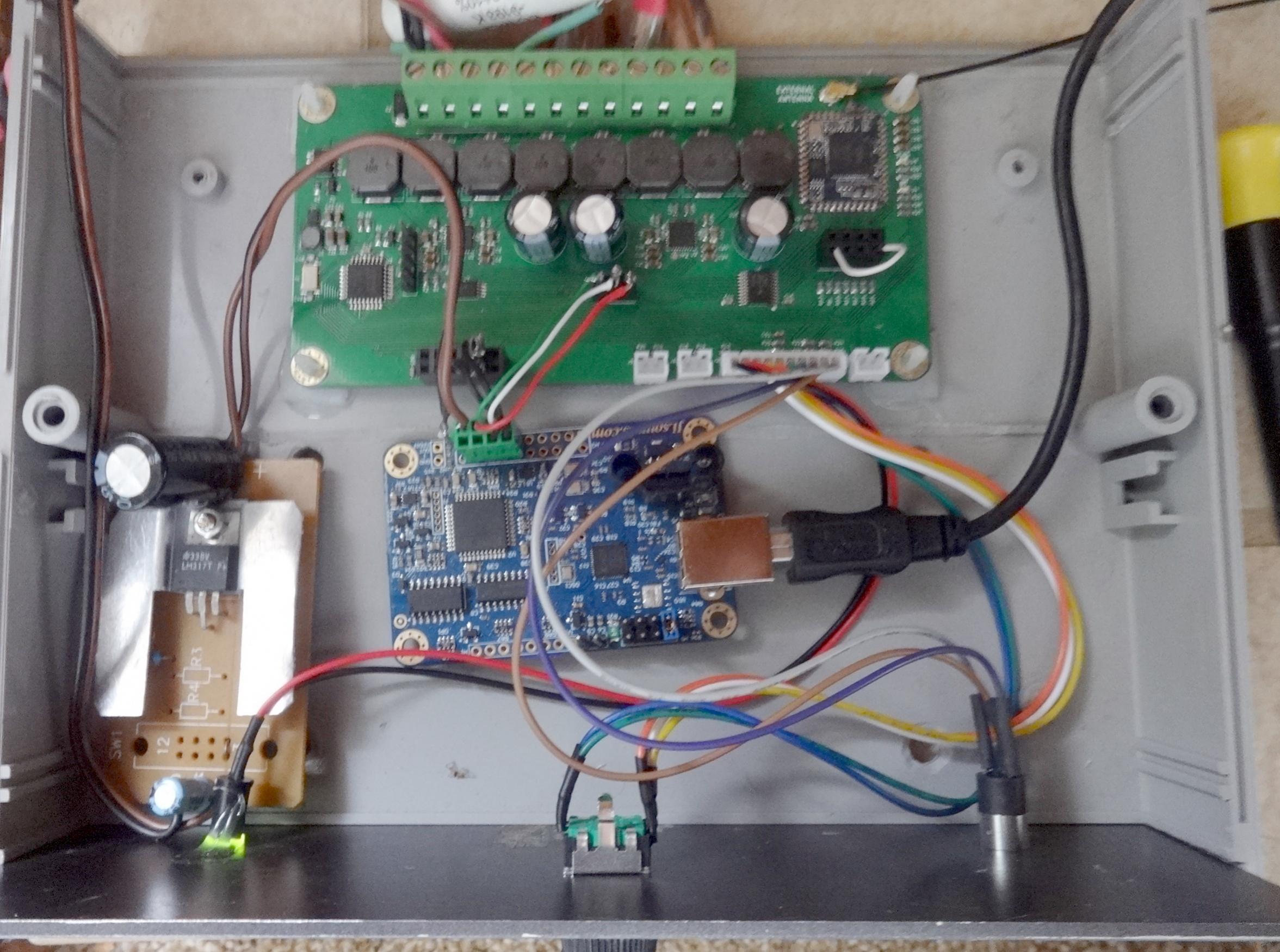

I added a JLSounds USB to I2S board, to my 1st Zoudio amp. It's a reasonably high end converter board, which I paid as much for as the Zoudio amp to get.
The 3 terminal regulator is to take advantage of it providing galvanic isolation from the USB side - preventing all those switching brick powered PC generated superfluous nastiness from getting into the I2S side. Which, along with the amp, is powered by all linear.
I just got it hooked up; havent even mounted the boards yet...Sounds absolutely marvelous! Xmas present to myself, as who in my world would even know I'd like to have a JLS USB to I2S board of all things?
This is just to document another USB to I2S board working with the V1 version. Here's to the probability of the V2 sounding just as good over BT 5.0 - with the galvanic isolation from the music source that connection provides ;')

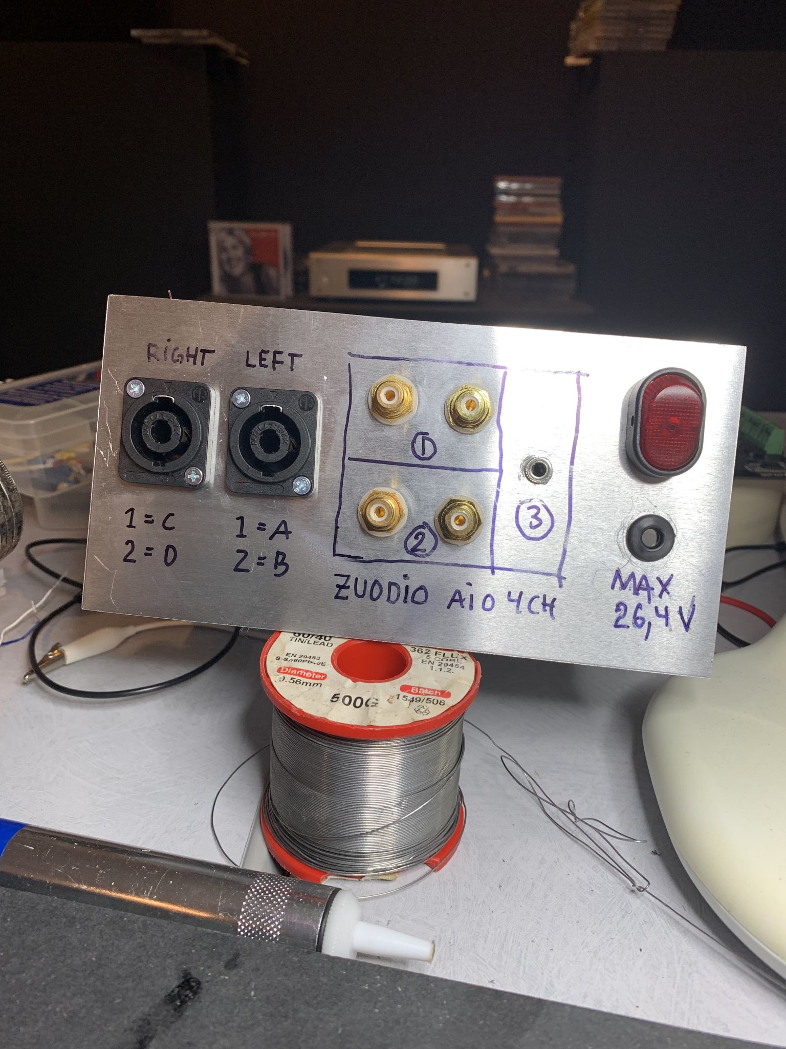

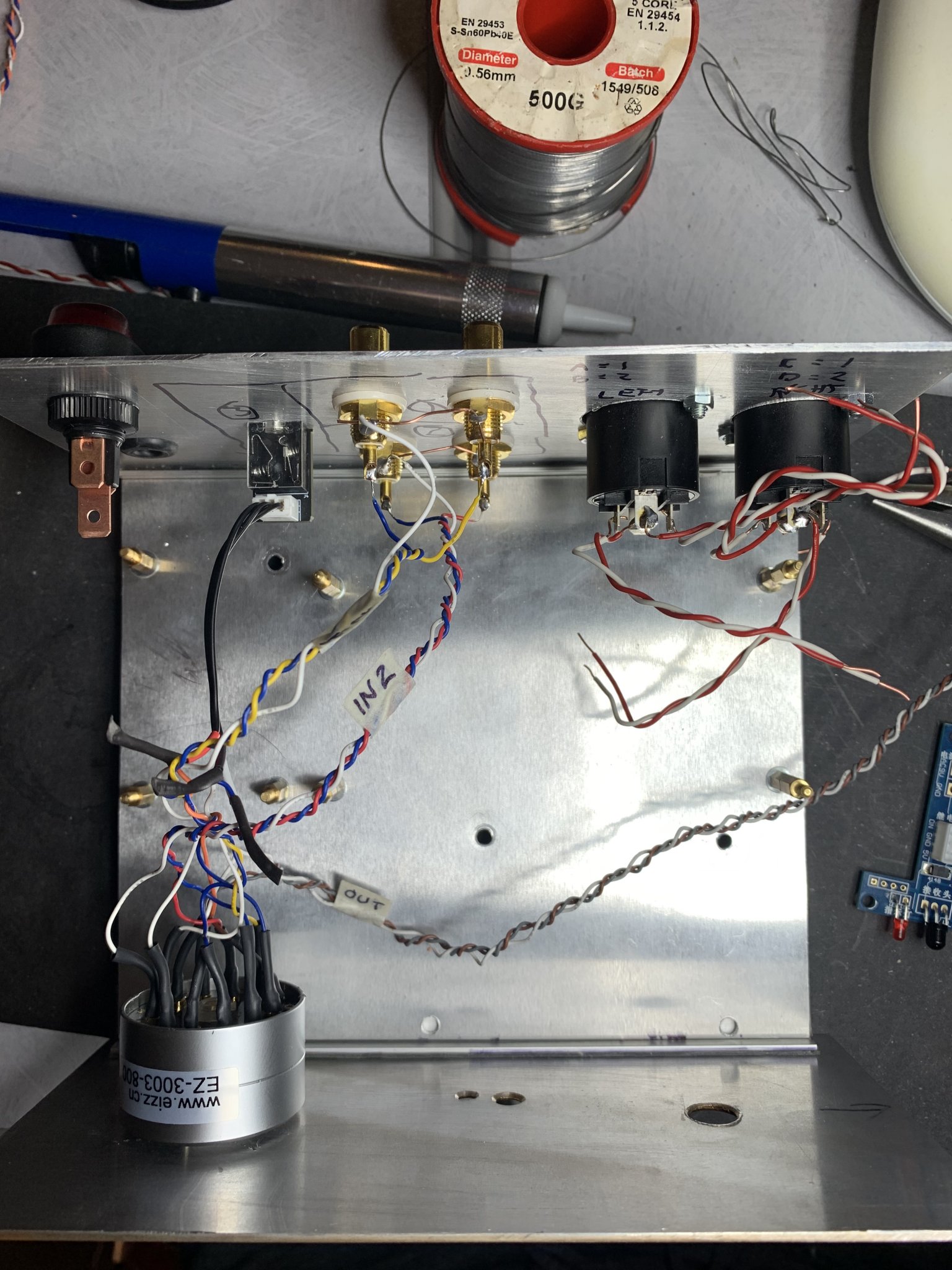

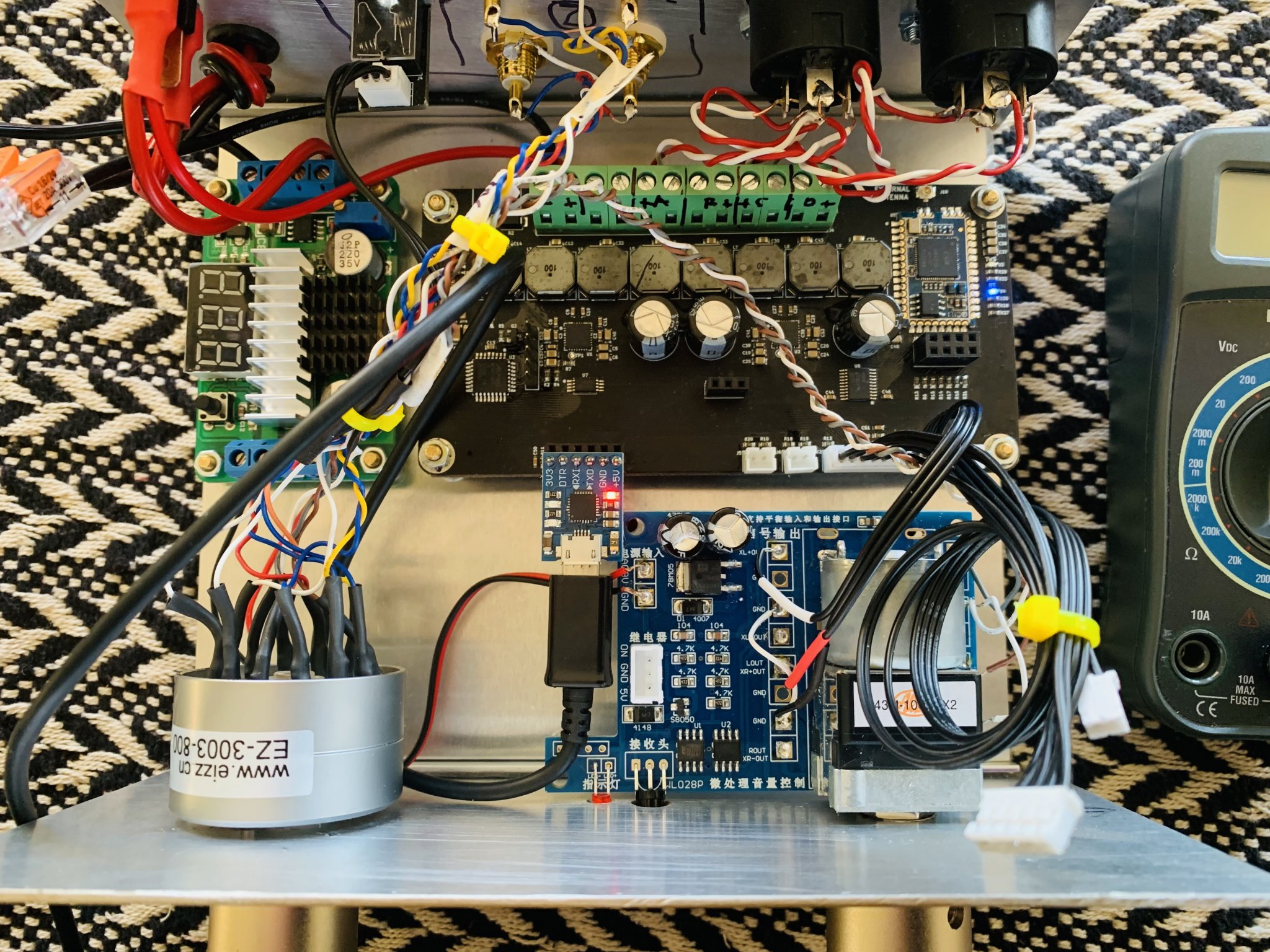

I used ZOUDIO aio4ch to power two satellites and a subwoofer. The subwoofer uses Channel 3 and 4 in combination. I was able to configure the system with mono input (the stereo firmware update was not available yet) and it worked like a charm! The bluetooth module was a convenient source for the signal and with some measurements and a couple of filters the whole setup sounded very nice.
The idea was to install the amplifier board with its 24V power supply in the back of the subwoofer. The volume should always stay at maximum because I wanted to control the volume from the source (smartphone or PC). I was not concerned about overheating because the specs of the board say it has a thermal protection.
The setup worked quite good for about two hours (enough time for several measurements and adjustments). After that it suddenly stopped to make any sound. The amplifier chip seemed to have burned through.
I returned the board and I got a replacement without trouble (thanks for that!). I thought the board must have hat a manufacturing error which ouccurs randomly. This is no big deal if it is replaced swiftly and without problems.
So after I got the replacement board I reinstalled the whole setup and again it worked flawlessly and sounded quite good. I measured and adjusted again for about 1:30h. After that the speakers suddenly failed. The error was not exactly the same as with the first board because the subwoofer was still working. But the second board seemed to have failed in a very similar way.
Again I got a replacement. I appreciate this very much! However after loosing two boards I wonder if the problem really was a random manufacturing error. What if the thermal protection is not working? Should I add some heatsinks to the amplifier chips? Could there be a wiring issue that destroys the board after running perfectly for more than an hour?
Before I wire up the new board I wanted to ask for your opinions on this topic. I think I made no mistake with the wiring (it worked after all) but maybe I'm missing something. I do not want to loose another amplifier...

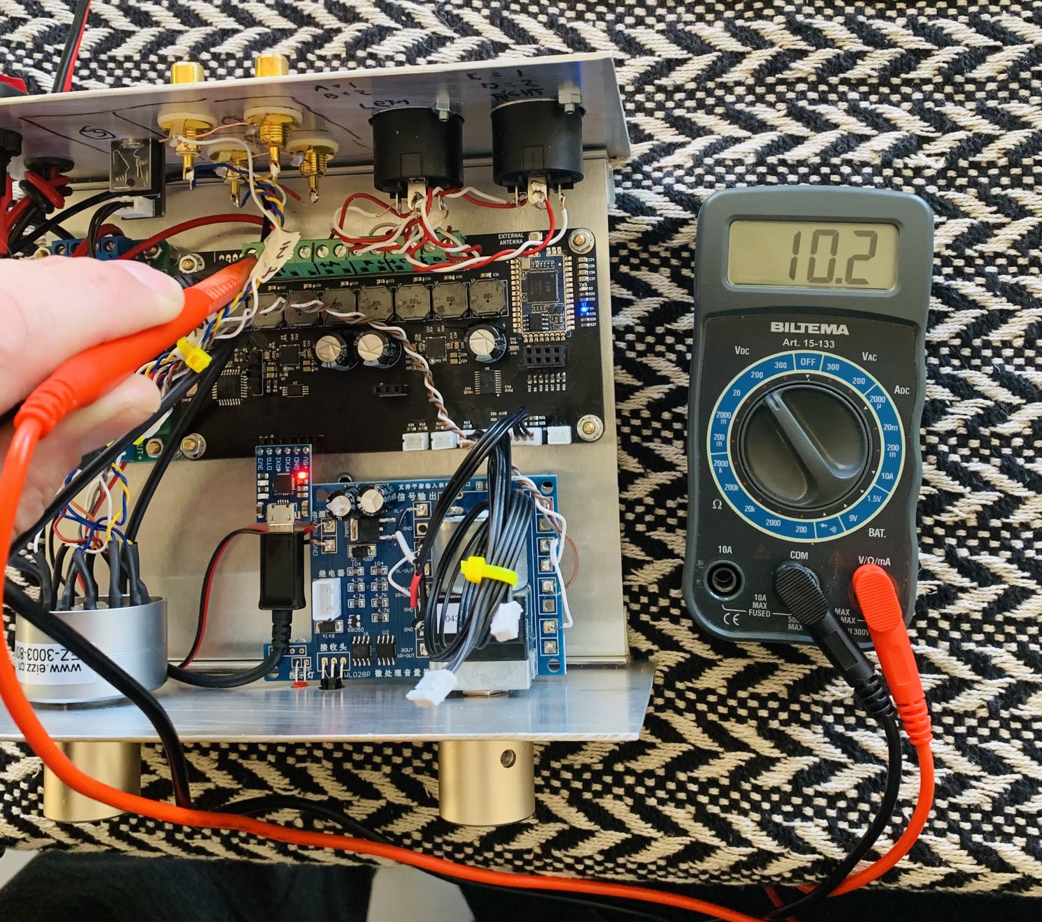

As you have said earlier, it is time to strip it back or disconnect as much as possible and verify thye are working in isolation.
Your PSU at 10V is an obvious clue to something being amiss. As ever maybe worth going over the earthing strategy. The board is on isolated standoffs I vaguely remember from building the kit?
The motorized volumpot was the problem. Isolated it by using a 9V battery. Now the amplifier board gets 20V :)
The original standofs was a metal screw with a plastic tube.
