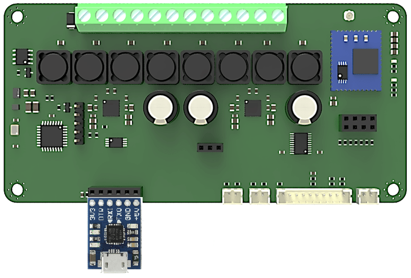

If you go to the zoudio website you can download the programming software which you can use with the small usb programming pcb which connects to the main pcb. Please see the attached image.
If you didn't buy the small programming interface pcb you should be able to contact them and order one

The connection on the picture is indeed the right one. The programmer is always included in the package by default.
