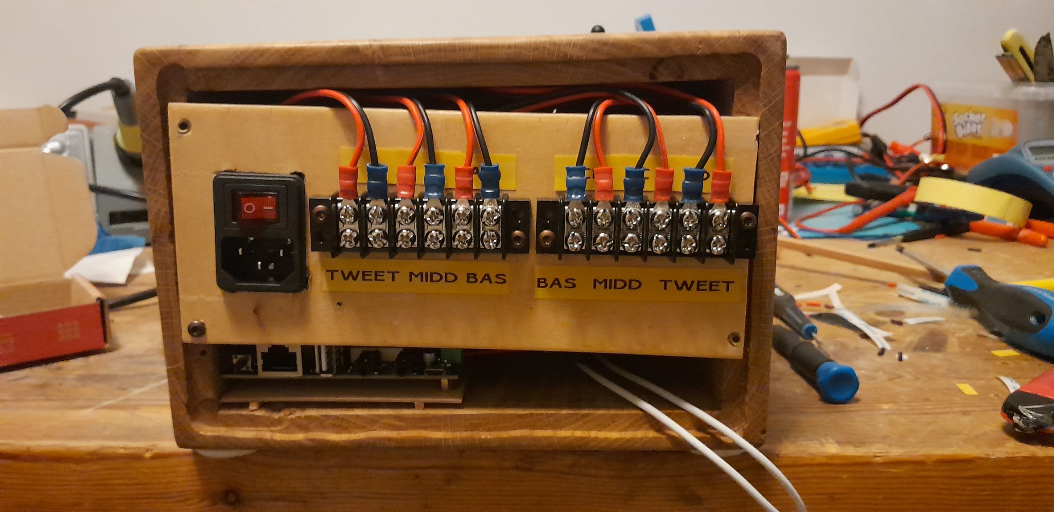

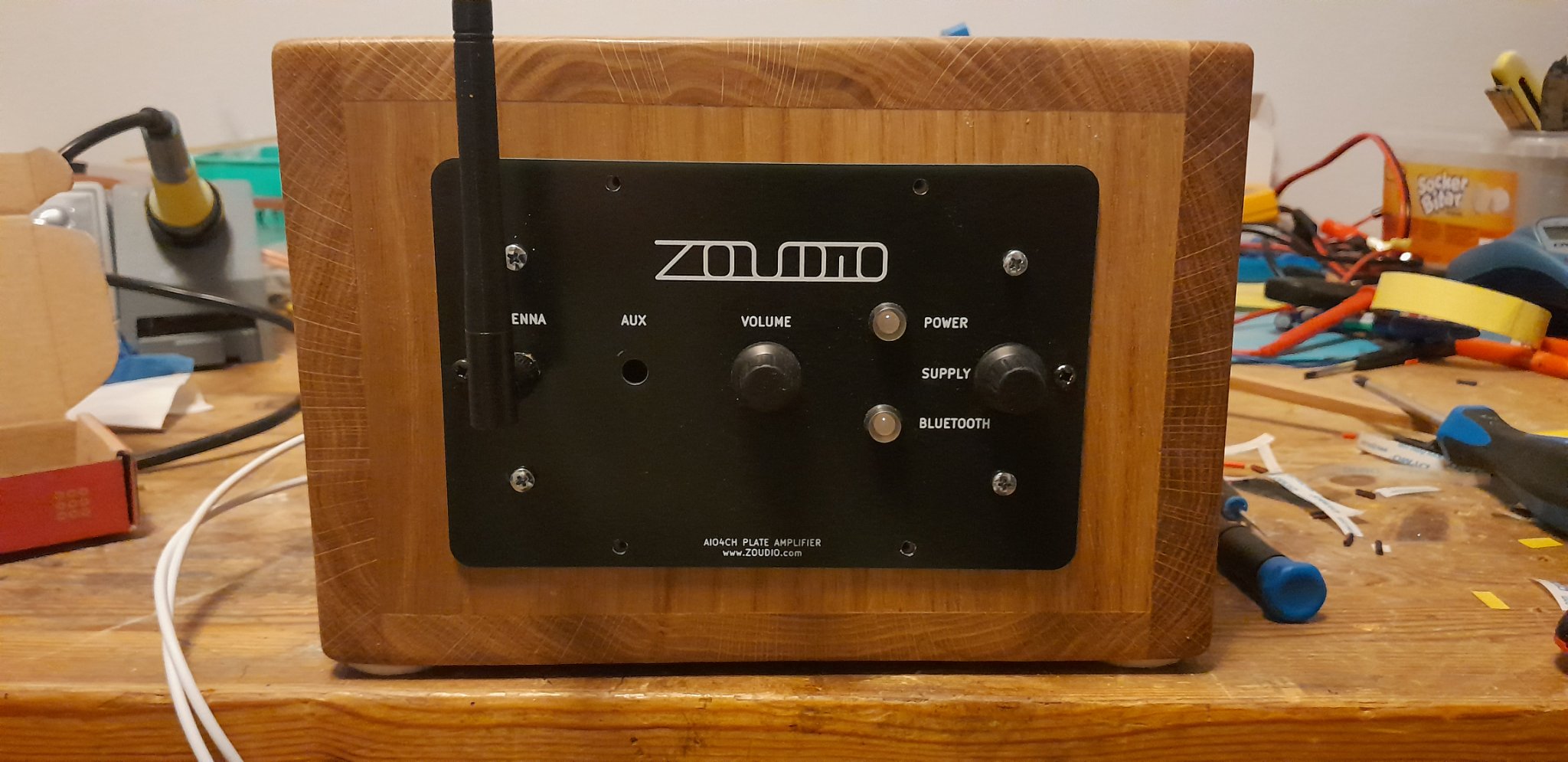

My Zoudio 2.0 are ready!
2x Zoudio 438:
Signal feed by a Up2Stream Pro via I2S, parallel into the two Zoudio. BT disabled on the Zoudio, WiFi for streaming Spotify and USB for Netflix etc to the Up2Stream.
Start up volume on the two cards are to match the subs with the midds, I can turn up the midd by 3dB and the subs by 6dB for disco mode 🙂
2x Zoudio 438:
- one in 4 channel mode for midds and tweets
- one in 2 channel mode for sub

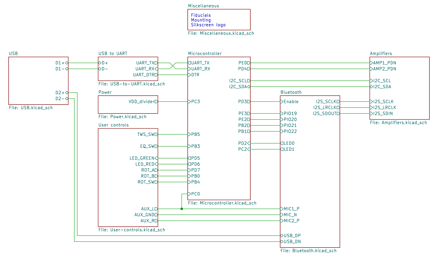

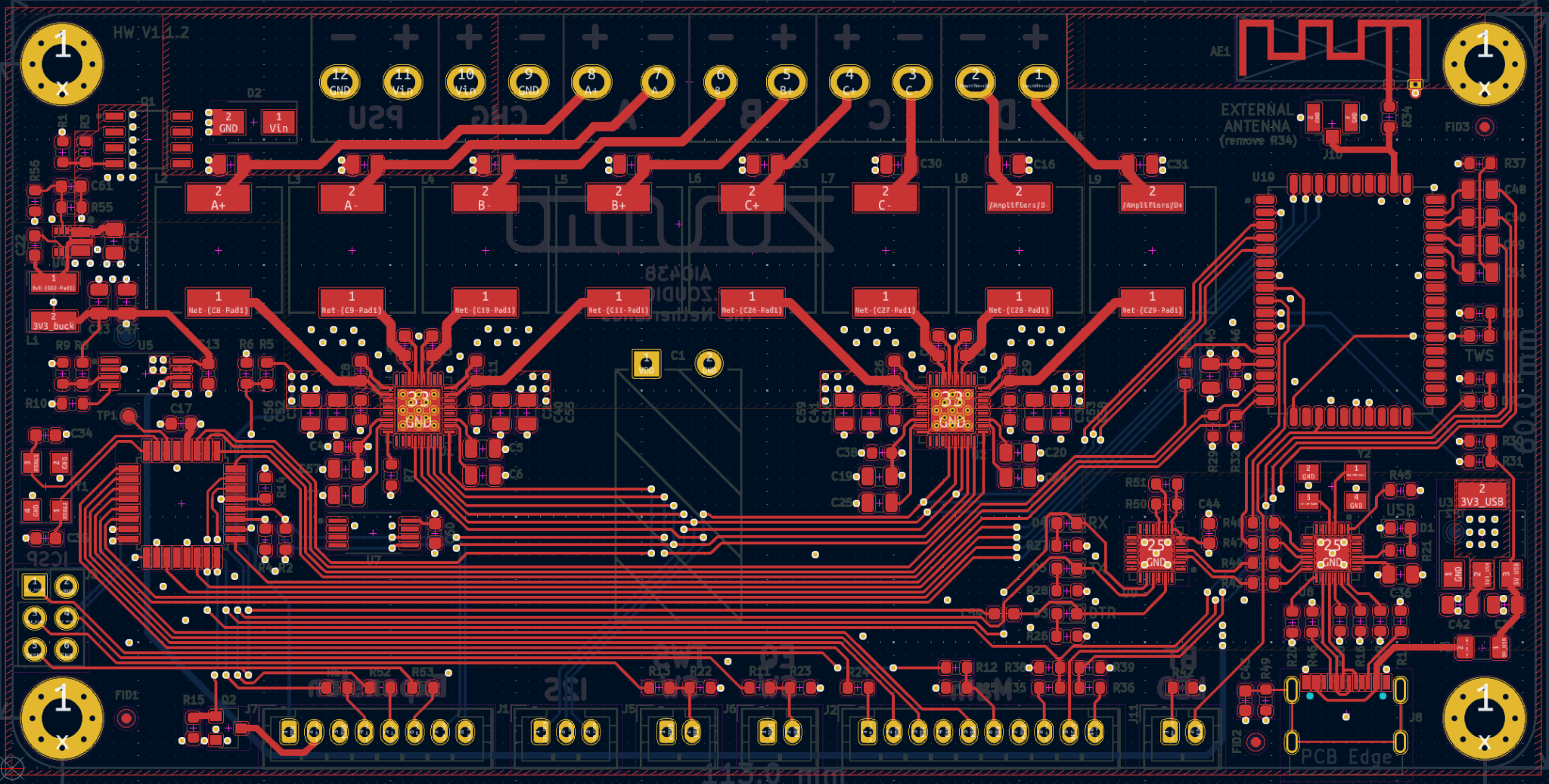

The Zoudio AIO438 design files are now available open-source
This includes the Kicad 6 source files, as well as production exports:
For anyone interested, feel free to re-use (parts of) the design for free.
Or let this be an inspiration for a new design 🙂
- Schematic PDF
- Gerber files
- Position file
- 3D STEP model
- Bill of Materials
