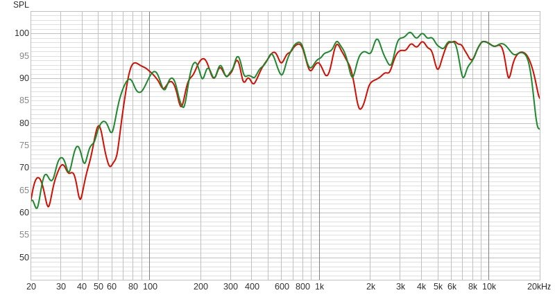

I wanted 4order filters for midd and tweeter. However, when I set 2 x 2nd order filters together will the cut of frequency change for the channel. I.e.it will be a gap between the middle and the tweeter.
Green are 2nd order at 2500hz and Q=0.71
Red are 2x 2nd order at 2500Hz and Q=0.71
With a 2nd order Q=0.71 filter (Butterworth), the mid and tweeter should be opposite polarity. Usually the tweeter is reversed.
When two 2nd order Q=0.71 filters are cascaded (put in series), the result is a 4th order Q=0.5 filter (Linkwitz-Riley). The mid and tweeter should have the same polarity.
Is it possible you do not have the correct polarity for one of the two examples you posted?
It is also important to understand that a 2nd order Butterworth filter has an inherent +3 dB bump at the crossover frequency, while the 4th order LR is inherently flat. So it is expected that you would see a frequency response difference between the two.
The dipp are to deep to be explained by phase interference (or opposite polarity). I have previously measured the my speaker and at 2500Hz do I have a tweeter delay of 0,2ms. With my previous DSP could I correct this. With Zoudio do I have to live with this phase shift or rebuild my speakers.

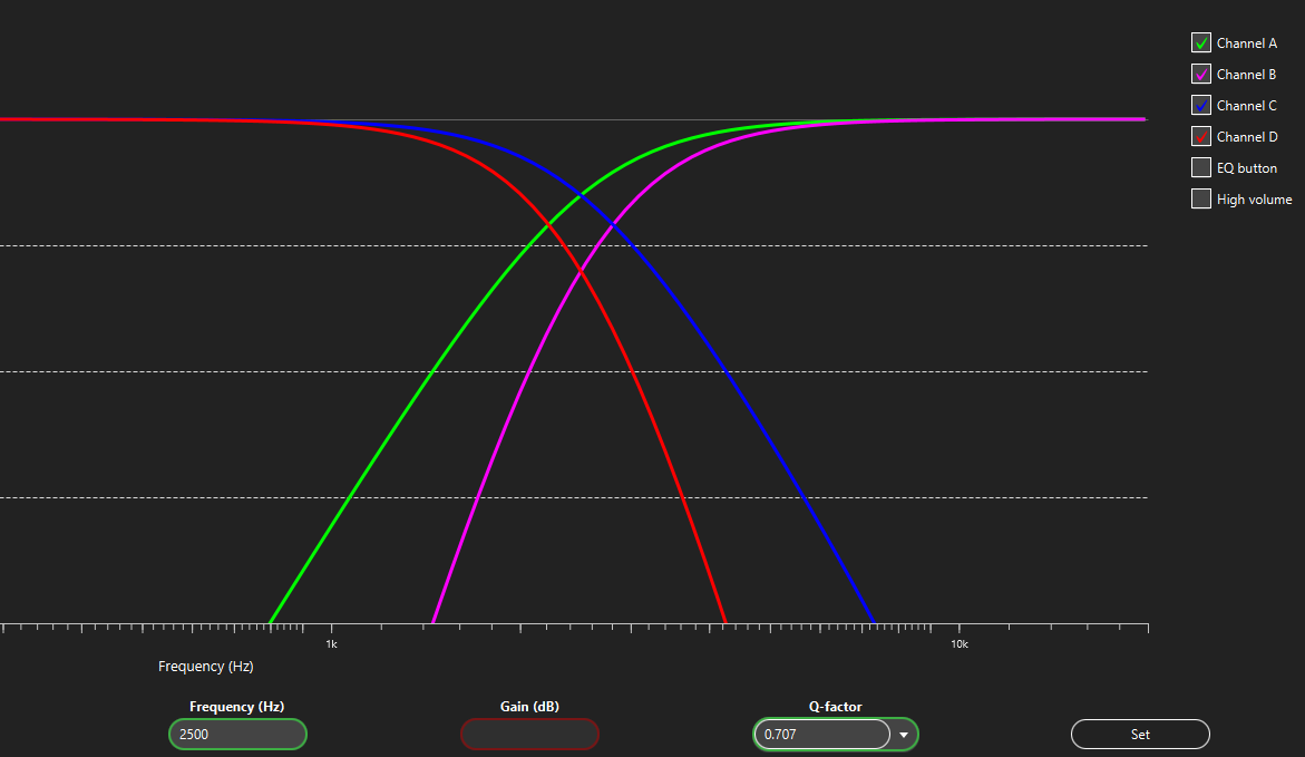

I played around the the config tool. I have set:
Blue: 2th order HP Q=0,707
Green: 2th order LP Q=0,707
Red: 2x 2th order HP Q=0,707
Pink: 2x 2th order LP Q=0,707
To have a flat curve should at any point:
Blue + Green = 0
Red + Pink = 0
in my attachment is it obvious that Blue + Green != Red + Pink at 2500Hz.
Either has I misunderstood that 2x 2th order = 4th order or the software in the DSP has a bug...
Currently have I dropped the ide of using 4th order filters. With 2th order do I get a flat response as 2500Hz.
