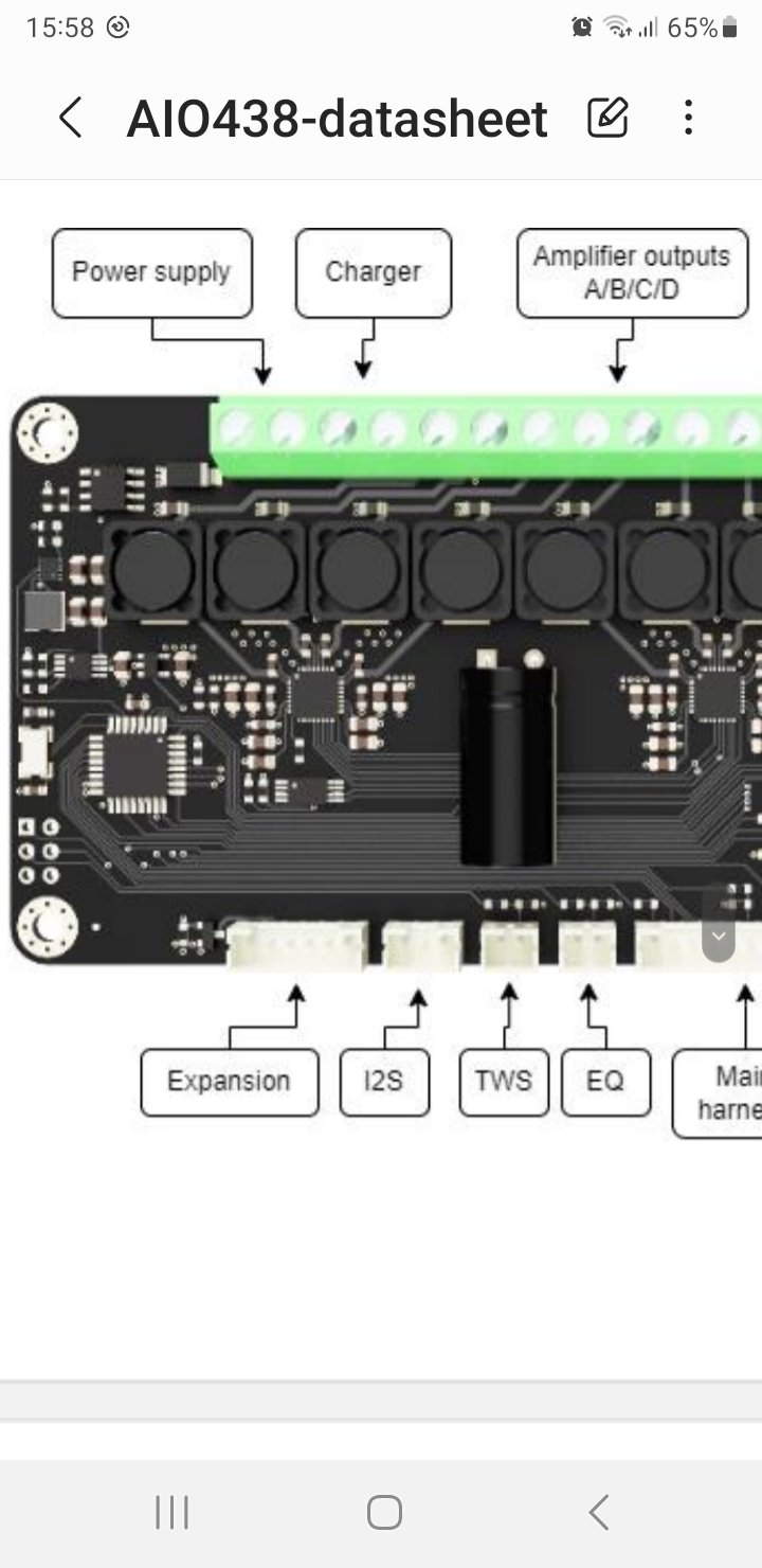

In the datasheet are there an I2S-port. Is it in or out?
If in, does it affekt the BT?
In out, where are the signal captured, before/ after DSP?
As I understand it, the I2S port feeds the two, two channel chip amps. Ordinarily it's connected to the BT receiver, which also does the analog input conversion to I2S. There's s jumper that disconnects the BT chip, leaving the I2S free to take on an external input. That's how I use mine. This is upstream of any DSP functionality, so the DSP works with either way of inputting a music signal.
I put a spst switch across the jumper pins. That way, if I want to play music from my phone, I can enable the BT input. If I want to listen through USB, I have a USB to I2S converter permanently connected to the I2S input pins. The simple switch effectively functions as an input select. This is with the AIO4CH model.
@PerCarlin The board takes analog in which feeds the QCC3031 BT module, which in turn feeds the two amplifiers. The I2S connector exposes the I2S bus between the BT module and the amplifiers. This can be used as output. As an input you would have to disable the BT module to avoid having two masters drive the bus at the same time. As this is more of an advanced / experimental feature, it's not covered in the normal documentation. I have some I2S usage instructions that I will send you by mail beginning of next week, when I will also ship your order.

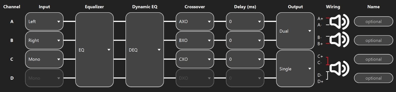

In the DSP can you set the input signal to Left, Right or Mono. Therefore can you set all input to Left vs Right per board.
However do I not know if you can mirror the BT to master/slave between the amps.
The easiest way are to use an external BT and feed both amps via Line-in. However can you not use the volume knob as the amps will not be synced. To solve this set the min/nominal/max to same value on both amps and control the level via the transmitting device.
A more interesting way are to use I2S out from one amp to I2S to the other, to avoid DA-AD conversion. It requires some more advances settings than what the GUI offers but can be done by set some parameters in the promt, ask Jesse for more details. Same issue with syncing volume-level as above.

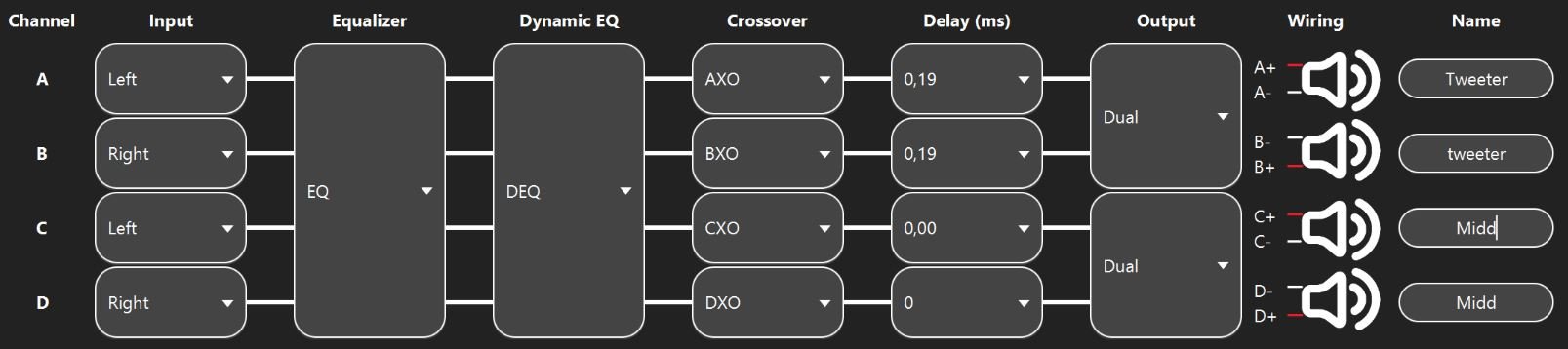

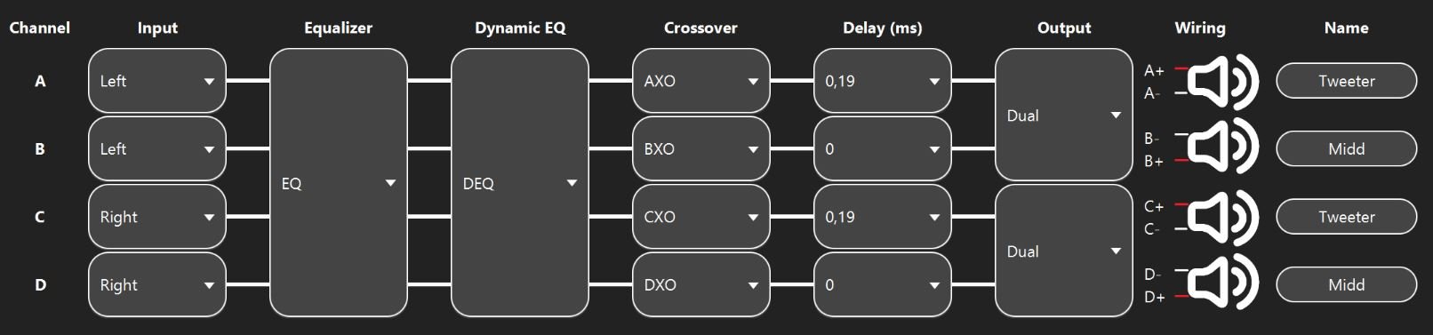

I have measured to acoustic distance between my tweeters and midds, they are separated with about 0.2s. Therefore would I like to have the tweeters delayed by 0,2 for perfect match at the XO-frequency.
Ideally would it look like
If it can not be a delay per channel. Can it be per chip? Would this setup solve the issue, would it initiate anything else unexpected?

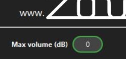

Are there any margin in the headroom to prevent digital clipping?
In other words:
I have a bas-shelf of 12dB to squize the last bottom on my elements.
What should I use as max in "max Volume" to aviod digital clipping?
In other words:
Has anyone found a suitable I2S device that works with this amp? It seems hard to find one that works in I2S master mode at 44.1/48 kHz
@PerCarlin I'm unsure if that setting affects digital clipping. I think you need to set a gain to -12dB to compensate for your boost.
