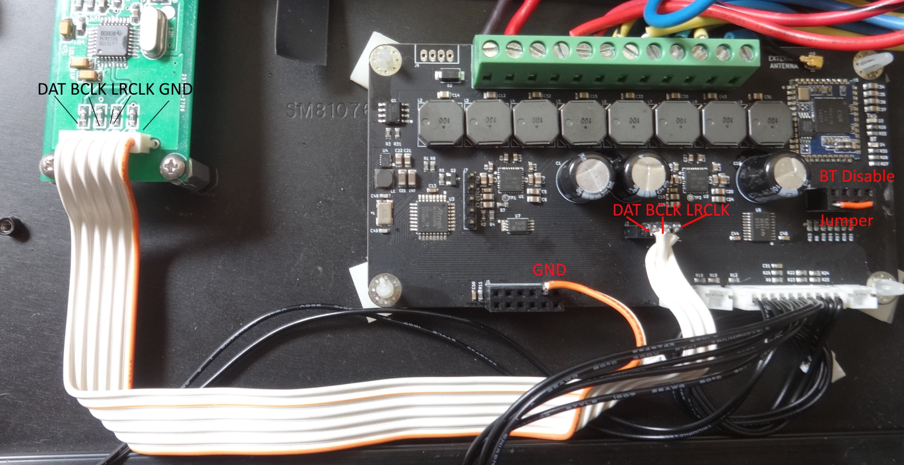

I successfully wired up a USB to I2S converter to my AIO4CH. Here's a picture showing the connections - while playing, of course! It's an ebay / aliex PCM2706 board, works for the 44.1 / 48 k stuff. Works using my W10 PC laptop and my rPi 3B running PiCorePlayer.
Oh, it allows me to plug the amp into my laptop, or Raspberry Pi, directly instead of using BT. BT worked no problem on both those "player" platforms, I just wanted to try a direct wired connection. I think it sounds slightly better, but who knows - could be just my imagination ;')
No, I'm talking about digital in via the i2s vs the bluetooth module.
I have not experienced a single BT receiver that's been completely glitch-free during playback. If you pay attention you can hear it on just about any BT device, not a like it's very frequent.
I am more sensitive to the time delay, there's also quite a lot of buffering so it's not the best to use when watching a movie or playing a game.
But other than that I guess in the debate of jack vs BT... It's a toss. If you have a noisy source then BT is better because of the isolation. If you have a good quality source with low noise then my vote goes to jack because of lower delay.
