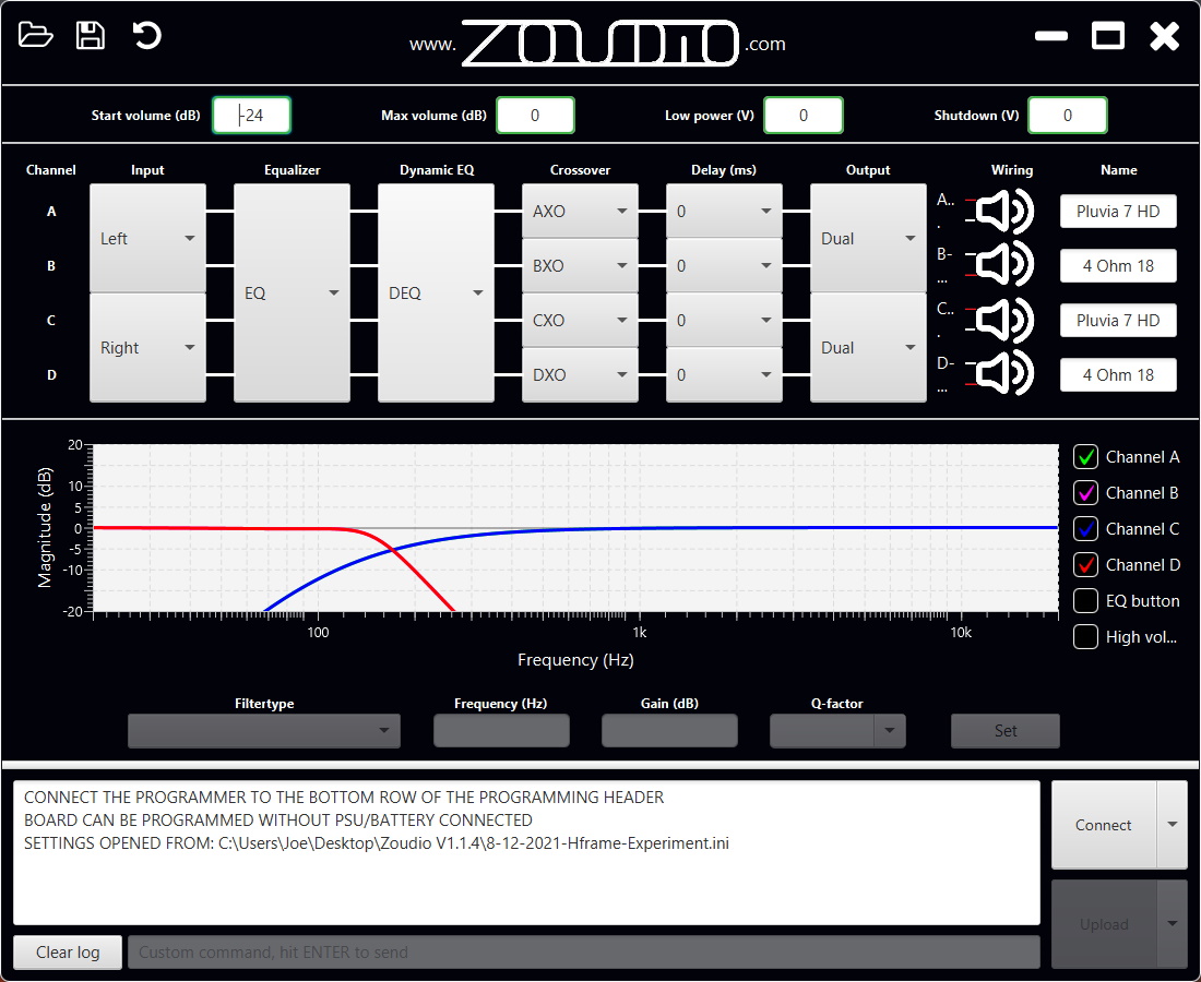

I am wondering about the function of the EQ button. Does it immediately change between 2 DSP configurations or only after reboot?
I would like to use it to switch between 2 different filter/crossover settings. This would be a nice feature.

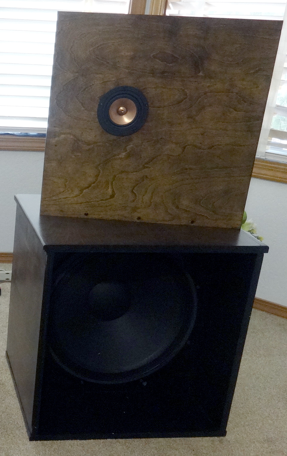

4 channels happily pushing a pair of these! Running off a pair of 12V lead acid 7-9AH batteries, starting at 25V full charge. After a few hours listening, dropped a whole 0.25V. No hum, noise, ground to the house wiring - it's fully floating, as I'm using the BT from my W10 laptop PC. Spec for the TAS chip (all of them) says 30V absolute max, I assume beyond which the little silicon crystals inside crack due to voltage stress. I'm running so low power, I'm not worried at all about burning anything starting out a volt over 24 -
One aspect of the OBs is that I can be listening at a comfortable level - with a kid sleeping in the room across the hall. Leave my bedroom and nothing in terms of far field sound propagation.

@walterhw
EQ changes instantly
