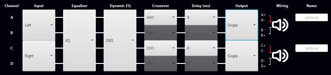

I'm thinking your amplifier might be a good option to try for the bass section of an open baffle project. I've downloaded the config tool and it's easy to use and offers some good options but I have some questions.
If the amplifier is configured as per the attached image;
  • The diagram isn't entirely clear but I guess I would connect the loudspeaker units across A+/B+ and C+/D+?
  • If I have the previous point correct, does it imply that I would only be using half of each amplifier chip or are A-/B- and C-/D- 'bridged'?
  • What max. power output would the pictured configuration deliver, assuming a 24V supply and 8ohm loudspeaker units?

@nautibuoy
As seen on the pictureis indeed how it should be connected.
Its called a PBTL setup, and its different from bridging, because the amp is already brigded internally.
This allows the amp to deliver twice the current in the speaker, so it will only give you more output if you put another speaker parallel or use another type of speaker with half the impedance.
