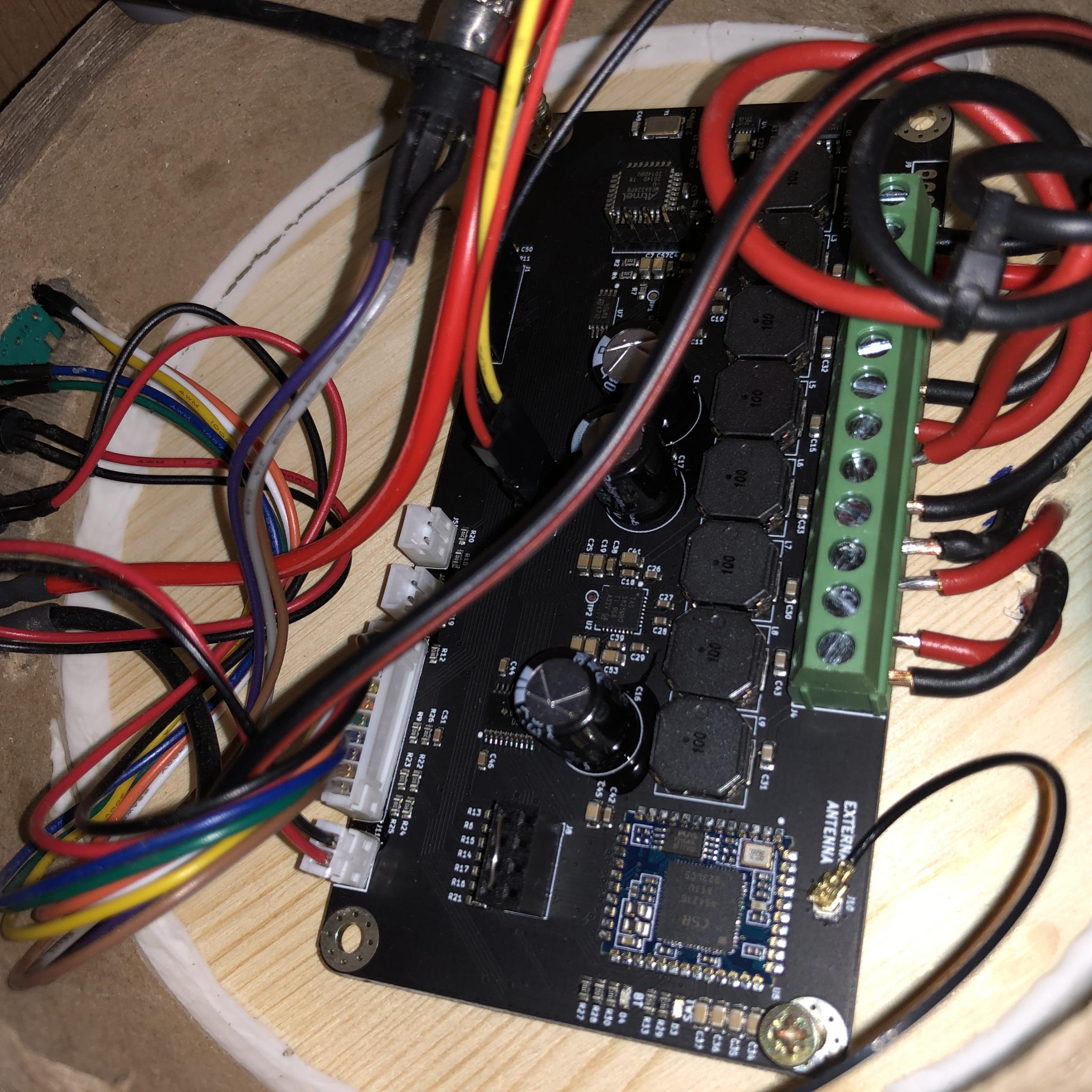

Hi lutkeveld,
your amp looks like a really nice and highly integrated solution e.g. for two-way active speakers.
I have 2 questions:
- Is the amp EMI/EMC certified? Because I couldn't find any ferrite beads etc. on the board which are usually used to get control over high frequency radiation.
- more a question of interest: is that business even profitable due to expected low quantity of sold amp boards and high license fees for bluetooth?

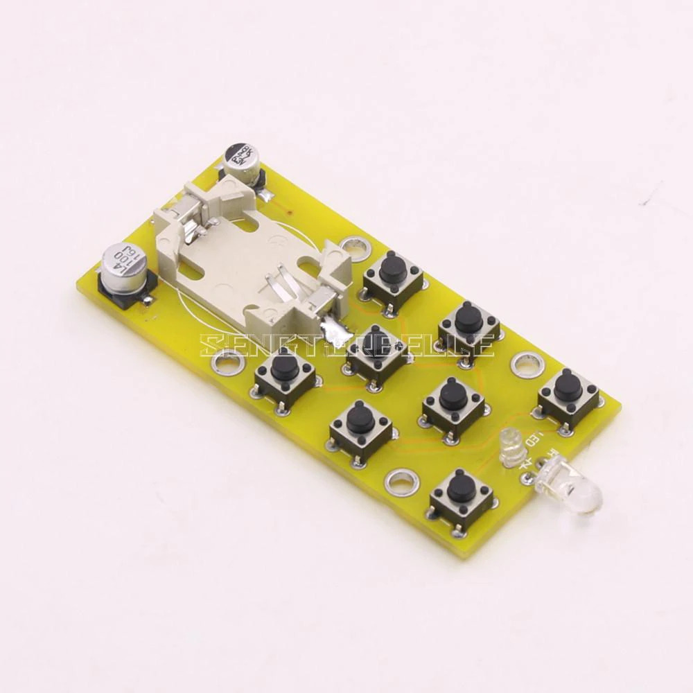

Nice looking tiny universal remote.
A bit pricey though. Also these type of buttons are not very reliable in the long run but costs just a few cents and easy to replace and available everywhere.
The Chinese dac makers usually choose apple remote control as IR standard.

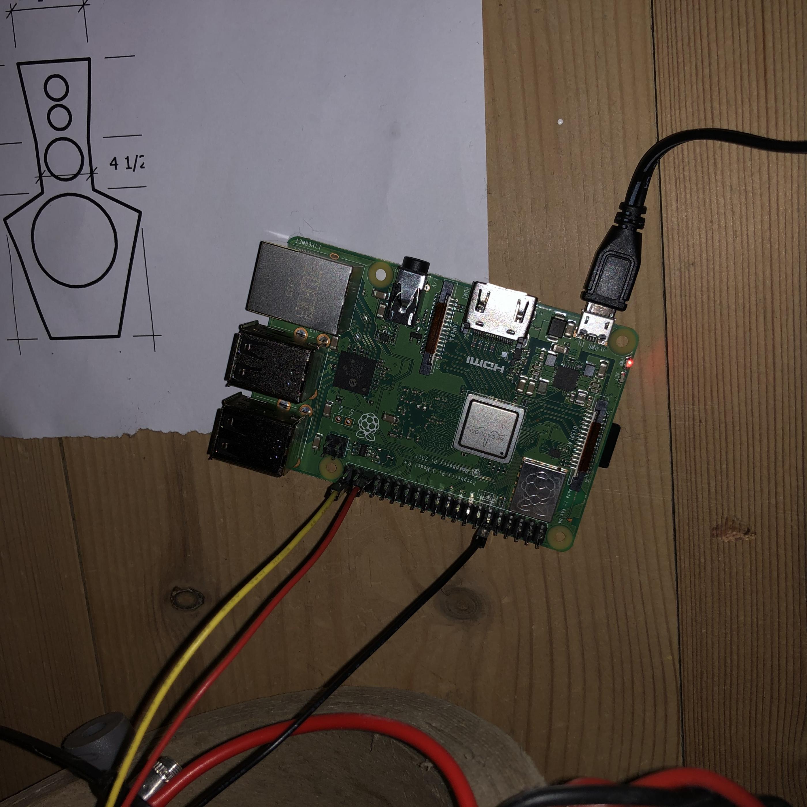

Has anybody successfully connected a Raspberry Pi to the Zoudio board, bypassing the Bluetooth via I2S? The Raspberry Pi has these 4 pins available on the GPIO connector for I2S communication:
18 PCM_CLK - clock
19 PCM_FS - LR Clock (also sometimes called WS Clock)
20 PCM_DIN - Data Out from a microphone into the Pi - this will not be used I imagine!
21 PCM_DOUT - Data out from Pi, into amplifier
I know the signal leads would have to be very short and twisted together as I2S is a chip-to-chip communication standard and not board-to-board/consumer.
I'm using moOde as the Raspberry Pi audio streaming platform, and 'driver' choices for the I2S out at the very least can configure the I2S for left-justified or right-justified, based on what the Zoudio board expects - so there's some flexibility there.
Just wanted to check if anybody has done this, as that is my intended application - using a Raspberry Pi as a streamer like I'm currently doing with my Squeezebox/Squeezelite ecosystem.
Best,
Tal

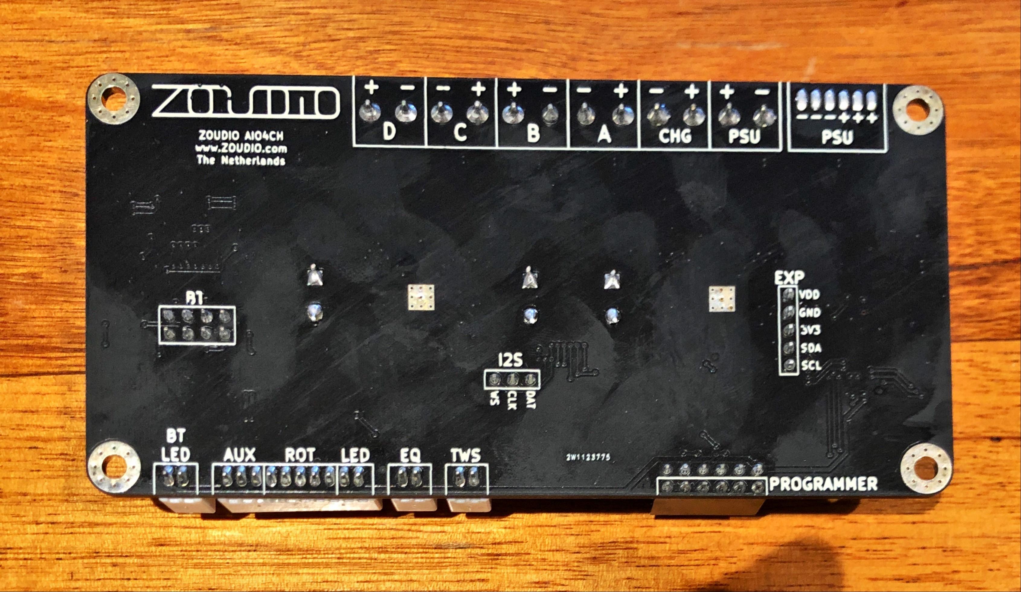

The rear of the Zoudio board shows the three I2S pins. I’m not sure if this I2S is connected to the CSRA64215 Bluetooth chip or whether it is connected to the TI TAS5825M amplifier chip which has an I2S connection between both chips. As I understand I2S is addressable so it could be the amp but could be either. Jesse would be able to answer.
The TAS5825M is adaptive to the clock rate and only need 3 lines so it could be the amp.

The board is currently self-certified. The most problematic part for EMC is the class-d output circuitry. The layout and bill of materials around the TAS5825M section is an almost 1:1 duplicate of the Texas Instrument evaluation board, which passes EMC testing easily. Also all components and assembly practices are RoHS certified.

Multiple people have used the I2S input with success. You can send an email to info@zoudio.com if you want the I2S hook-up instructions.
Rigged up an RPI3 with Moodeaudio, blocked out bluetooth with a jumper on J8, and connected the I2S per your advise. I tried 3 different I2S setups in Moode, generic 1+2 and HifiBerrry but I only got slight crackle on the speakers, no audio. There are just too many I2S settings in Moode to try out individually.
But would have been a nice solution to get hires audio, USB playing, Airplay, Spotify connect and Squeezebox. For now it looks like a I2S/Sdif converter is the best bet.
I have come to the conclusion that rpi needs a hat for i2s, as the clock doesn’t match any of the standards.
Your planned set up is the way to go for lossless streaming, but my advice is to go ahead with the two Zoudio in tws now, and work on the sound. You will spend a lot of time tuning your speakers to your liking, this is the fun part. Remember it is an iterative process inching towards your sound. You should save each iteration separate allowing you to revisit a setting.
In the meantime work on getting the other hardware. Please share your findings, I think we are many who believe this amp deserves the best source material.
