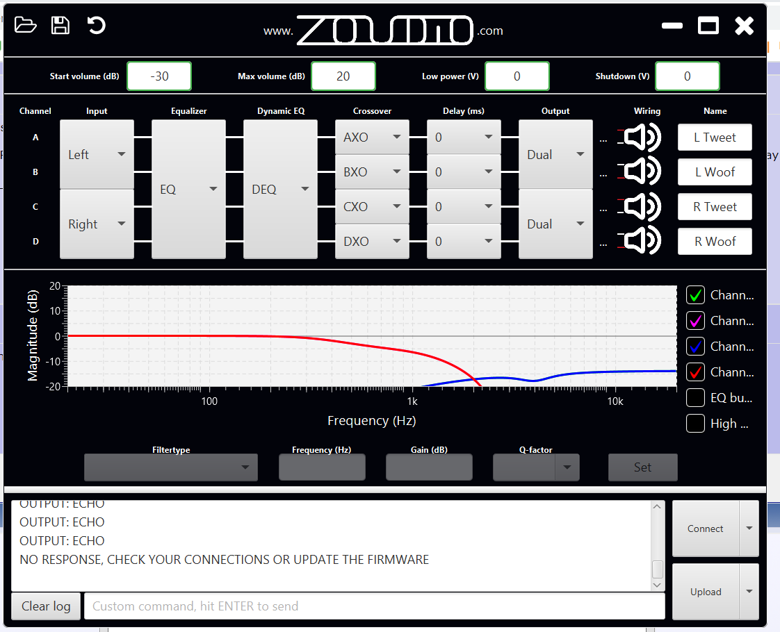

Trying to upload the crossover. Got the following error message "NO RESPONSE, CHECK YOUR CONNECTIONS OR UPDATE THE FIRMWARE". There is green LED from the board. PSU not connected. USB to COM3 Bridge shows up as a device. Need new firmware? Board corrupt?

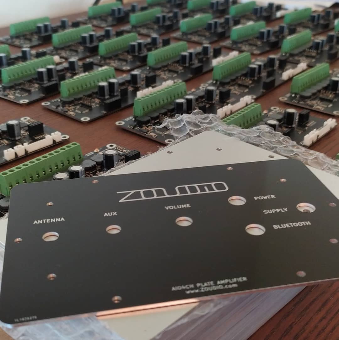

There is new stock of the AIO4CH and the plate amp extension kit!
New orders now ship out within 10 days.

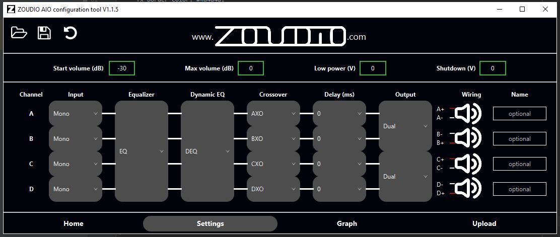

I attached a preview of the new GUI. Besides the functional improvements, I am experimenting with some visual improvements, any feedback is welcome 🙂

Just want to say thank you for great customer service that Zoudio has. My board didn't work. Jesse tried to debug it via remote desktop. We couldn't solve it so he sent our a replacement board free of charge and postage. DHL & USPS took about 45 days to deliver the package. I was able to get it working and it sounds great! I think better than 3eaudio 4-channel amp & DSP cards which I also have.
Again, thank you!!!
