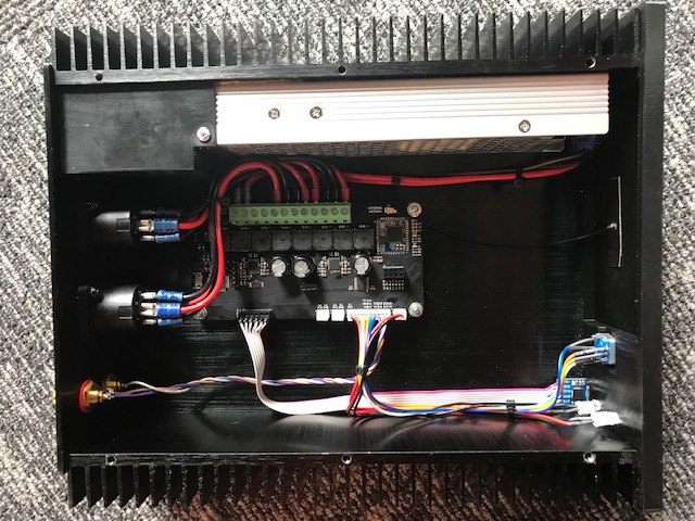

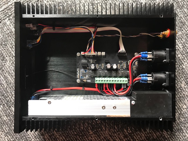

The build...

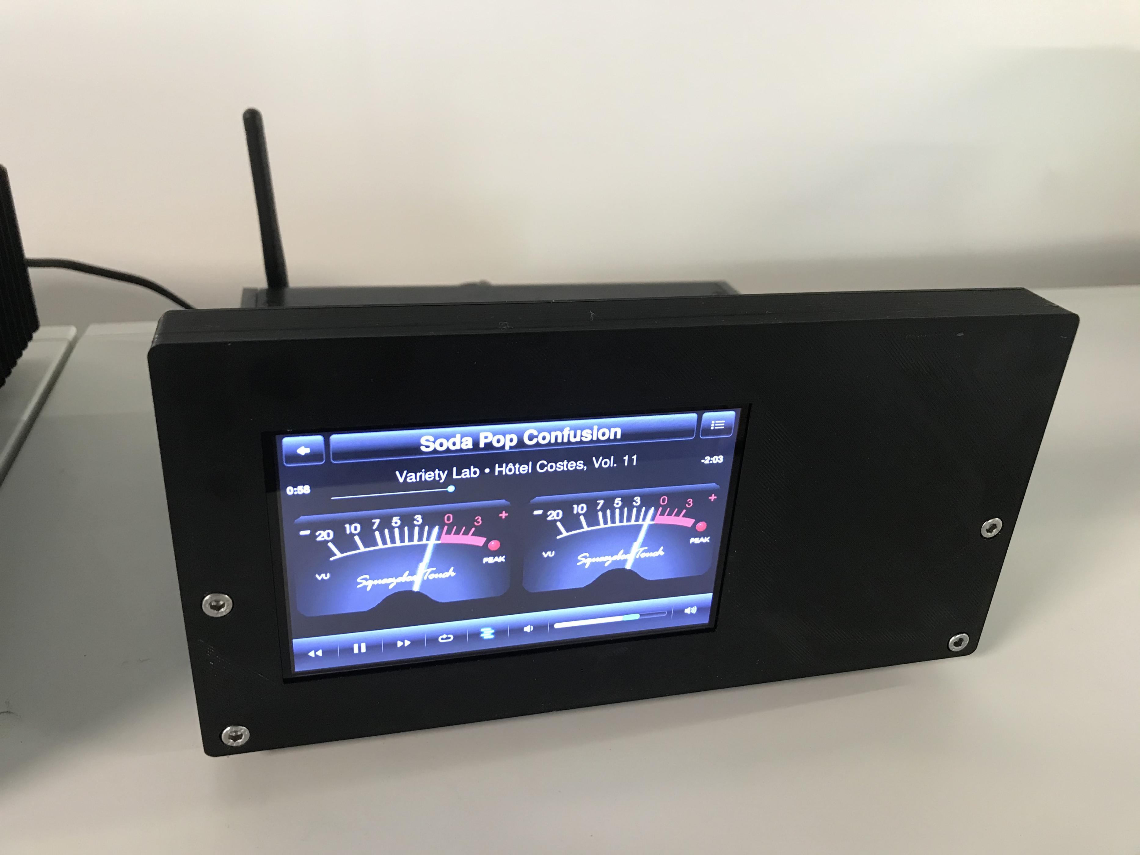

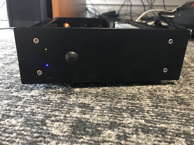

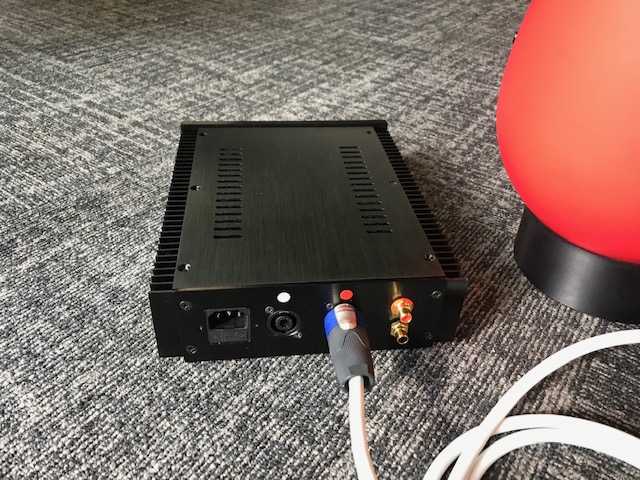

Still not sure about the front panel yet. The Douk audio case came with a 8mm thick silver anodised ali one. I have 3D printed this one to test the layout.
As you can see I have remotely mounted the programming header so that it is accessible via the front panel. The LEDs have been recessed which makes them look a little more sleek in my mind. The PSU is a Mean Well UHP-200-24 dialed in at 26V which is pretty much its max and just under that of the chipamps. There is also a 3D printed finger guard around the incomming mains connections.
Now I just need to get to grips with the SW and tuning it all to run the eggs.

Thanks. The case is nice and compact but still has plenty of space. I got it after I found the PSU would fit and that it matches the DAC case Douk Audio also sell into which I have built a PiCorePlayer. Not sure yet but there is enough space to integrate the two together in one case I guess with the Pi > I2C reclocker > Zoudio

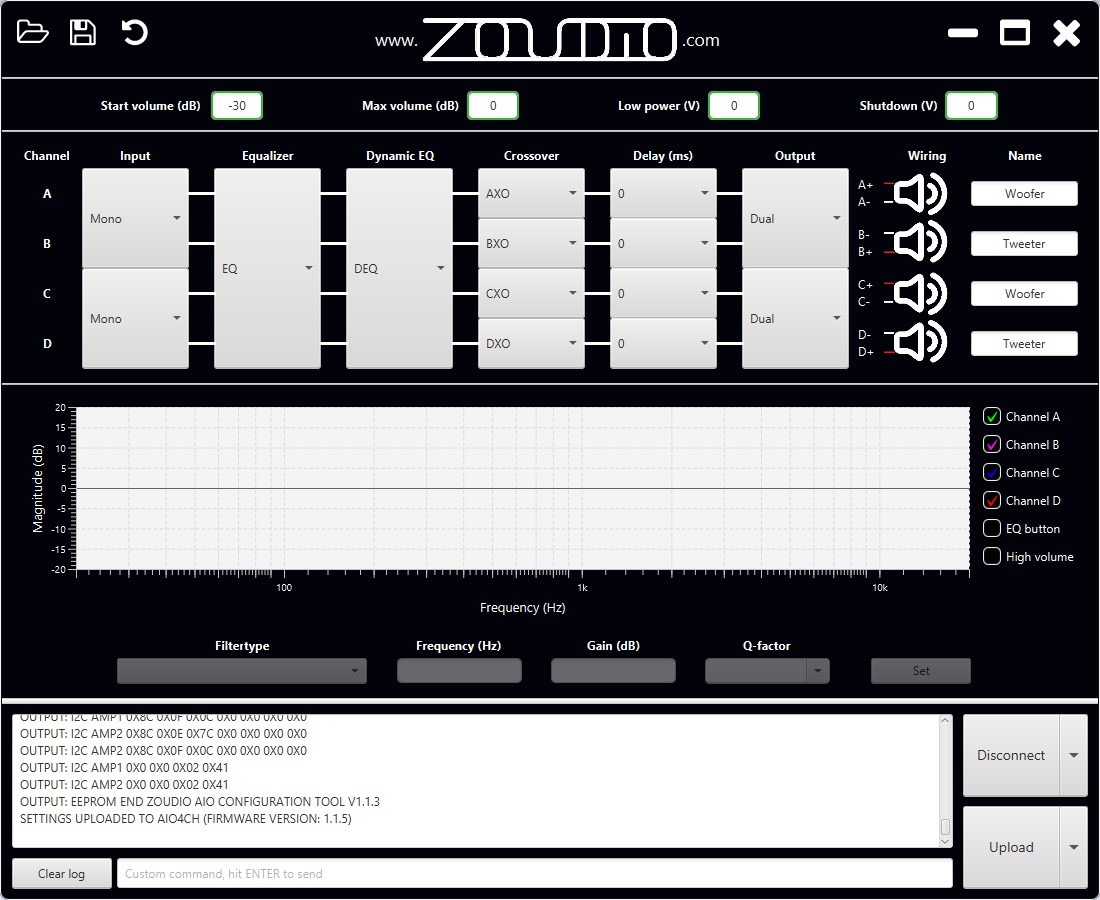

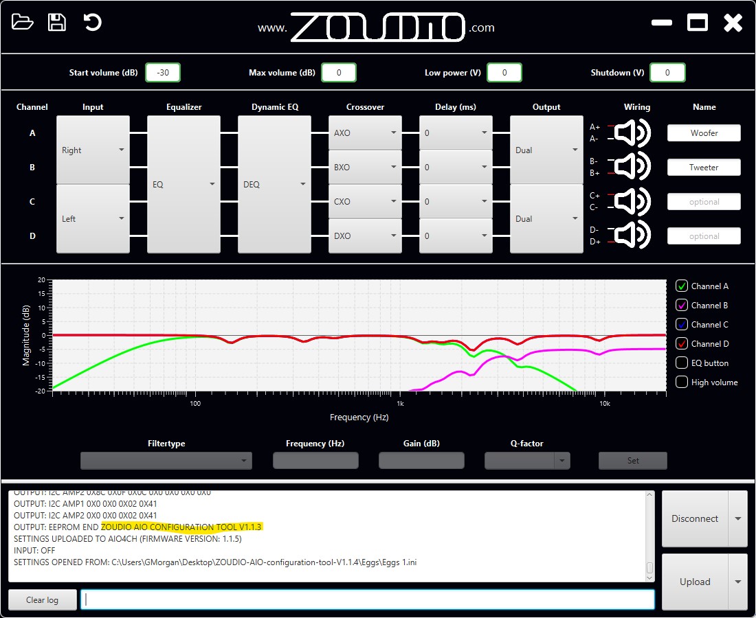

Anyways back to the software. Some of it is definatley finding my way around it but at the same time there are also some funnies going on. My initial comments were based on my first play. However after restarting the program it started to behave.
Yesterday I completely lost the B trace and it only came back after a program restart. Also traces C/D showed as completly flat even though there were EQ setttings applied. I think it is the screen feedback and funnies that are confusing me at the moment.
The attached screen grab shows what I'm currently playing with together with a ZIPed .ini file.
I'm using V1.1.4 but in the log window it says V1.1.3?

The B trace is only not displayed when you select output AB as single. Otherwise it should always be active.
C and D seem to match your settings right?
Yes I did not update the internal version number by accident. V1.1.3 and V1.1.4 are different, but they report the same version number when uploading.
