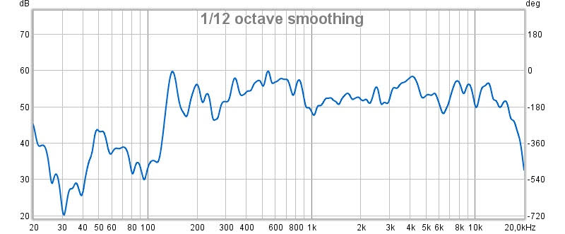

Build still in progress but already really happy about your amp!
Components:
- 2 x Dayton DSA 90 fullrange in a 4l cabinet - reflex tuned ~65hz
- Zoudio 4 channels in use - each drive separately
General EQ at 5-8kHz with 5 db boost to compensate lacking original driver response
Lower drivers second level lowpass at 800hz, upper drivers full range.
Measurement done before reflex tuning, that's why lower end is lacking.
I think the price/performance ratio is excellent, it's really easy to test and adjust this kind of DIY projects instead of using old-school passive components.
A proposal - you could maybe invest in a ready made box as accessory. Not that there's anything wrong with the cardboard box 😀

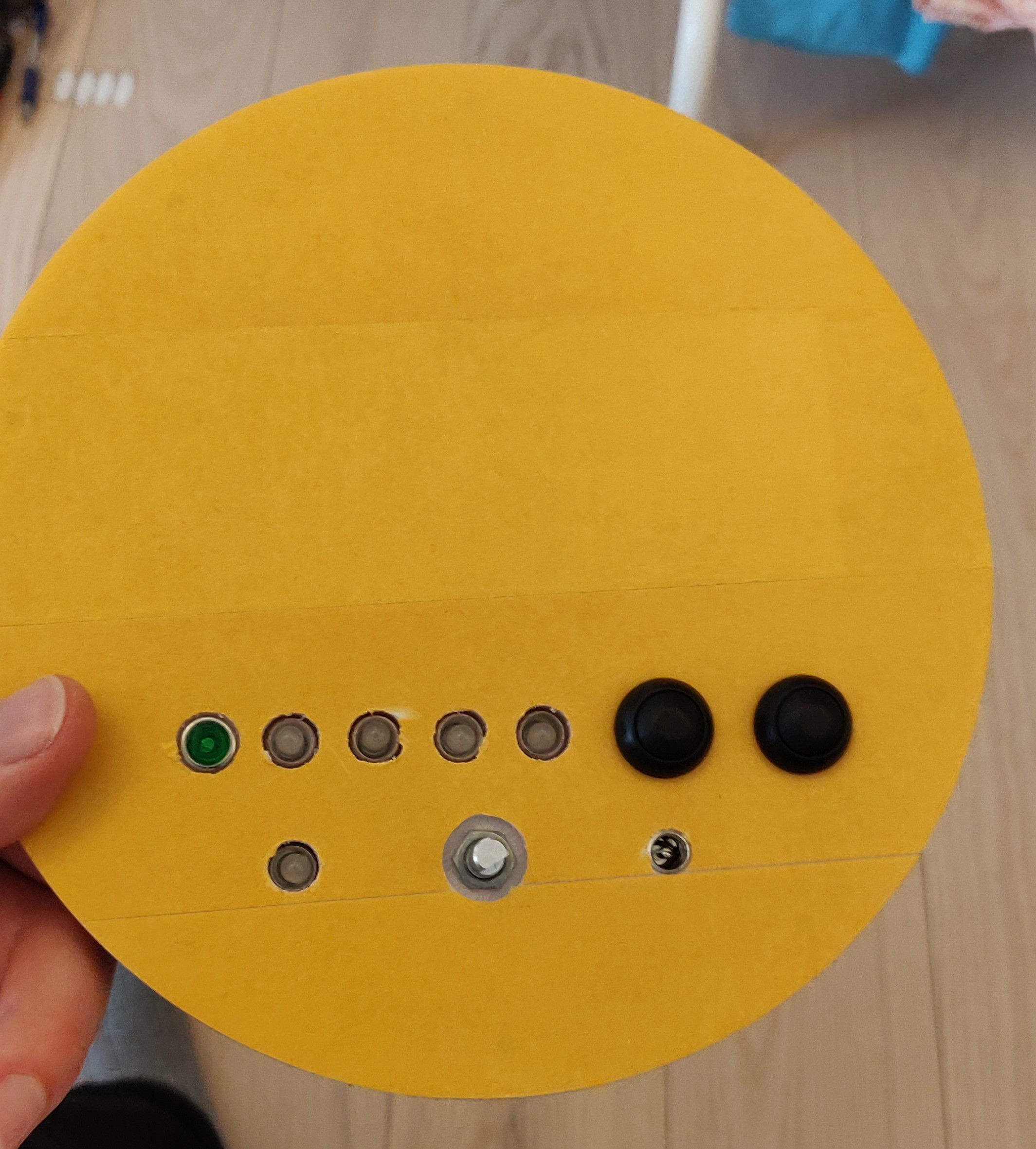

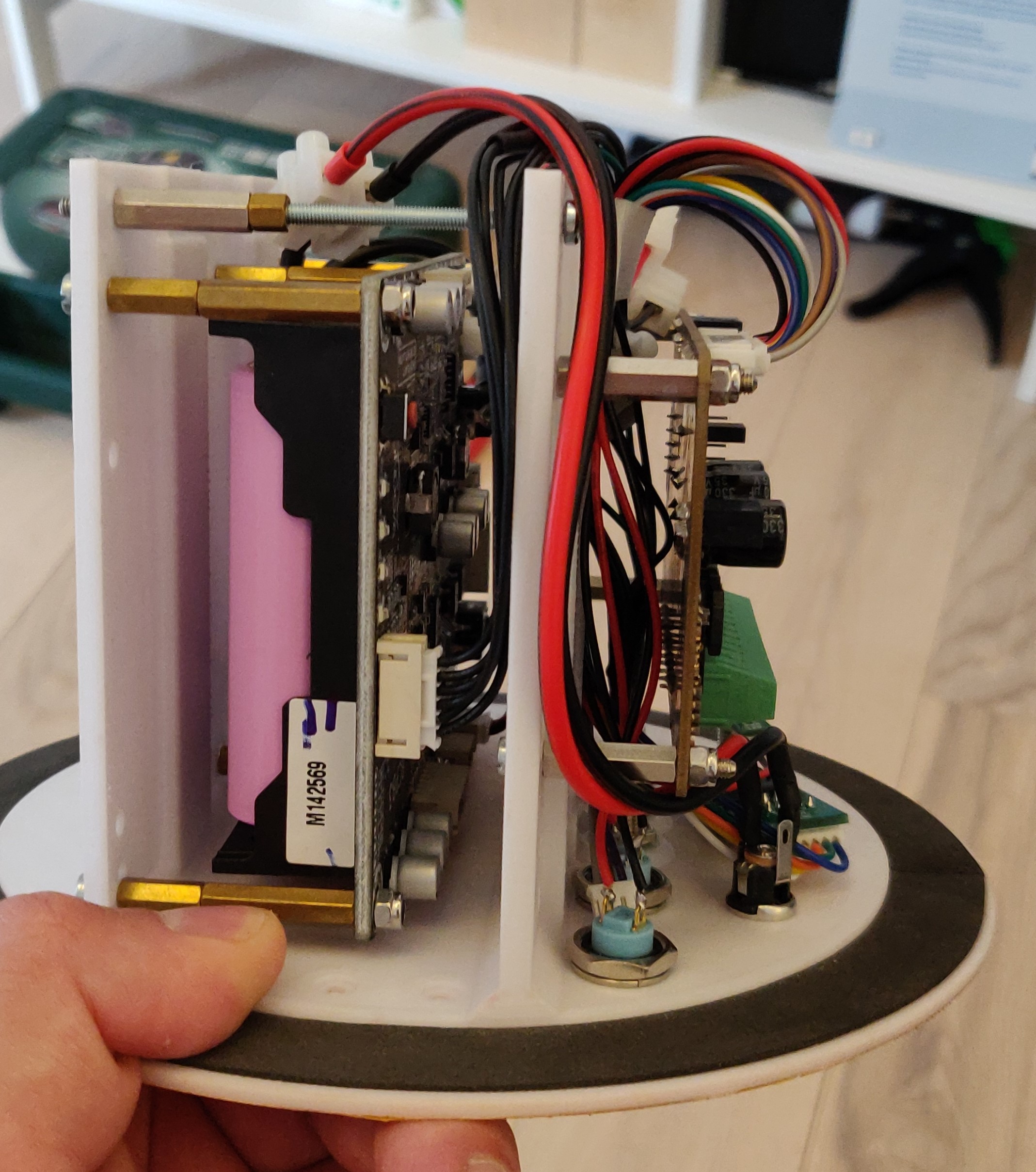

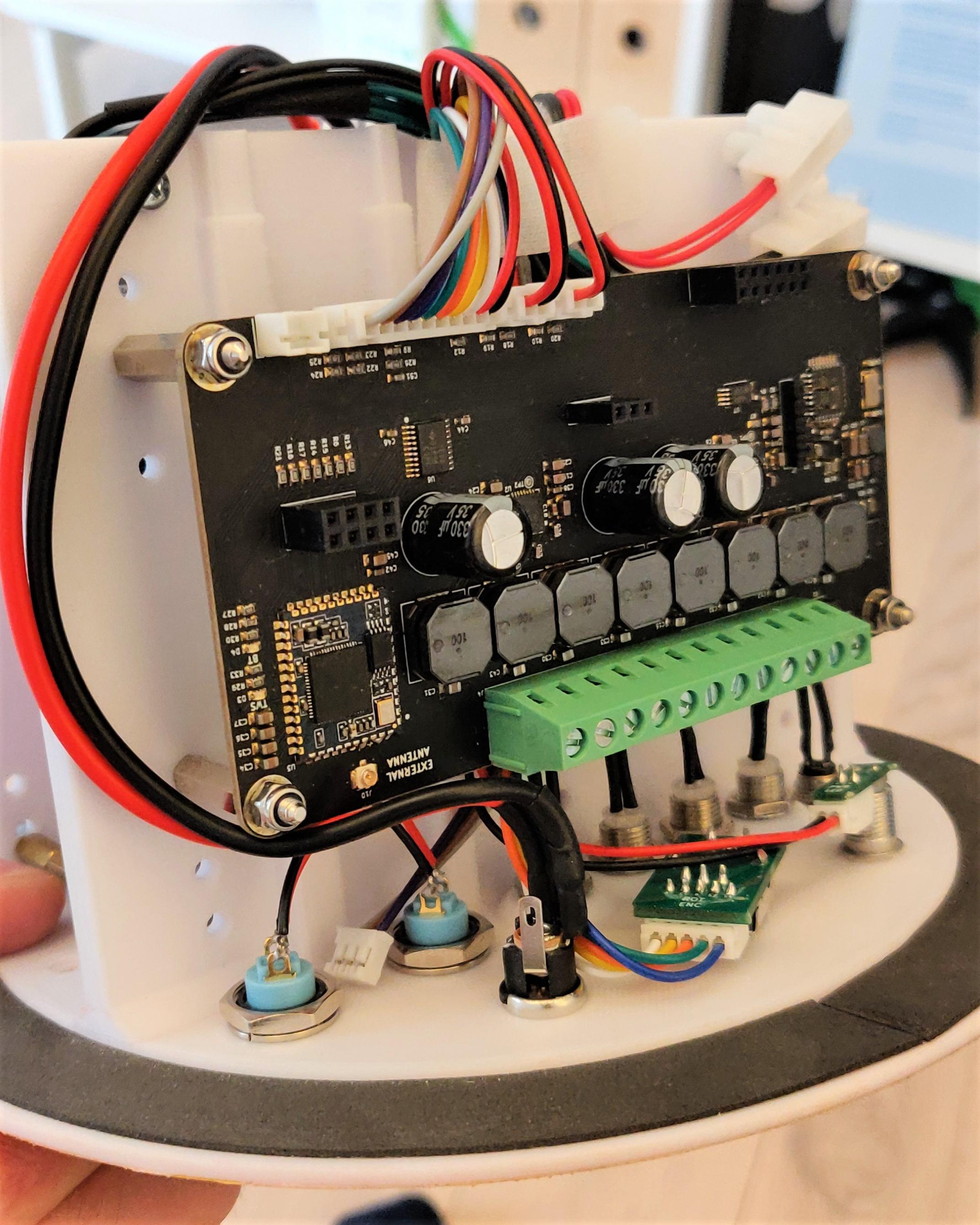

I have a quick question regarding cooling of the chip to get max power at 2 ohms.
Would it be most efficient to place a heatsink directly on the chip or to thermally glue it to the backside? I also plan on adding a small fan.
Is it possible to not have the AUX input connected, since I don't plan on using it? Lastly, the software isn't clearly showing how to PBTL 2 channels. I guess it's A+ and B+ to have a PBTL channel?
Here are some pics of my 3D printed "enclosure" for the amp and Wondoms 5x 18650 battery board. If anyone wants it, I can upload the file. It's covered in double sided tape, because I'm getting a acylic topplate lasercut to be able to have text engraved.

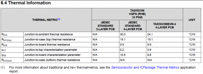

The answer can be found from the chip datasheet.
The thermal resistance to case top is twice as high as thermal resistance to PCB. Thus it is more efficient to thermally attach a heat sink to the bottom side of the board. Still, it does not hurt to add a small sink to the top if it is possible to do.

@zaxder, solid mounting! Looks nice.
Aux can be left unconnected. It will switch to aux when the BT is disconnected or pause, but that is no problem.
If you select 'single' (PBTL) in the configtool it will show you the wiring. You need to connect A+/A- together, which will be your new positive, and then connect B+/B- together, which will be your new negative
I have some small heatsinks with double sided adhesive that are suited for use with the AIO4CH. If you are interested send me a mail. They attach on the backside, the chip cools itself via the copper bottom of the PCB, not the casing.

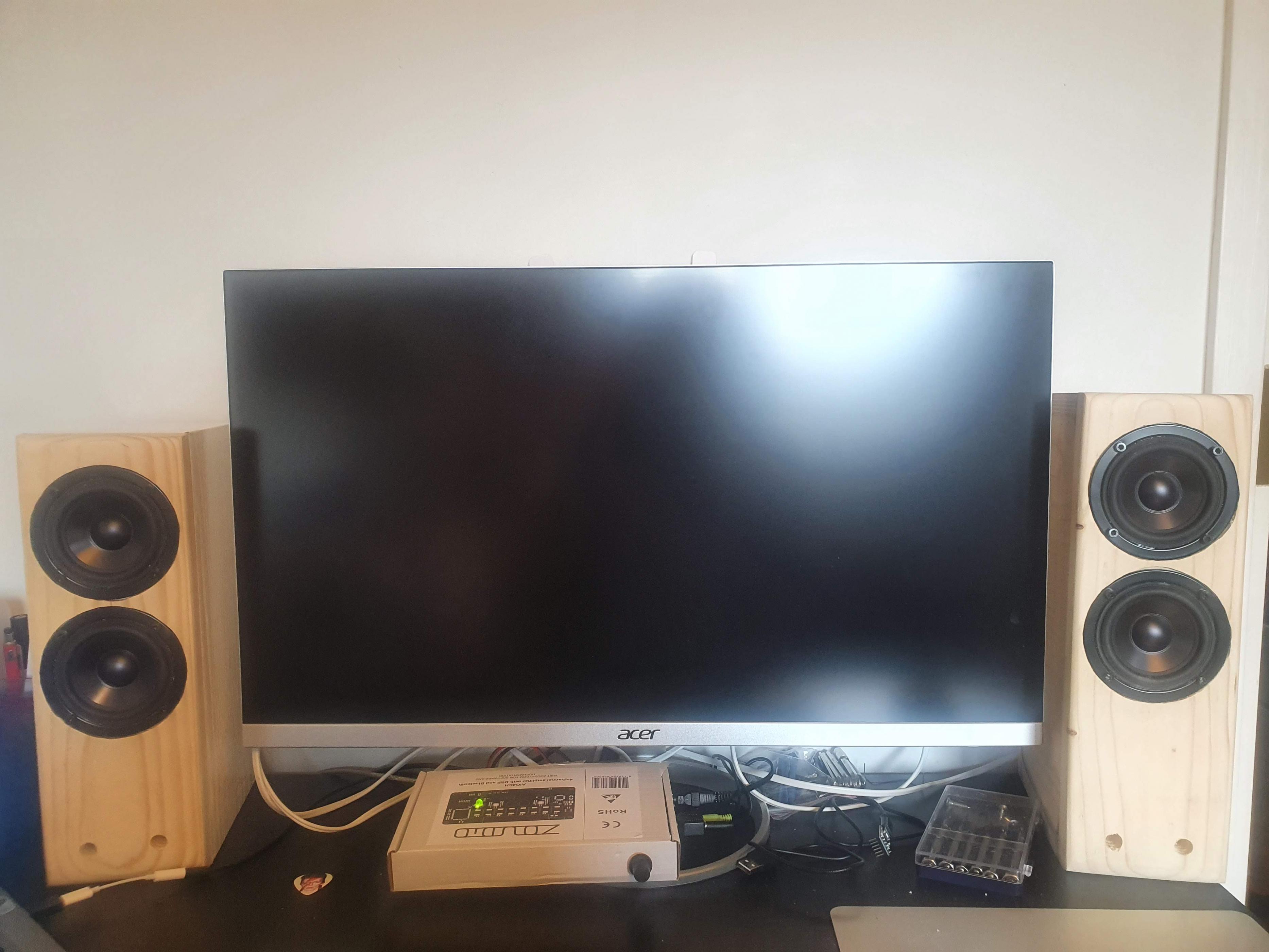

Just finished hooking up my new Zoudio amp! I built some speakers from some left over parts I had. CDT ES-400 4'' drivers and some Beston RT003C Round Ribbon Tweeters in an old Parts express bookshelf enclosure.
This amp works great. it definitely requires more than the 12v I am currently giving it. It is also completely unforgiving. The EQ and crossover adjustments are very slow to adjust and re-upload into the amp, but once there they work great. This amp really reminds me of how "unseasoned" I am at tuning !
What are you guys using for Tuning software, and basic ideas to see if drivers even work well together? The 2 drivers I have definitely do NOT !
Any ideas of some drivers that would work well together in a decent bookshelf speaker? The problem here is that I don't have a Subwoofer, so a good low end is 100% necessary ! I'm gonna have to ditch my enclosures and mids, and defintely go with a good 6.5 or 7'' driver. The problem is my tweeter only plays down to about 5k....so it looks like I need a new tweeter also lol.
