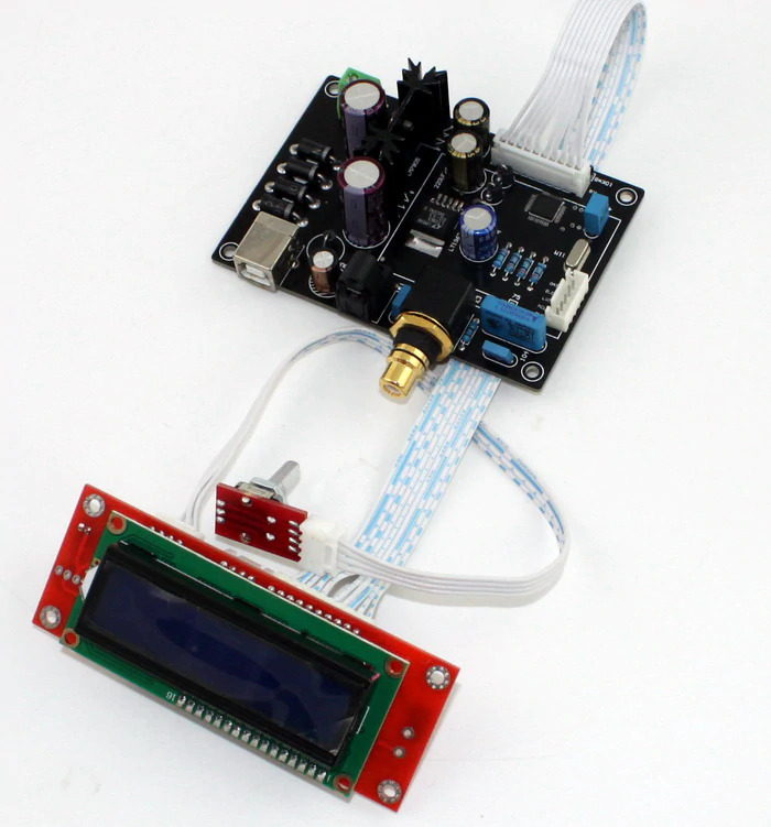

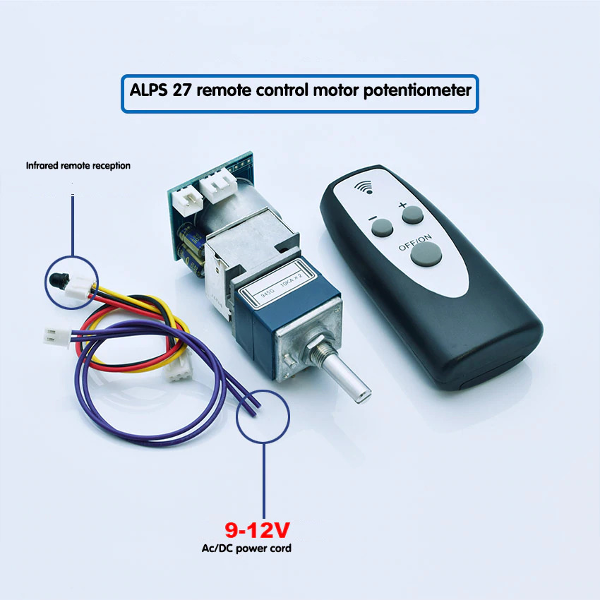

Any way of getting remote controlled volume adjustment on these?
I can offer a ready-made solution for analog input only
it would be something like this or this. There are even LCD and input selector options available.
I see the only way to add volume control for bluetooth or IIS input is to add external controller (pic or arduino?) in place of rotary encoder.

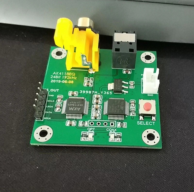

I ordered this AK4118 SPDIF/TOSLINK converter to I2S.
It was the cheapest board with AK4118 receiver I found there.
I just hope that one is a better performing chip than CS8412/CS8416, DIR9001, WM8804/WM8805.
The latter should be good enough also.
Another options are
LCD equipped board.
OLED with amanero socket? Not sure is it pin compatible with original Amanero.
These are not my recommendations, just findings. I know nothing about quality of these boards and can only make a guess that these are boards that would work as an optical and coax converters for the ZOUDIO AIO4CH I2S input.
