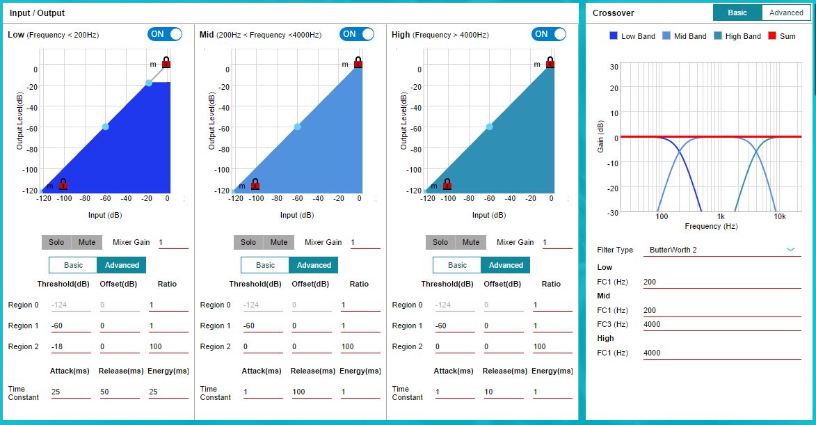

The chip supports both compressors and missing fundamental options. These options can be set in the official development platform from Texas Instruments: PurePathConsole.
The difficulty is in the amount of software development to reverse engineer and implement these features. Currently there is no time/money to put in that effort. See the attached screenshot for an example on how many fields and graphs it has in PurePathConsole.

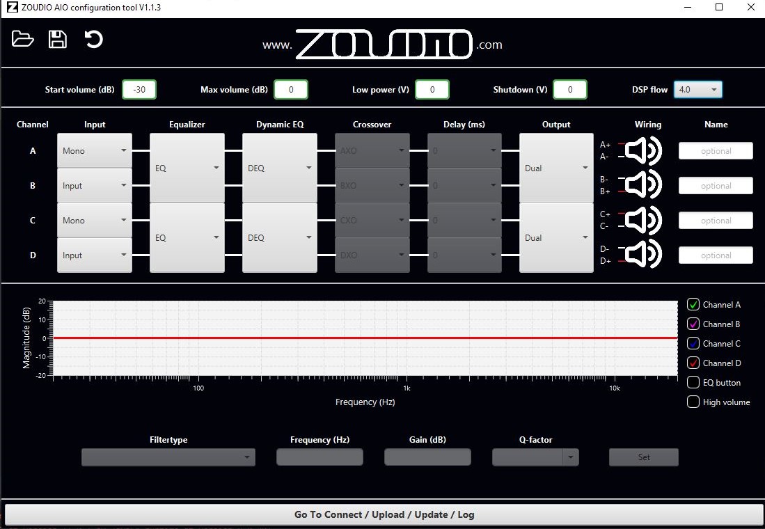

Features added in the upcoming configuration tool update:
-Support for separate input mixers, making stereo 2.1 setups possible.
There will be two firmware files included. To switch between 2.2 and 4.0 mode, you need to switch between firmware files. In 4.0 mode, crossovers and delays are not available.
-Support for custom biquads
-Connect/upload/update/log is now seperate from Settings in the GUI. Looks a bit less cluttered.

4.0 has one input mixer per channel, instead of per amplifier, so you can make a 2.1 setup with stereo sattelites for example. About the DEQ: like Zaxder said 🙂
