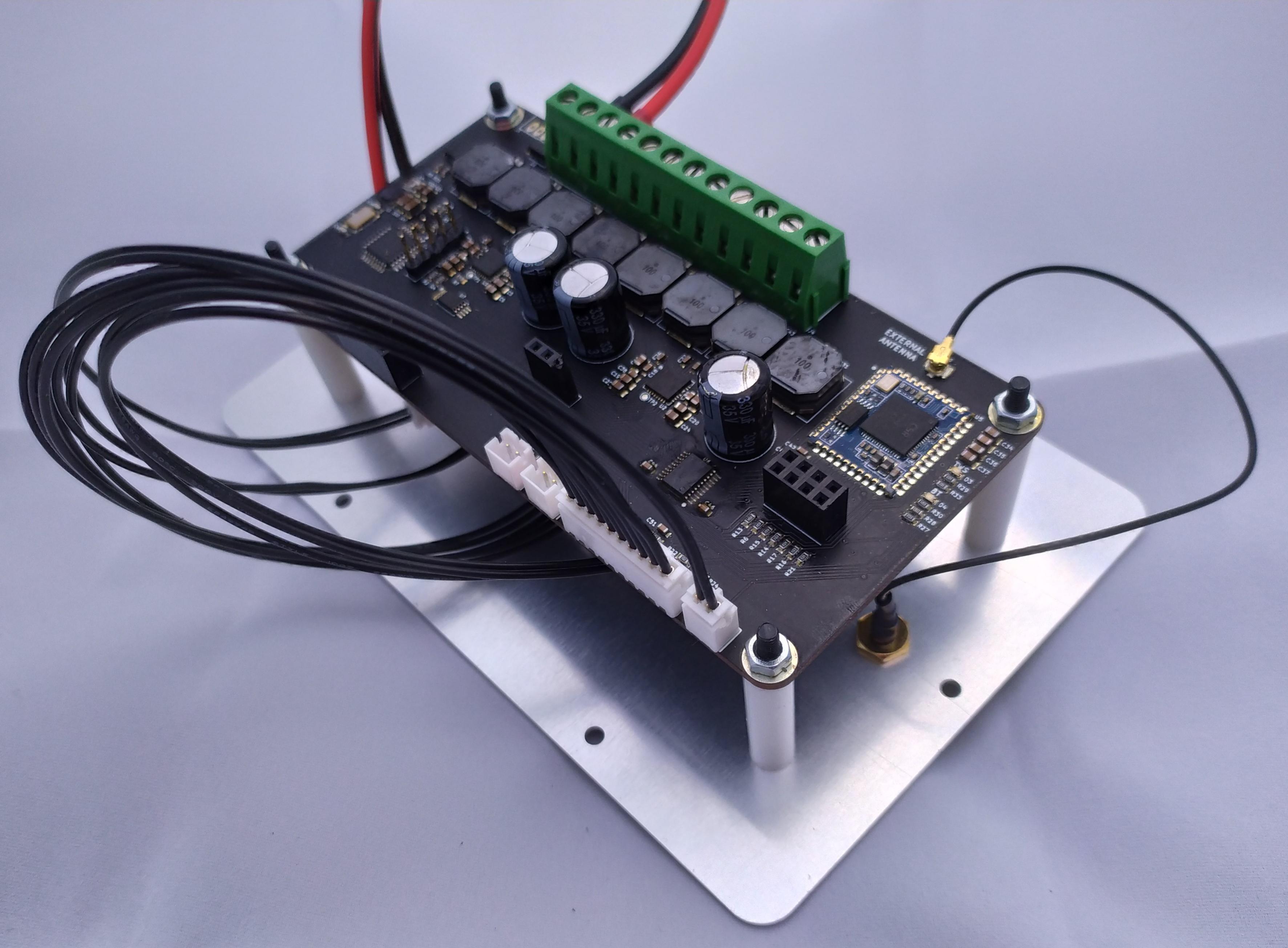

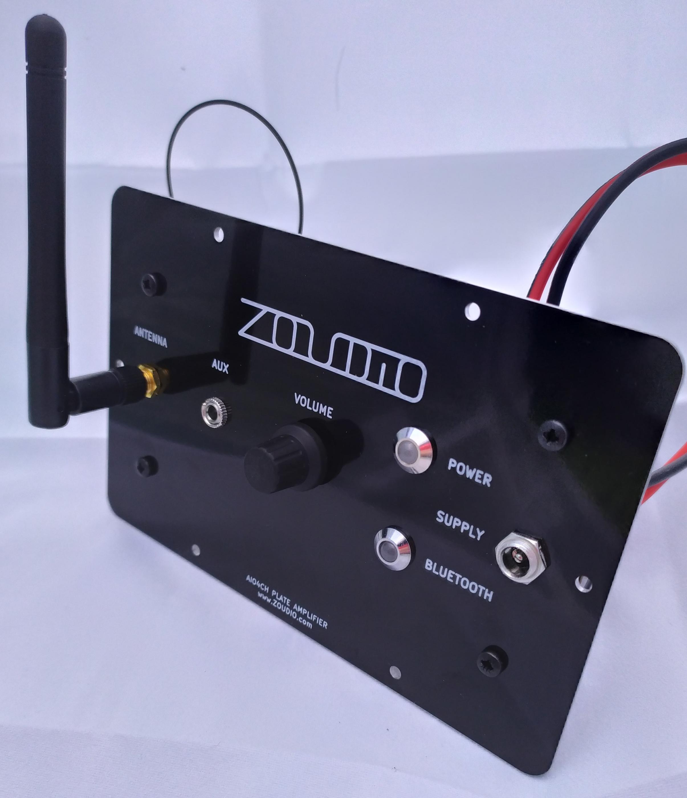

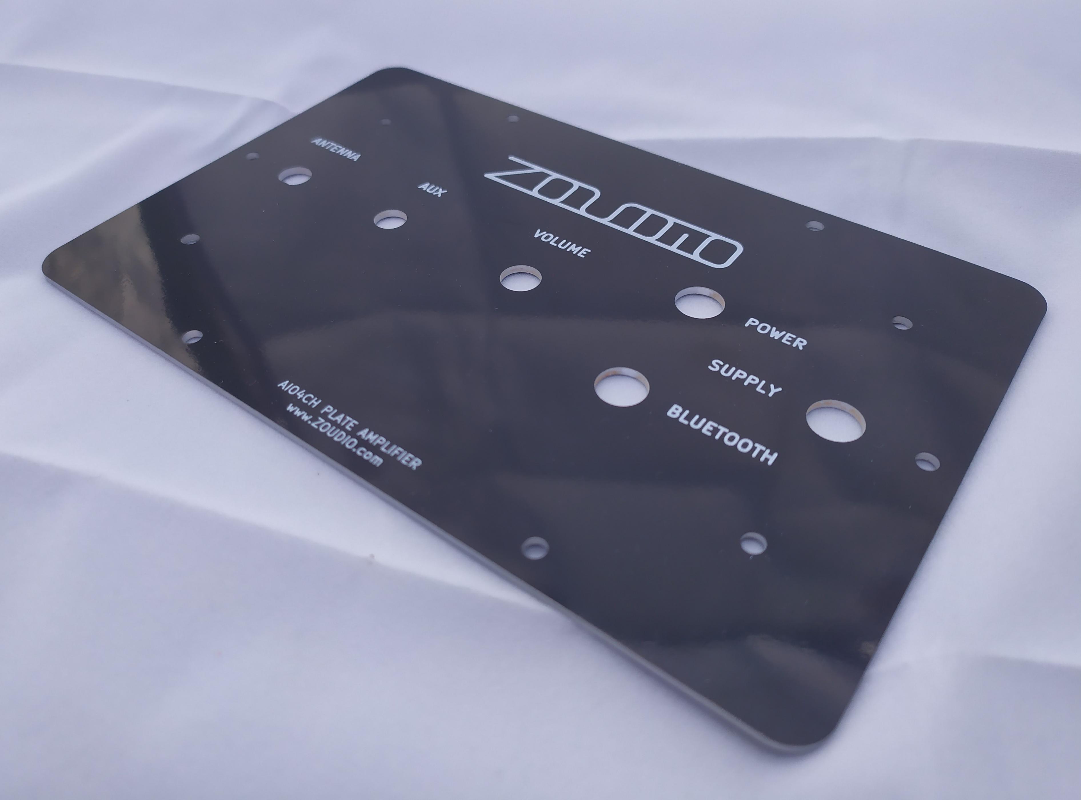

Other news:
Within 2 weeks a limited amount of front panels will be available:
An easy way to integrate the amplifier into a speaker design as a plate amplifier.

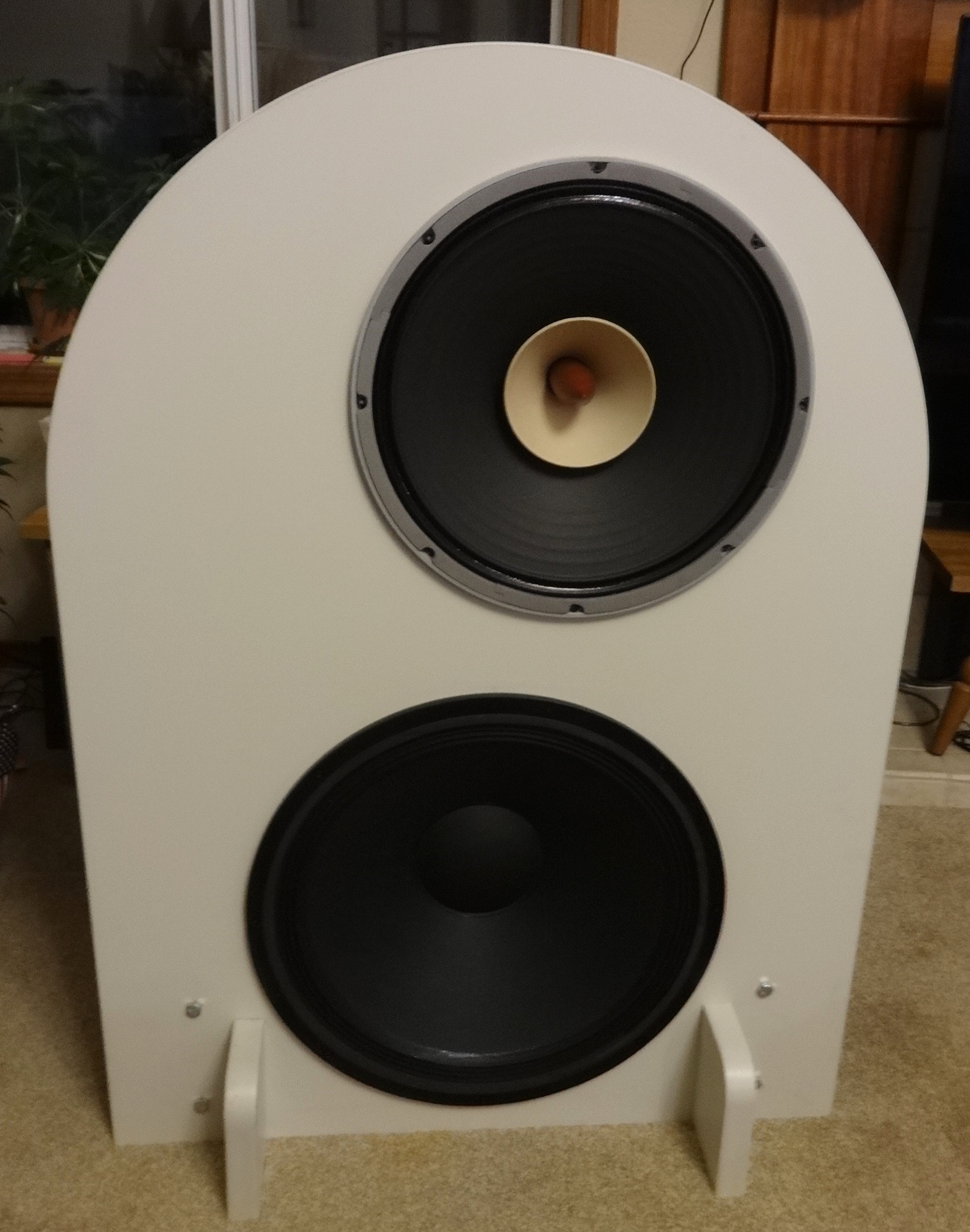

Depends what you mean by "sub". I drive a pair of these with just one Zoudio 4 channel amp. That's an 18" assist woofer, handling 100 Hz on down. With reverse rising response to comp for the OB.
They go as loud as I'd ever care to listen, for more than a few moments. At my normal SPL listening levels, the transparency of this amp with these speakers easily exceeds many acoustic instrument recordings. Admittedly, I couldnt put my setup in a dance hall and play uncompressed electronica at 110db...
The Zoudio AIO4CH can be more than a boom-box amp. It depends on what you feed it, what you have it connected to and how you listen; it can serve a fairly large setup. It also happens to be the only full digital signal path right up to the speakers amp I know of, besides some currently available rPi accessories. Which are also in the same <100W / ch power range.
