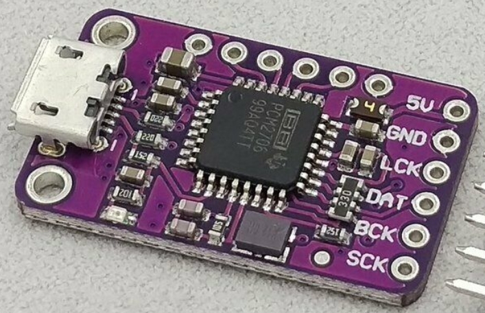

I bought a PCM2706 USB to I2S board off fleabay for $11. There's other such boards that appear to be at least on the same order of size as the BT module. Perhaps a future spin of the mainboard could accommodate both, for a USB connected amplifier option - simply by building it with this module instead of that one.

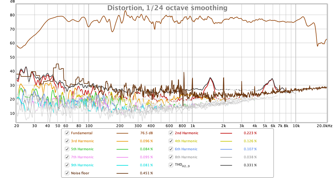

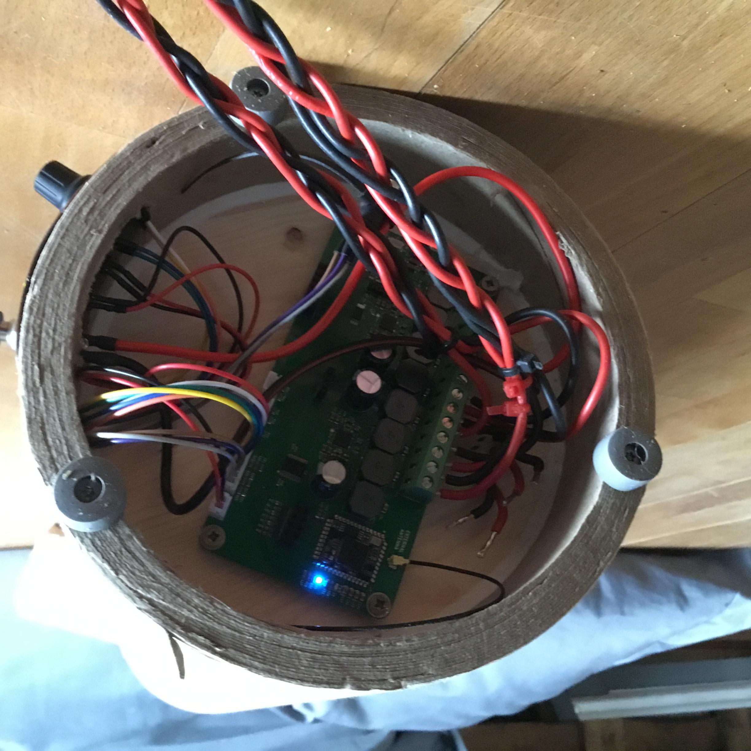

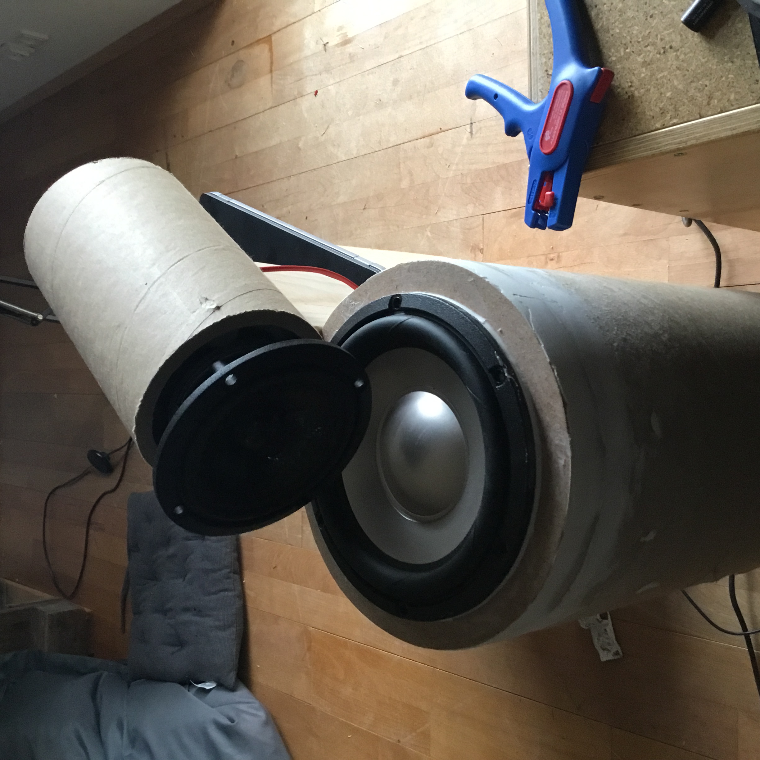

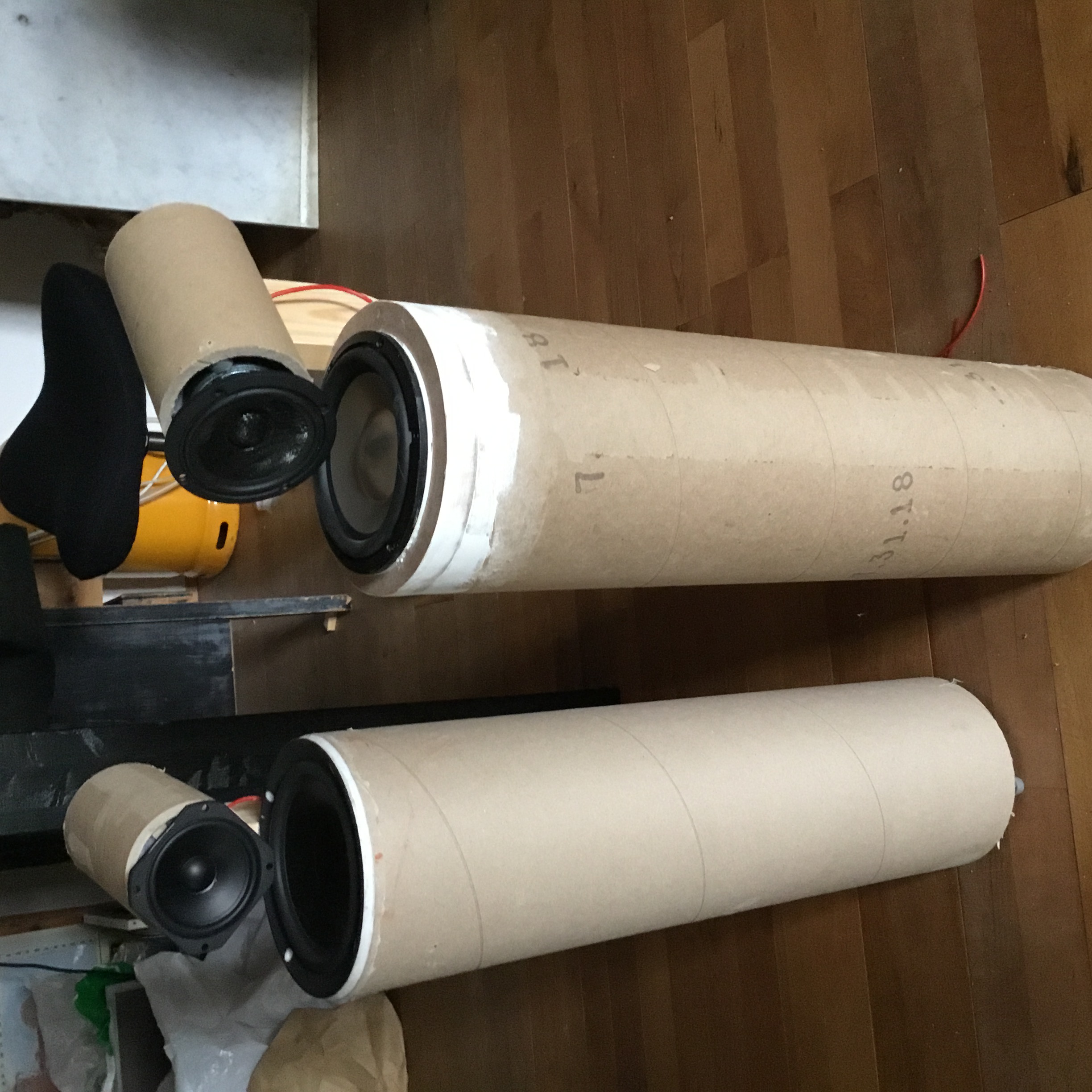

Lots of spare time in C-19, so time to show an example of what can be made with the Zoudio AIO4CH board.
I am planning to build a pair of clone LXMINI+2, and startet with purchasing the original SEAS drivers FU10RB and L16RN-SL just for the LXMINI itself. For those unfamiliar with the LXMini you might want to check www.linkwitzlab.com. Kits or even finished speakers can be purchased from www.magiclx521.com
The Zoudio board with 4x50w and dsp is a great match for the LXmini. A higher output would be great, but I am not listening at very high volumes anyway.
I measured the response using REW and UMIK-1, and adjusted dsp settings from that. Naturally the FU10RB takes a bit of adjustment. I got quite a bit of tips from a LXMini clone builder LXC LXC - cdenneler
For convenience I used heavy duty cardboard tubes for the cabinets. I will probably wrap them in wool textile for finish. The speaker on the left side is a low cost version using a 6.5” Jamo 21330 woofer that I salvaged from a pair of Jamo 8 classics, glued directly onto the cardboard tube and a VIFA TC9FD18-08. The Jamo is too hard for this small cabinet of 12 l, so not a good match.
I placed the Zoudio board in the base of the right speaker, and connected the other speaker with a threaded 4 wire cable. Not ideal when it comes to heat, but it works fine so far, and makes for a very compact system. I use a Meanwell 24V 120W external power supply, can probably be a lot smaller.
I am generally listening to levels below 95 dB and it sounds amazing, everything that is written about the LXmini is very true. I tribute the very transparent sound to the Zoudio board.
I had to limit the equalising of the woofer to +8dB, otherwise I got a strange respond where the board would reduce sound levels immediately if low frequency bass was present. I also had to move some of the equalising around to get enough taps. The analog input gives off noise, but only if bluetooth is not connected, once connected the unit is dead silent. Sometimes the BT connection will produce clicks while playing, but a quick disconnect reconnect will fix it. Lutkeveld (Jesse) has been very helpful with support to my questions.
Next step is to build two sub-woofers and switch to two Zoudio boards in TWS. Each board is then running 2.1. I tried already using a set of SEAS 303 speakers as a sub, and it worked great. There is a nice design of an alternative LXMini sub on the LXMini user group ORION/PLUTO/LX... Users Group • View topic - LXmini subwoofer add-on (a.k.a. LXmini+)
