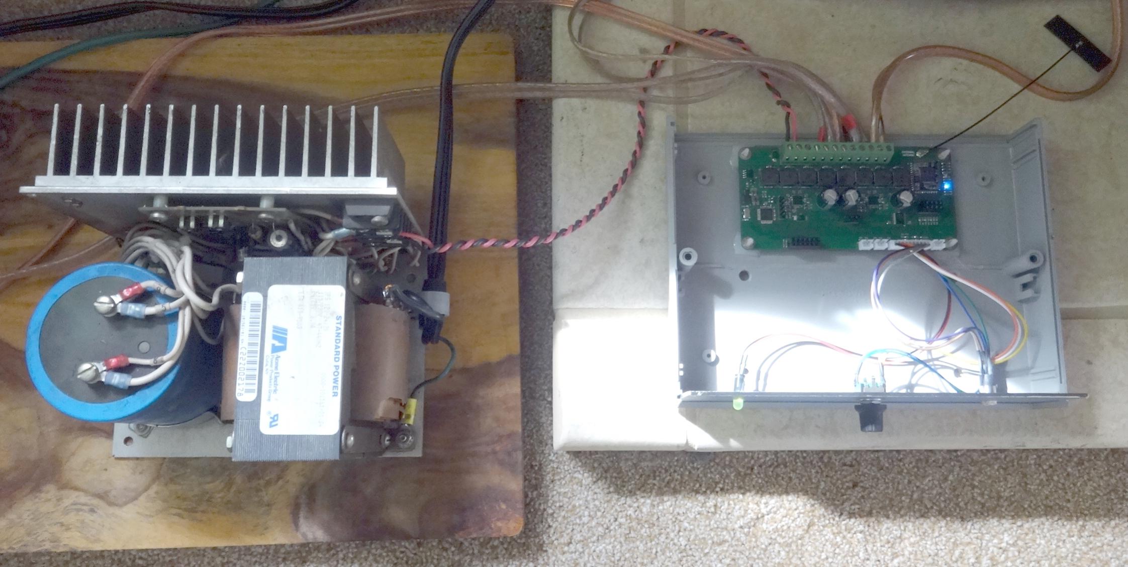

A Winner
UPS was running late, as I've read their very busy during the pandemic - I got the quite massive linear power supply late last night.
I connected it up on my bench and did a quick regulation test. Initially set to 22V (adjustment from 21.5 to 29V) output dropped 100 mV with a 5.5A load. A pair for 2n3055s mounted to a large heatsink got hot quickly, from dissipating 100W at that load. The 33,000uf bulk cap was sitting at ~39V...
Ripple on the 22V output as measured with my DMM - I assume zero high frequency content - was better than 5mV at that load. So I connected it up to the amp - see photo.
In use at my casual listening level, the cases of the previously blistering hot 2n3055s are at room temperature. Ripple as measured with another DMM still better than 5 mV...
It sure isnt pretty nor elegant - more like ancient, well used and beat up - but does what I want sound wise. I assume this (analog regulated) is the electrically ideal AC input voltage source for this amp. $30 shipped is quite a bargain for US customers. The clarity of the sound I'm getting I assume is the best this amp is going to give. Cant wait for the opportunity to crank it to "show off the stereo" listening levels!
I've tried it at 18.00v and also gave it a bit of a pounding while adjusting slowly up towards 25.5v 😀
At 18v I could clearly hear it when it ran out of "oomph", like hitting a wall. Much better at over 24v IMO.
Have not tried any higher than 25.5v, feel safer with just a tiny bit of safety margin there.

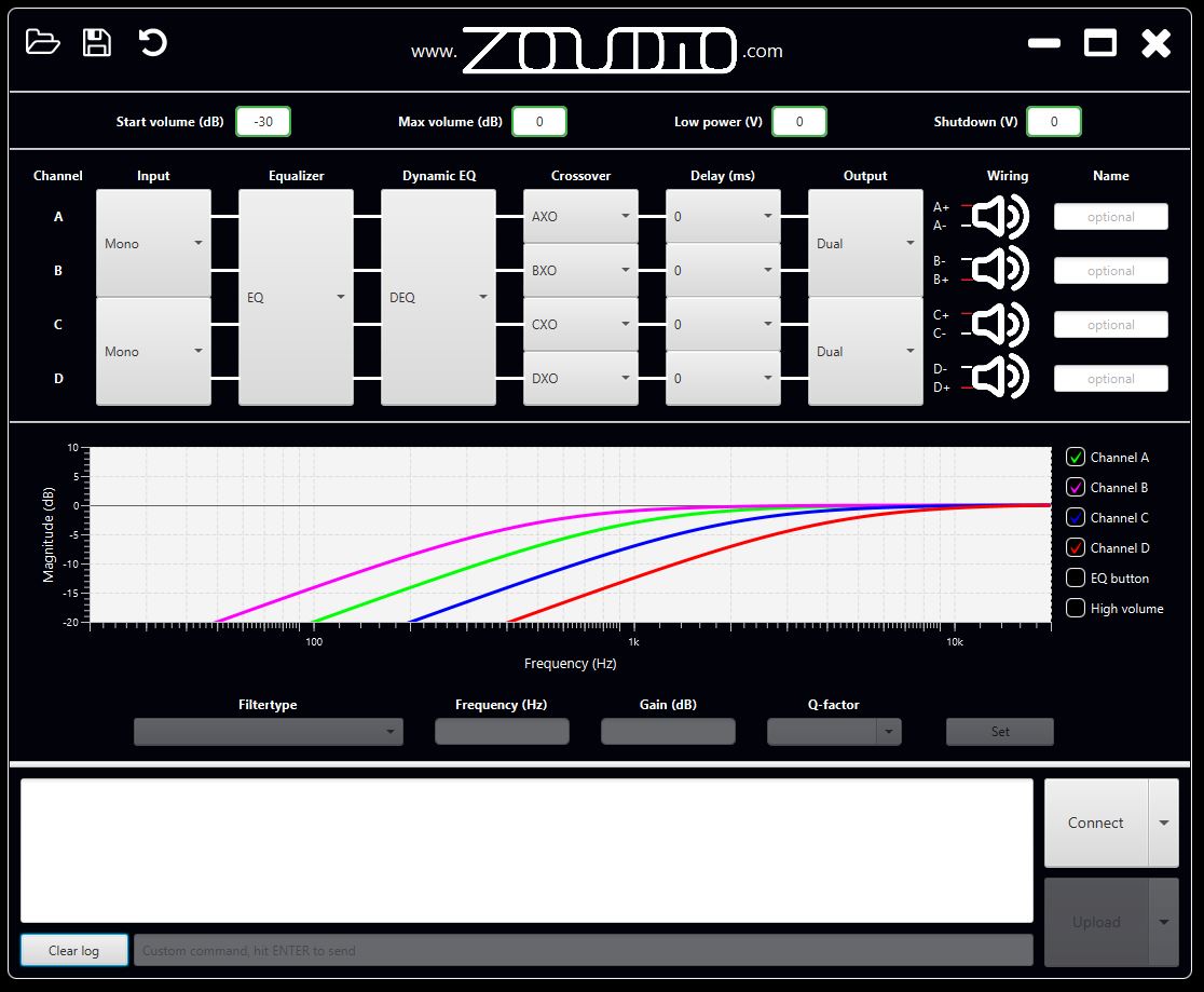

2 borads for stereo 2.1 pair?
I just received my 2 AIO4CH boards and it looks very nice. PCBs, packaging, really great.
What I want to do with this setup is a stereo par of digital loudspeaker running from digital source (Raspberry Pi) over I2S. Two questions:
1. Is there any chance to use input I2S signal up to 96 / 192 kHz? What is limiting it to 48 / 44.1 kHz?
2. I have 2 AIO4CH boards and want to use them in 2x 2.1 setup (3 way stereo pair of speakers, each left and right channel with dedicated AIO4CH board in it). I don't plan to use AIO4CH volume control so I will "program" the crossover frequencies and EQ for each speaker separately (L, R). Now the question is how to "connect" left and right speaker - should I provide I2S input signal to both of them (some splitter from Raspberry to Left speaker I2S and right speaker I2S) or rather use eg Left speaker as a "master" and send data to right speaker ("slave") from it? (wired - I2S or wireless - Bluetooth TWS?)
Good to hear that you received your boards!
1) The DSP programs it runs limits the input to 48KHz sampling
2) In your situation I would recommend disabling the BT module (I have sent you a mail with instructions) and splitting the I2S input (data/wordselect/clock) from the Pi to the two modules. Use high quality cables and twist them for good data integrity.
Once you have verified it to work, you turn the amps on and leave them on max volume so that you can use your Pi to control the overal volume.

Thanks for your quick feedback.
1) It seems that this TI chip supports up to 192 kHz. What is driving this 48 kHz please? I would like to use it for hi res audio up to 96 or 192 kHz. Any chance to enable this please?
2) my plan is to enable one speaker with Pi as a network streamer and I2S audio output to Zoudio (either directly Pi to I2S or Pi with SPDIF / USB to I2S convertor to Zoudio. As I2S is mainly for on the PCB interface between chip it will be ok for one this one speaker where Pi will be integrated. However for the second speaker the “distance” between Pi and Zoudio will be 2-3 meters which is probably not the best thing with I2S bus.
Does anyone uses 2x Zoudios for for left / right multiway speaker configuration? If sl how is the connection between them done?
1) The amplifier runs a 1.1 48K flow with parameters that can be modified by the configuration tool. Running at 192k requires custom software and makes it incompatible with the tool
2) If you want to use I2S, there are not much more options. I suspect that if you try to reduce the distance as much as possible and twist the cables, it will work fine. But its always good, as Darmur says, to check the signal quality at the other end if you have the tools to do so.
If you use BT as a source, you could use the TrueWirelessStereo function. If you use the analog input, you can split it.
