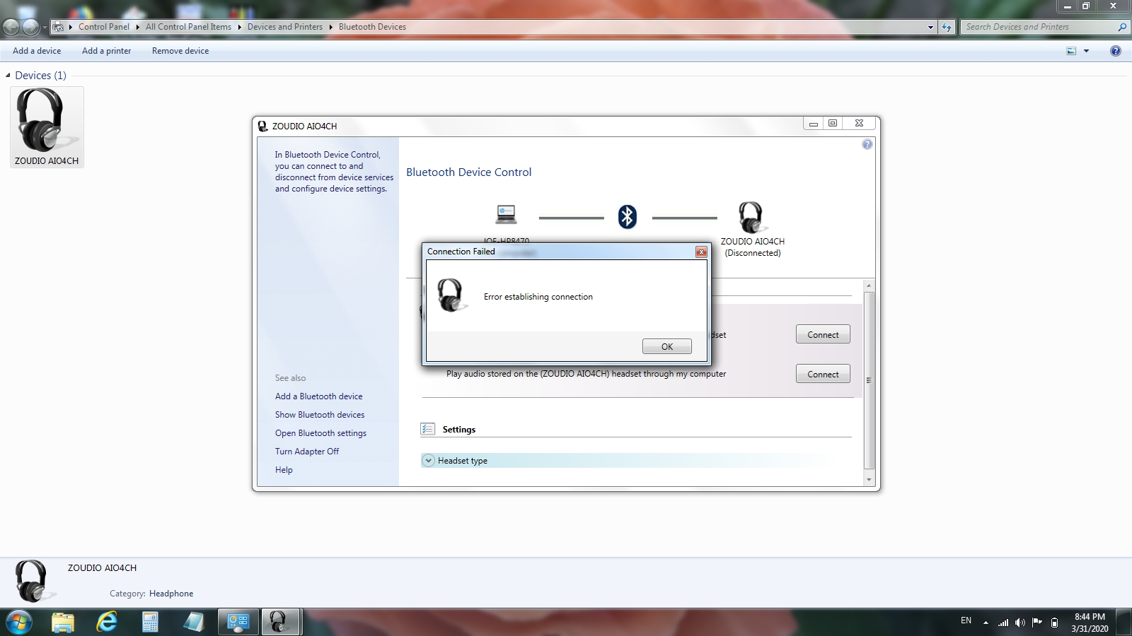

Okay, now I'm really pissed off...
I buy a BT adapter specifically stating it's A2DP compatible. Shipped unbelievably fast.
Download the driver software, install it, connect to the Zoudio amp - blue light solid - should be all good, right?
FORGET IT! Bars moving in time with the audio - no sound. It's not "is it muted" - otherwise the green bars would not be going up and down.
Then, after reboot "Error establishing connection". 2nd time, 2nd computer...
Connects the first time, then never again.
I want an answer. I have a W7 system and I'm a customer - I want it to work.
Either solve this problem or put in your documentation "Operation under some windows 7 systems NOT guaranteed"

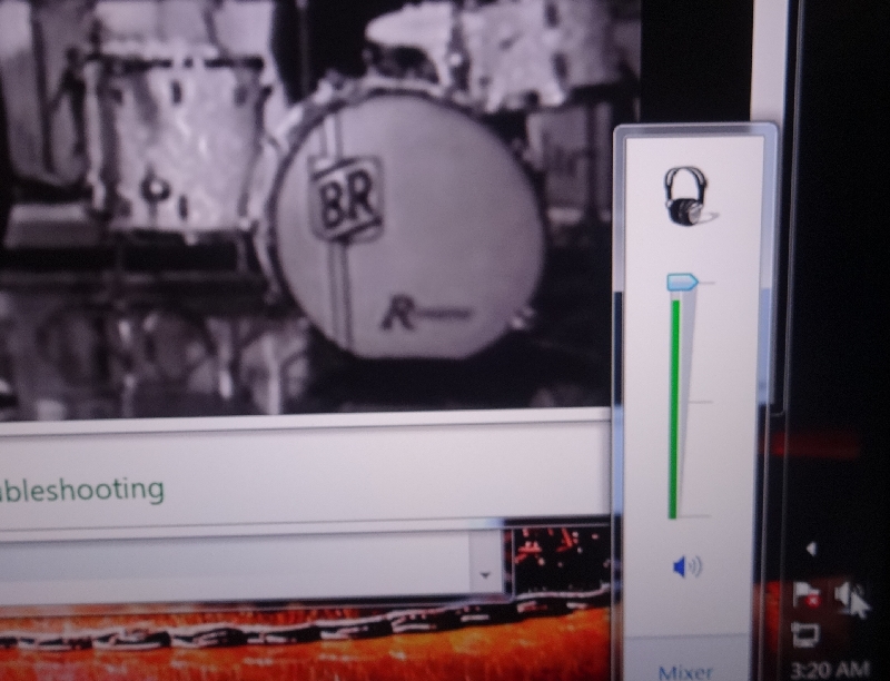

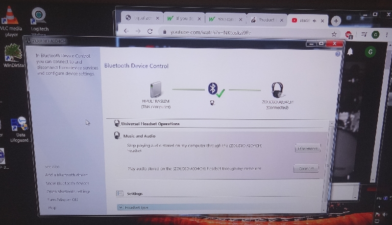

If you search for "A2DP windows 7" on youtube, you see that a lot of people have problems with the BT driver. Maybe there is a video that has a fix that works?
If the blue light on the amp is solid, is has a proper connection, however your computer is not passing any sound then. If you can not get it working at all, I will put a disclaimer in the documentation with a recommendation for windows 10.
edit: Maybe it has something to do with the detection as headphones? Does the Anker also get flagged as headphones?
Yes, the Anker speaker also shows up as a...earpiece - not even a headphone avatar.
BT has to be the most screwed up...I upgraded to Windows 10 and...it did the exact same thing as depicted above, right down to refusing to connect w/o error. I have the pictures, where one part of Windows show it connected, another shows it disconnected - it's just a crazy mess.
In exasperation, I uninstalled the driver software the manufacturer of the BT adapter (iogear) claimed it needed, as I was going to try the CSR USB stick. Forgot to pull the iogear BT adapter and (drum roll) upon reboot "bleep" from the Zoudio amp and a solid blue light.
I'll take it. Playing audio from the PC hardware, instead of the iPhone for the 1st time. How? I have no idea... But it sticks after reboot of the now Windows 10 PC.

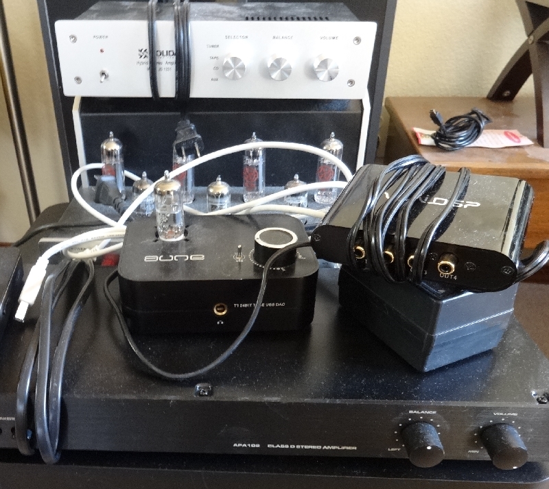

To think I replaced This with this; And I even like the sound of it too, which is comparable with what I was getting out of the tube amps and signal processor stuff. It's a sound I can live with which has caused me to set aside the older approaches for something totally state of the art, IMHO.
BT certainly provides electrical isolation from the computer and with battery power, one could finally ditch the AC line connection while listening. I have this electric lawnmower with two 12V, 18 Amp-Hour batteries in it...
