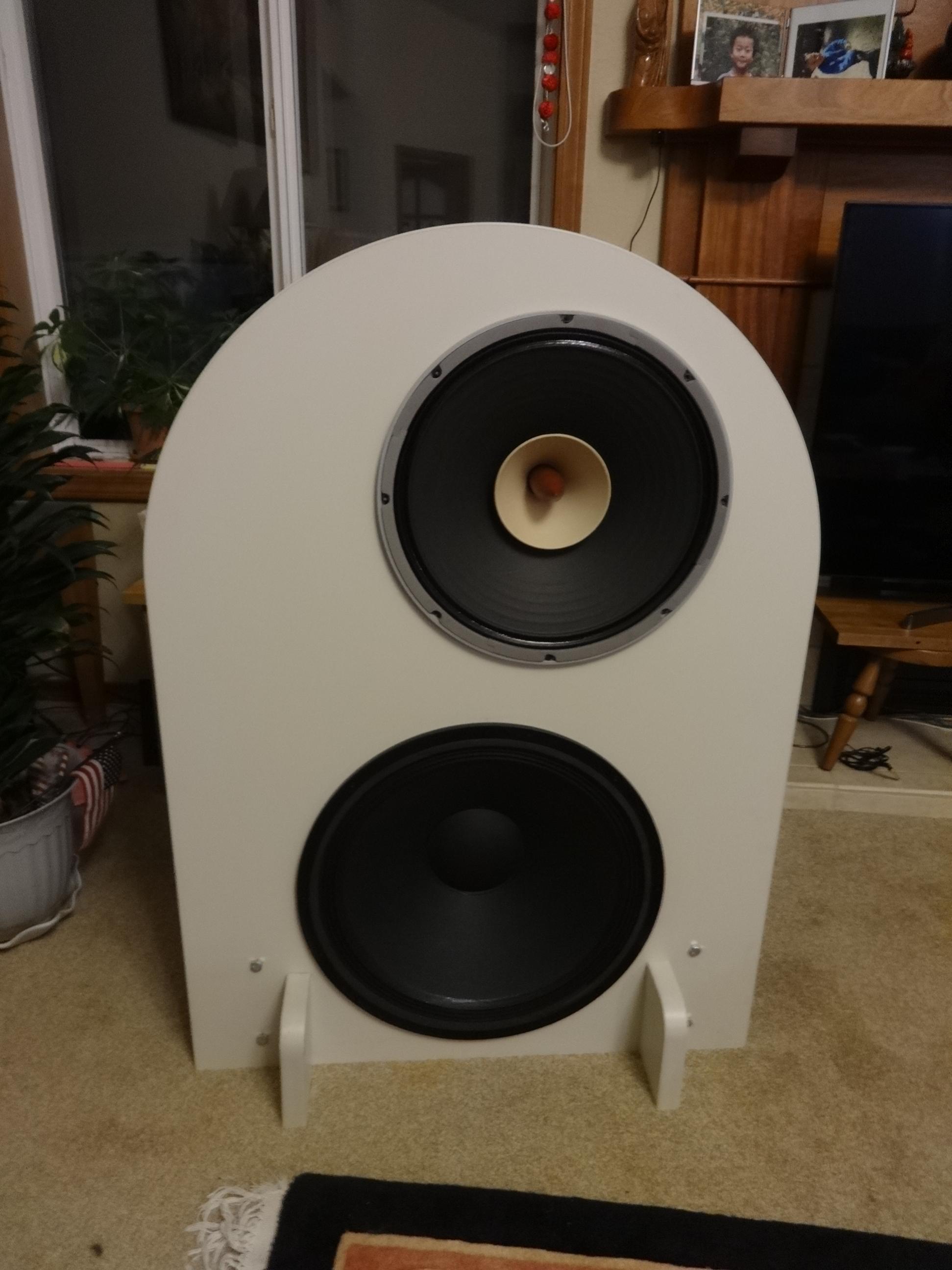

I got my Zoudio a couple days ago. Had prepped my phone with a few album selections in flac and bought a player from the Apple app store. I'm ready to go.

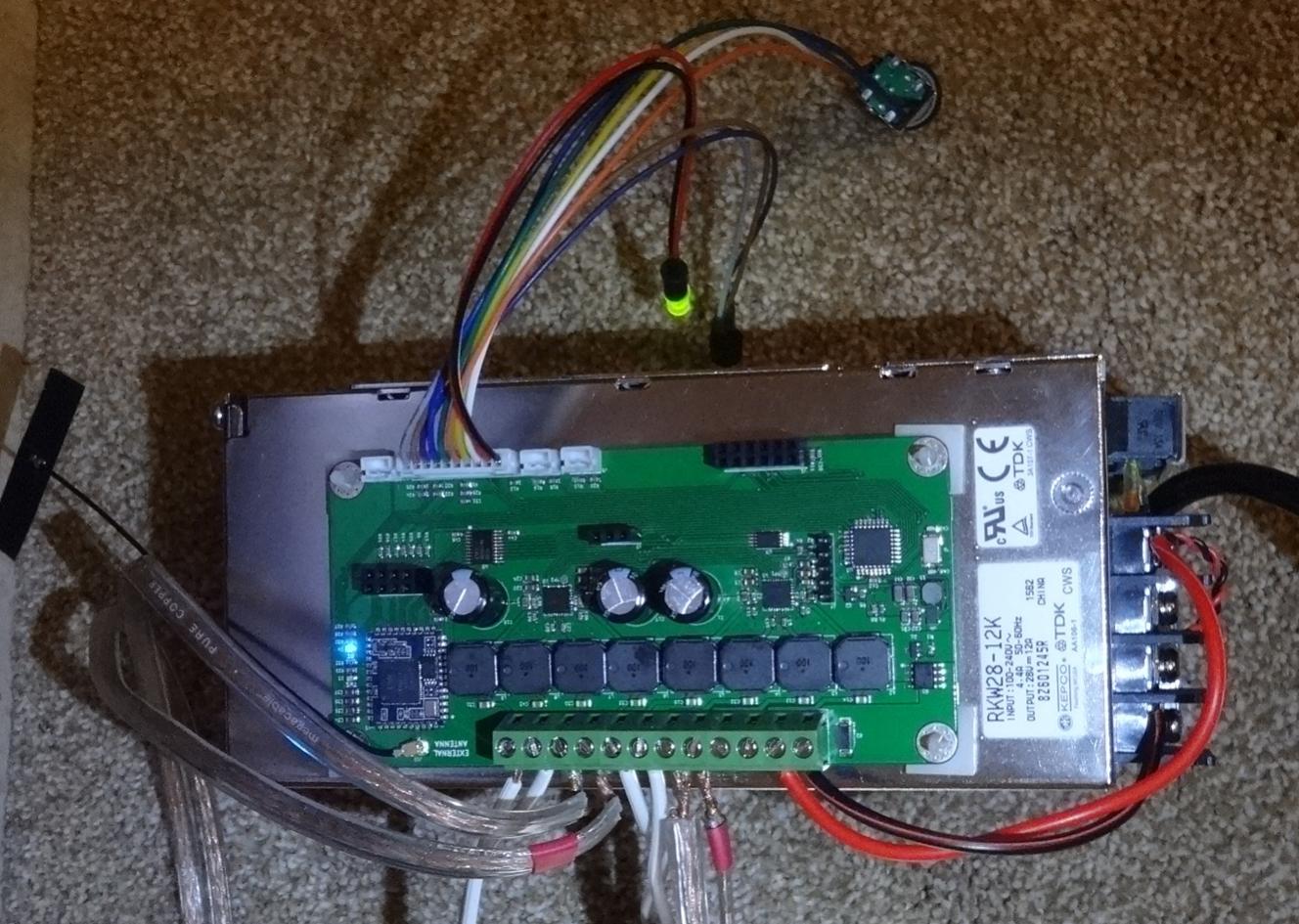

I had a 28V power supply with 12A capability from a previous employ, which I dialed down to 22.5. I simply mounted the amp to the power supply case using the 4 stick-on posts provided. See photo -
A driver was needed for the programmer to connect to my PC based HT. I also needed to download Java runtime; after doing so I was up and running. You can program filter parameters with the amp powered off.
Jesse stated in a PM "You can build an LR4 from biquad filters by stacking two biquads with Q=0.71". So this is what I set out to do first - just to get 100Hz LP and HP outputs going; OB compensation for the assist woofer would come later.
Setting up the filter stacks is easy, using the GUI interface. Connect, upload and save the setting to a file on the PC. Disconnect, unplug the programmer cable. Firing it up for the first time, made a small chime sound which is quite convenient. Connected straight away to the iphone 6.
Figuring out the player I bought took a couple minutes, but soon music was in the air. The sound is crystal clear with all the imaging artifacts that I love so much are in place and vivid! I could live with this easily and just get rid of all the other tube amps, DACs and the miniDSP.
But of course the bass is off. I need a response that rises upward from 60 to 30, so I setup three "peak" filters, one +10 db @ 25, one +5 db @ 50 and one +2.5 db @ 75Hz. This got the bass back where it should be and made the system much more listenable than w/o this compensation.
The only thing missing is my FR speaker voicing convolution filter I'm running in Daphille. It looks like I'll be loading that into EqualizerAPO under Windows, once I get a hold of a Bluetooth adapter for the PC. Need to follow up with some measurements.
Bravo on this amp's sound - and versatility! Clearly the way of the future - Look Ma, no capacitors - flac file to speaker VC!

Moved to a 19V brick at 6.3A - couldnt take the fan noise on the TDK unit, which starts spinning up as soon as the amp is turned on... No good way to eliminate the fan, replace it with a smaller unit, or mechanically isolate it on that supply chassis.
