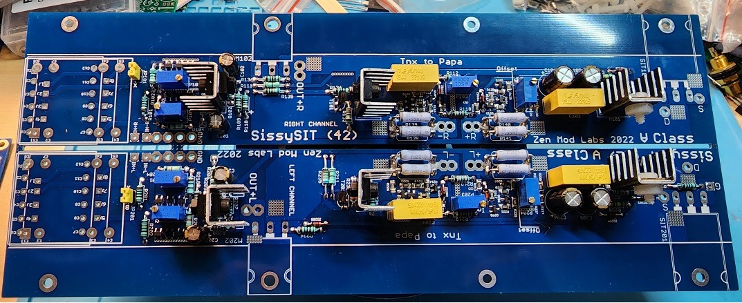

R112 (1K3) and P103 (500R) ... can I change to 681R for R112 and 1K for P103 instead? Don't have 1.3K in drawer and no plan to restock from Digikey or Mouser before 2023 ...
As a benefit, maybe I can leave P103 at midpoint for total resistance of 1K28 on startup ... laziness paying back with even more laziness 😼

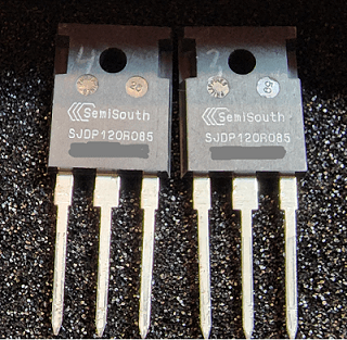

Forgot to ask - any value changes to use Semisouth SJDP instead of Tokin elevator shaker?

Just in time for the holidays. Will remake one of my SissySIT R1 into SissySIT-42 SJDP if time permits. Thank you MZM!

60R4 level shift installed
if you test those SJDP with 1A8@24Vdc and write what's Ugs, I can tell ya level shifting resistor with few ohms margin

I keep seeing photos with discussion of Sissy 42, showing Semisouth parts, that is what got my attention, (post #84.) How are they figuring into Sissy42?
Or just teaser pic for greedy ones?

Oh well, not my Semisouth, still digging through stash but am only coming up with E120R125 parts. Thought I had something SemiSouth with "SJDP" maybe not.

SJEP can be used as upper OS part in SissySIT R.3 and (42), with few specific tricks:
DN2530 or DN2540 (TO220 case, lazy to check proper suffix) for M101 level shifting mosfet
level shifting resistor R133 in range of 120 to 150R
results ....... dunno, didn't tried and will I ......... maybe if I feel for it when going to try SJDP I got from Dennis
parts designation per schm in post #1 here

- ZM's 2SK2087C musings, phase two - SissySIT (42) as a cradle
