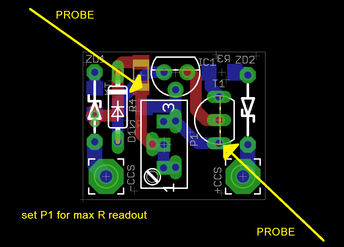

LM334 calculus for Iq is basically Vref/Rset (simplified), meaning that when trimpot is on max value, then Iq is minimal
now, if we take a look at Daughterboard pcb, where we can check resistance of trimpot ........ it is practically the same as you did it .... see enclosed pic I just made
does it mean that I ooked up with CW+Iq note, can't check in this moment because I'm not in workshop and I can't really decipher it from trimpot orientation ( never learned how damn things are oriented)

ZM - I checked those 2 points, so I was on the right track.
I went for MIN R readout, not MAX.
I have 120R level shift installed.
Since MIN R gets me 4A and MAX R gets me 2.5-2.6A IQ, I'll swap level shift resistor and try again. Thank you!!!
CCS pot
CCW = Low Iq = High R
CW = High Iq = Low R
That’s clear to me now.

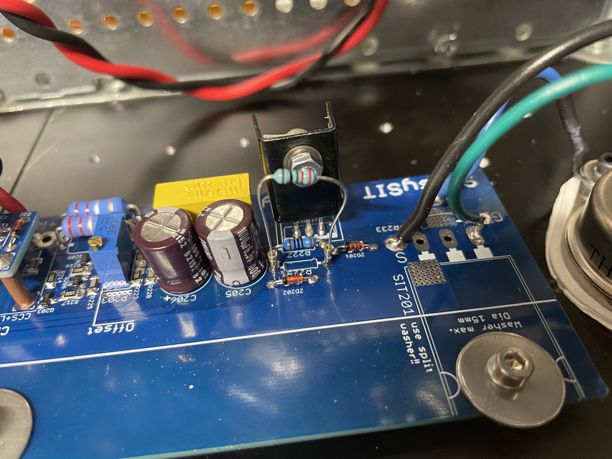

I swapped in a 150R level shift. Pot at minimum. Current too high. Forget exact value. Swap 180R and lowest I can go is 2A2
Other channel with 120R, lowest Iq is 2A4
Should I increase Level shift some more? 220r? Parallel the 1k smd resistor somehow? Or short it and crank 1k pot up to 900r or so?
221R in sockets. 1A73 Iq.
I will install sockets on other channel tomorrow and get it adjusted. Then work on front end setups, then cook it and final adjustments.

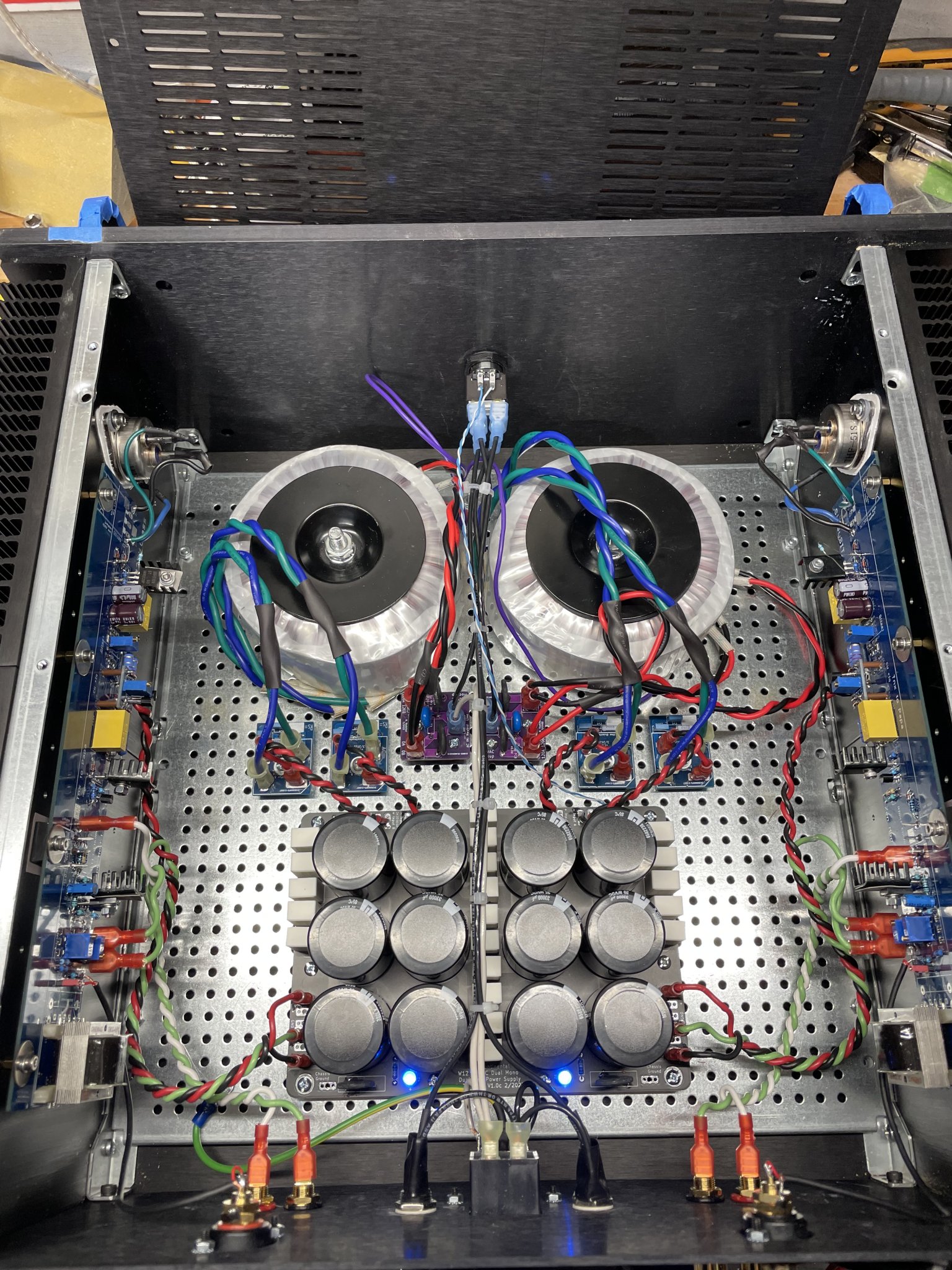

The amp is cooking. I had 220R level shift resistors and biased to 1A8 / 0V offset. After cooking for 90 minutes the bias crept up to 2A0x and 1A9x. I coudn't get back down to 1A8 with pot at minimum, so I put in 240R resistors and adjusted them to get 1A8 / 0V offset. Now I'm cooking some more.
Donuts are rotated to "null point" and tightened up. Bottom cover & feet are installed. This one will be on big speakers soon!
You asked for some measurements. After adjustment and with the heatsinks warm - here are the voltages measured from SPK+ to the measurement points:
Left channel:
SIT Gate: 3V4
IRFP9140 Gate 4V4
IRF510 Gate: 5V55
Right channel:
SIT Gate: 3V4
IRFP9140 Gate 4V4
IRF510 Gate: 5V57
In comparing the bias mechanismus between the original Rev 1 SissySIT and this 42 version I can see the offset is much more rock solid. It doesn't dance around. Nice work!!!
