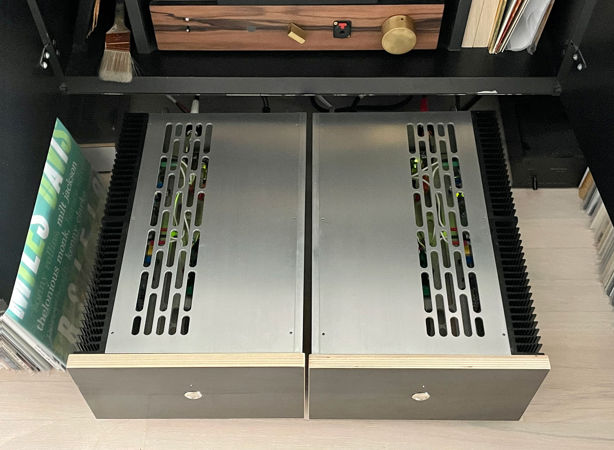

Hmm... the F4, A2s, D70-II, A5s, F5, etc.. all sit there forlornly.
I even drove it into the Maggie 1.7s... which amazed me. Though mostly, like 99% of the time, I got it hooked up to the Audio Note AN-K/LX speakers with Entec woofers.
This is a seriously good sounding amp. Almost the amp for a Desert Island.
So good I upgraded the preamp from a CJ PV9 with teflon caps to a CJ ET3SE. The amp is definitely in the groove.
Right now I'm playing Yesca off Tidal Hifi...
.. and having a shaken vodka martini.

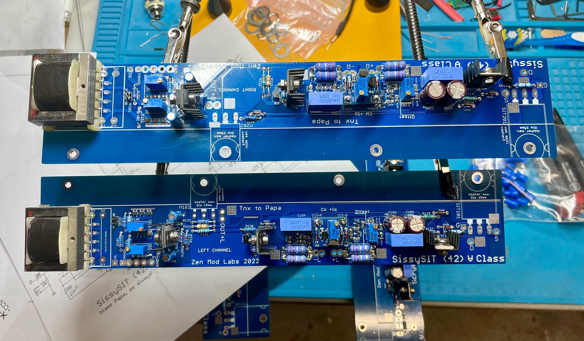

This will be my second attempt at the venerable SissySIT... Pretty sure the issue with version one was some poorly matched SITs (repeated failure of the right channel)...now ZM has these new-fangled boards for naughty parts and more options. The chassis I originally made became J2 Babelfish (WOW amp)...now I have these other ultra compact 4U monos chassis I gathered parts for and designed over 4 years ago (with 6L6 input).... so... putting them together now and making 2X SIT creatures....

ZM—floating around the Scryer thread....would you say I should solder in some sockets for the shifter resistor positions on Sissy? I will be using the same SITs as Scryer....start with same value as what I ended up with in the Scryer amps? Pure luck that I was able to swap those resistors w/o taking the boards off the sinks...I used my laser vision.
yeah, advisable to use 1pin sockets for level shifter resistor

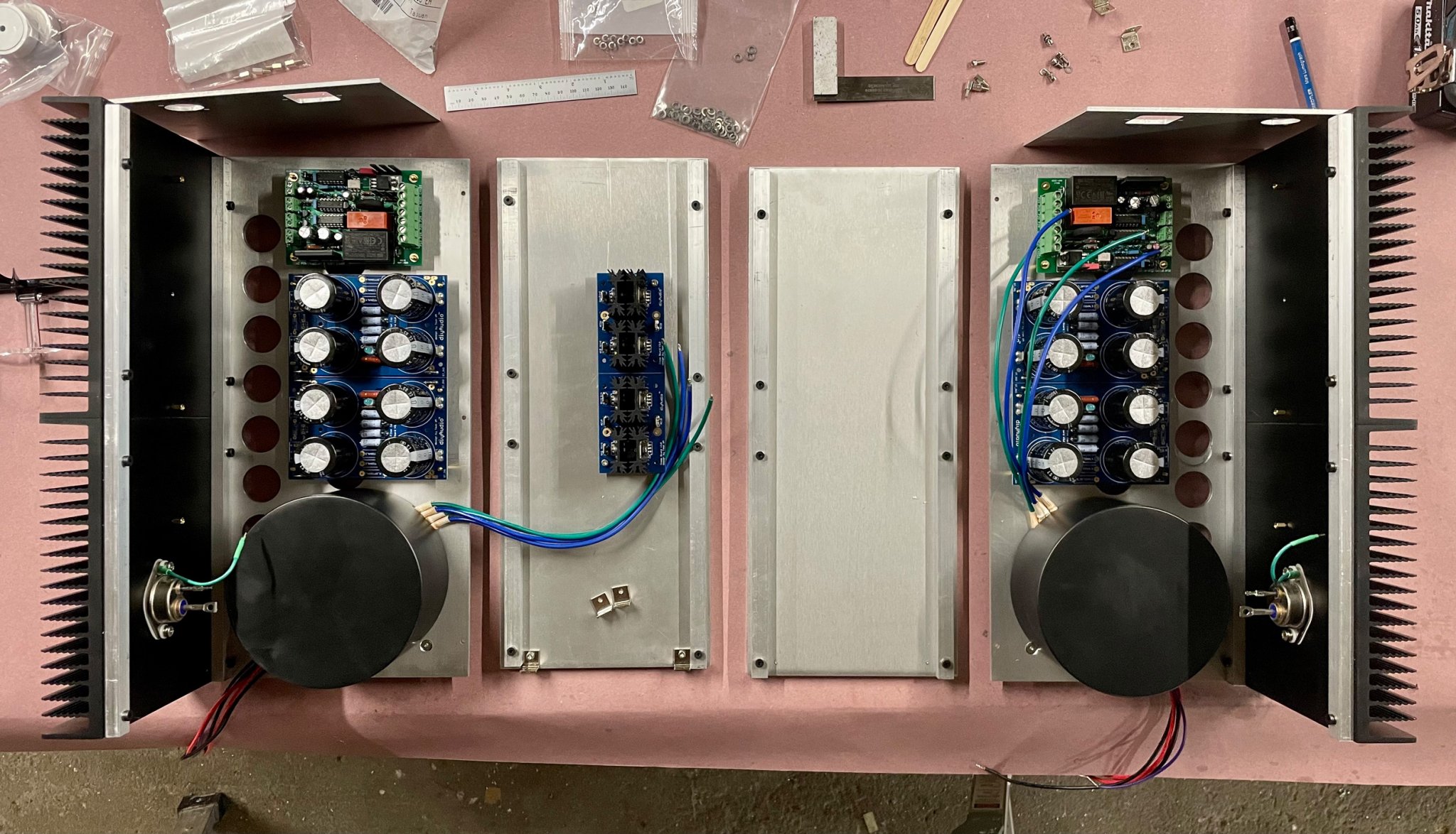

I reported the dramas in the other related threads... but I'm working on slight chassis retooling—bettering some earlier mono chassis (the ones shown above now have Babel/J2 in them), have to move the SITs a bit to avoid the trafos...I will be using HA! PSUs (both built)...and may add some motor runs (in hand), since why not... So, they are definitely coming, and I'm eager to hear them.
(And as it turns out, links just above, I don't think the first SIssy failure was due to SITs, but rather undetermined PSU issues).

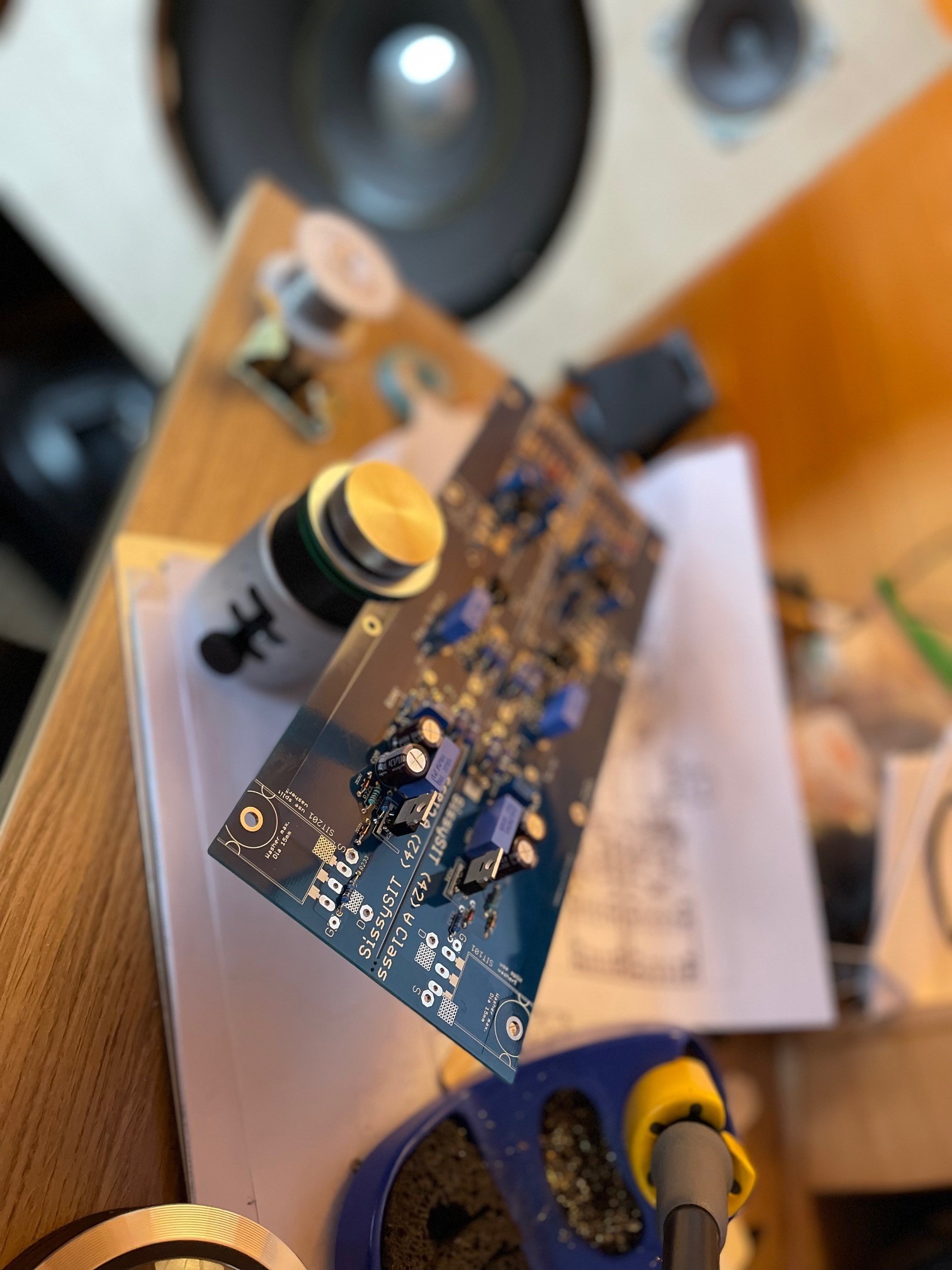

Bustin' out for Rosie. New S42 build commenced, thank you very much ZM for provisioning your lovely kit. So far boards are nearly completely populated.
First problem:
I think I ooked up P201, manhandled it upright after soldering and may have internally damaged. It does not read correctly across R204 (0R2) vs. R104 (30R). Measuring the trimmer leads from under the board I see inconsistency between P101 and P201.
In reading the numerals imprinted on the top of the trimmers, looks like correct replacement is:
https://www.mouser.com/ProductDetail/Bourns/3296Y-1-101?qs=zLmgxZuhK3VQC8bel0o6gg==
Do I have that right? I will uninstall P201 measure it and report back.
Jim
