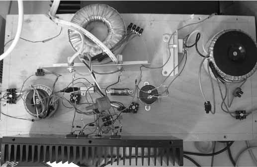

Amp idle current set to 1A, Mosfet Source to Gate voltage 4.75V,
[/B]
I have just completed a MOSFET amp with 6 IRFP240/9240's on the output. I found 7 volts bias was needed to get rid of crossover distortion which was very severe without any bias.
The bias current wasnt set to a particular current but just enough to get rid of crossover distortion.
Please dont just set your bias to the same as mine as it could be enough to blow your output stage.

Re: toroid amp picture
Thank you for your postings and informative feedback.
lissitzky said:
A picture of the amp build on a piece of wood.
Ah, thanks for that. Make matters a lot clearer.
I think the Bass problem is from the use of the toroid transformer as a center tapped inductor.
While this works, it is not ideal as there is no impedance transformation which one gets with a proper transformer. I think that there may also be some thermal cycle distortion mechanics also, but that is something I am trying to set up to look at (I need a fast response pyro IR detector which are not cheep).
The use of a mains toroid as a full transformer with the mains primaries connected to the mosfet again isn't ideal as the windings don't couple well at higher frequencies and they are inherently unbalanced.

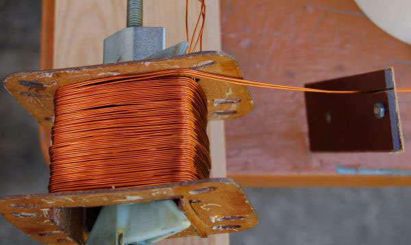

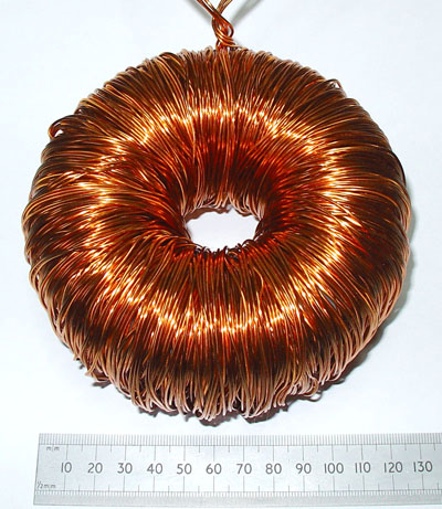

The simplest to make is using a 300 to 500 VA core recovered from a regular mains transformer and then tri-filar or quad-filar wind about 200 turns of 1.00 mm magnet wire.
Quad is preferred since I like to have an effective heavier gauge of the pair for the output, but does make the winding a little harder as there are then four wires, each with a mind of it's own, that one is trying to persuade to go neatly around the core.
One can make up a winding spindle from a length of aluminium tube, something about 18" long seems a good compromise between wire length and manageability.

Attached pic is of my first hand wound torroid, with quad-filar 1.00 mm wire.

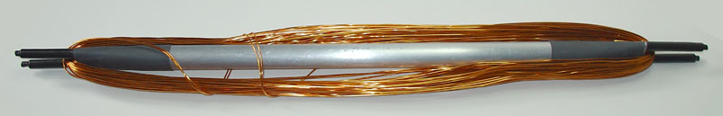

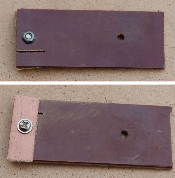

Toroid winding spindle
Here is a pic of my new improved toroid winding spindle which I made up from a length of aluminum tube. It is 18" long, and the ears add about 2" both ends.
The first toroid was wound with a smaller spindle about 12" long that I made from a length of scrap 1/8" thick Tufnol I had to hand, but the "ears" were not strong enough and one broke off part way through winding!
BW,
Susan.
