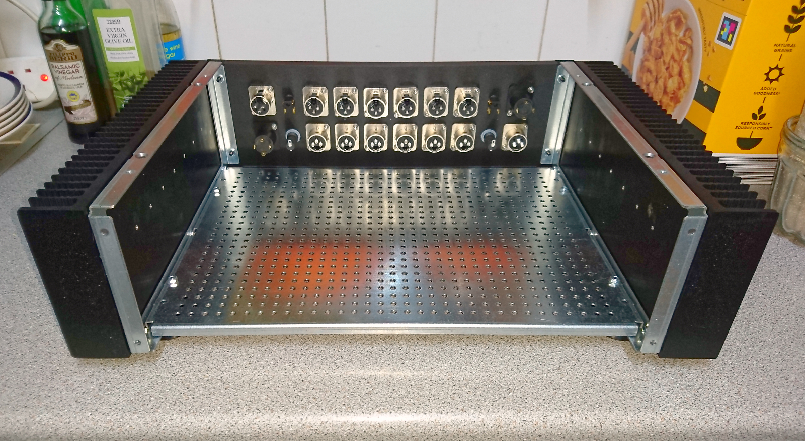

Electrical wall boxes with gland plates, for example:cheap parts for amp cases that don’t require too much reworking
https://www.rittal.com/com-en/products/PG20231215SCH101/PG20231215SCH201/PRO70535?variantId=1535000
... which is the one I used for my original preamp.
For the ones I used in the new amps the boxes only have one gland plate. The back side needed cutting out to expose enough heatsink area to mount the MOSFETs, but as it isn't visible it doesn't have to be perfect. I have a Bosch nibbler for this sort of thing. It's a fearsome beast, but munches through the steel with alacrity!

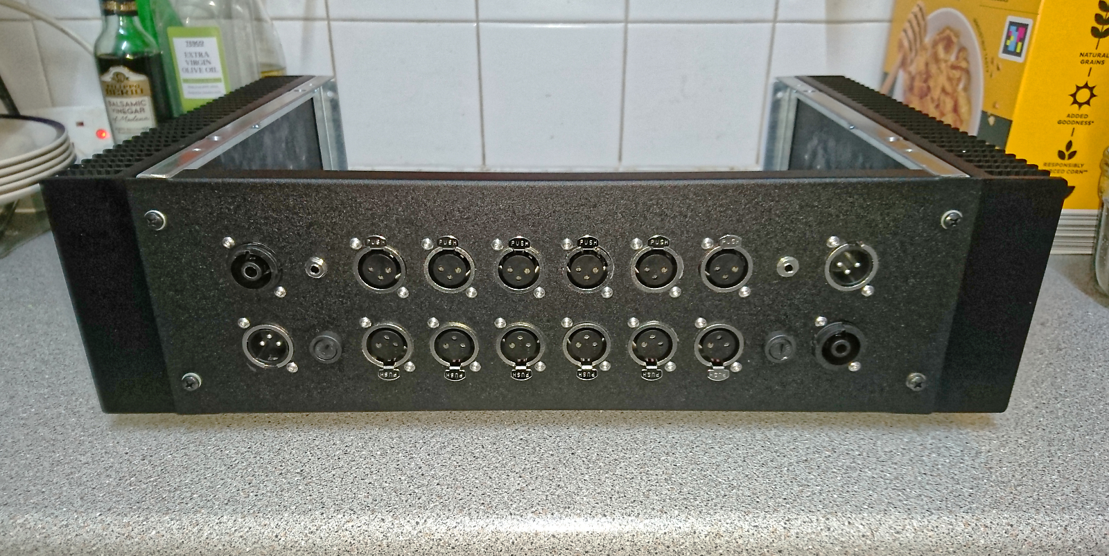

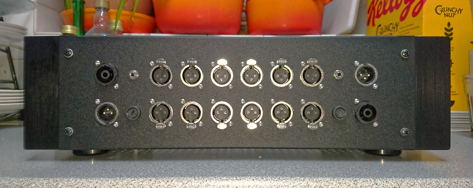

Progress with my new Pre-Amp/Line-Driver chassis... the rear panel cutouts and the drilling for the two heatsinks is done and I have been able to put it together for the first time this evening.
I very much doubt I will use all seven M3 mounting points on each heatsink, but easier to put them in now and use as required.
Next up is the front-panel which will need a bit of thought as to the layout. Fortunately I have a couple of "rough" aluminium plates of the right size so I can try out the arrangement I have in mind before committing to machining the actual front panel piece which is already anodised.
N.B. It is being built as a dual-mono hence the two Cliff power-connectors and fuse-holders.

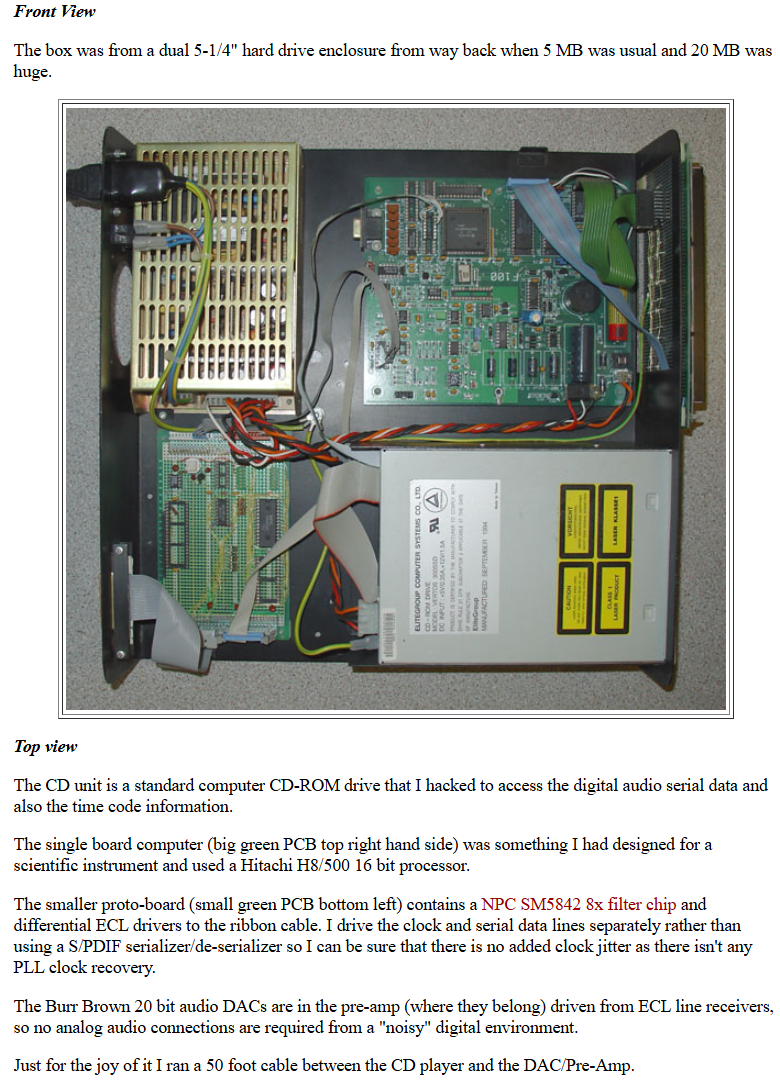

Speaking of which... I think your CDP is as brilliant as your amplifier topology:
DACs are PCM63s?
DACs are PCM63s?
PCM1702s...DACs are PCM63s?
https://www.sowter.co.uk/dacinfo/PCM1702.pdf
... the only DACs that are better are the PCM1704s!

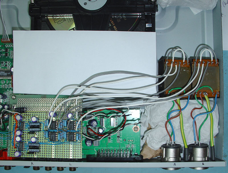

The best alternative (to my ears) I have found are the PCM1794As in dual-mono mode - as in the pic below which is my OPPO980H upgrade.
I initially suggested 1702/04s, but changed this as I thought these chips were not available at the time you built the CDP.
179.. series are indeed among the better (sounding) ΔΣ DACs. Some people seem to believe that DAC chips inherently have very little sound signature and that implementation matters (most). While there's some truth to that line of thinking, I have yet to hear an ESS DAC that I actually like (and I own several).
Original 1702/04 chips are still offered for sale, but usually cost > €100 each.
I bought some 1704 chips a decade or so ago, but I am pretty sure they are fake.Original 1702/04 chips are still offered for sale, but usually cost > €100 each
