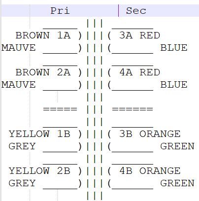

Okay, this is from my email correspondence with Brian Sowter in 2004:
Suggested wire colours?
Pri Sec
_____ ||| ______
BROWN 1A )|||( 3A RED
MAUVE _____)|||(______ BLUE
_____ ||| ______
BROWN 2A )|||( 4A RED
_____ ||| ______
YELLOW 1B )|||( 3B ORANGE
GREY _____)|||(______ GREEN
_____ ||| ______
YELLOW 2B )|||( 4B ORANGE
Sorry, it's ASCII art and will need reformatting to line things up.
I don't know if Sowter turned the bobbin round for the second section, or just carried on winding.

P.S. I fixed your drawing and attached it below.

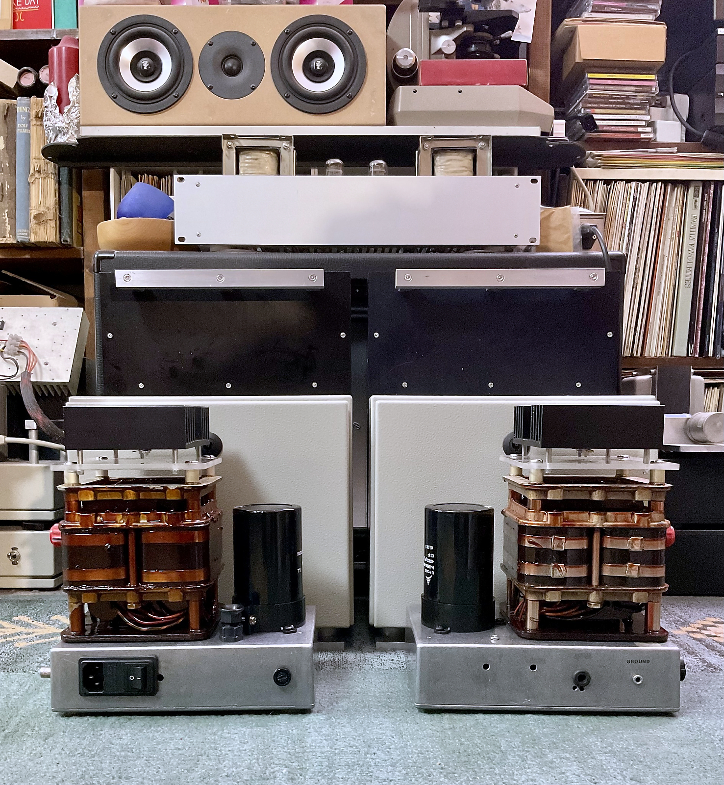

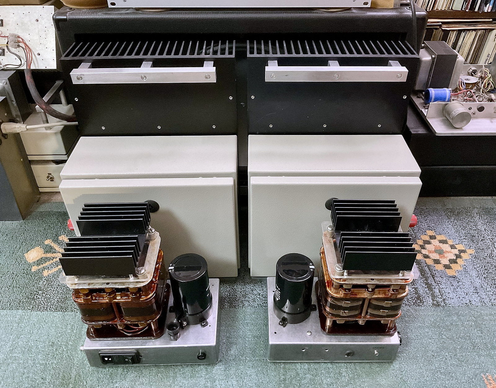

New amplifier project progress:
Finished the metalwork (i.e. making holes) for the power-supplies for the new power-amplifiers, and mounted all the major components.
The Parsonage c-core transformers were also purchased in 2009; their secondary is specified at 32V 10A RMS.
Not yet wired up, and I have to assemble the current-regulators (which go on the heat sinks).
The aluminium diecast boxes and heat sinks are repurposed (i.e. saved from WEEE) so have the odd extra hole in them.
I'm gonna wing it 🙂 My spidey sense says that it's straightforward and pretty layout insensitive (but I definitely can be wrong). I think that the key is getting the output transformers correct. I'm toying with winding my own, but may bite the bullet, save some time and get the Sowters.
I have a dead power amp chassis to build the amp proper into, and likely have something to put the power supply in as well, so have a decent starting point. I know it's recommended to have the amps next to their respective speakers, but I'm hoping I can mount these a short distance away and make up for it with better/bigger cables.
Reactions: Susan_Parker

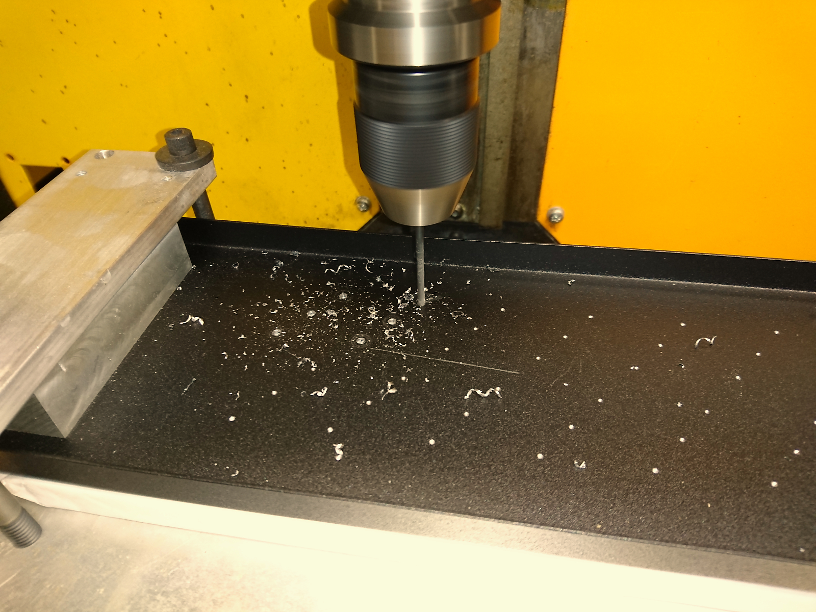

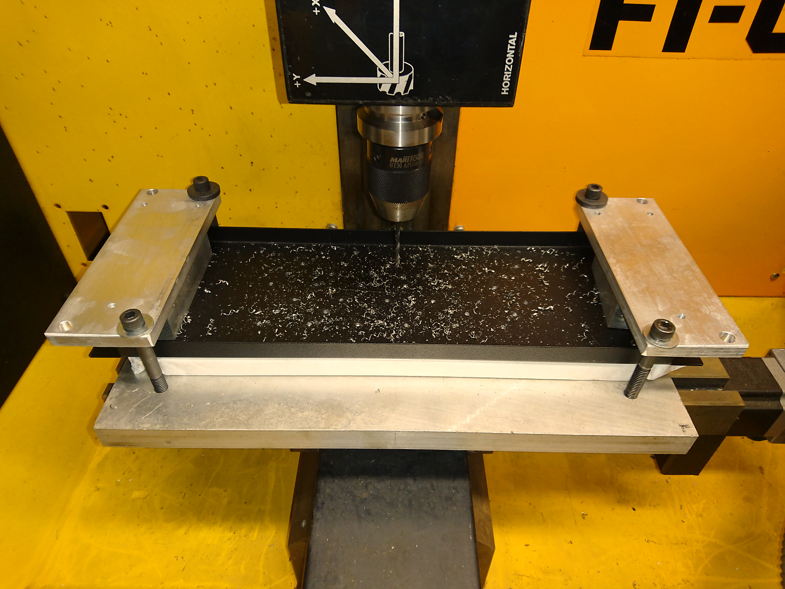

Today has seen some progress on the next part of the new system; started making the holes for the new preamp's rear panel - in this case two rows of XLR connectors for the inputs. As it's a 1mm steel panel I can use a punch to open out the main connector body holes.
My Emco F1 CNC milling machine only has a 200mm x 100mm working envelope, so I will have to shift the panel left and then right to get in the holes for the other connectors and associated parts.
I first used a center-drill to spot all the hole positions, then drilled out the holes on a seperate pass.​
