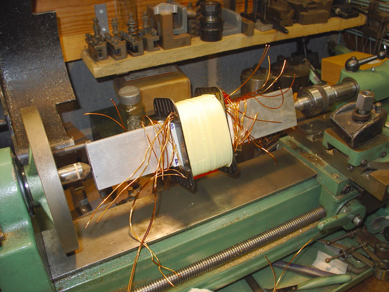

but I'm curious what the reason would be for partially hand winding the output transformer?
The line-driver and power-stage output transformers are completly wound by hand by preference - from experience commercial machine winding bi-filar and quad-filar is not capable of putting down the layers without crossovers in the winding process.
In my case I use my lathe to hold the bobbin on a plate and hand crank the spindle to turn, see pic.

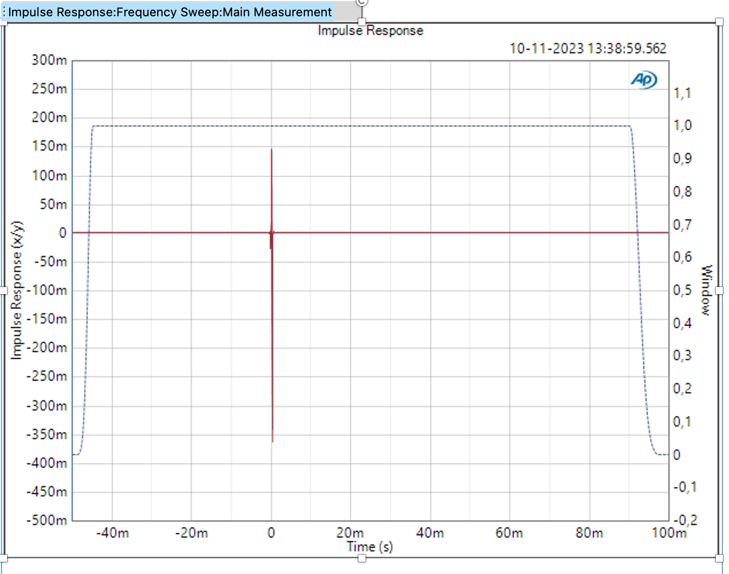

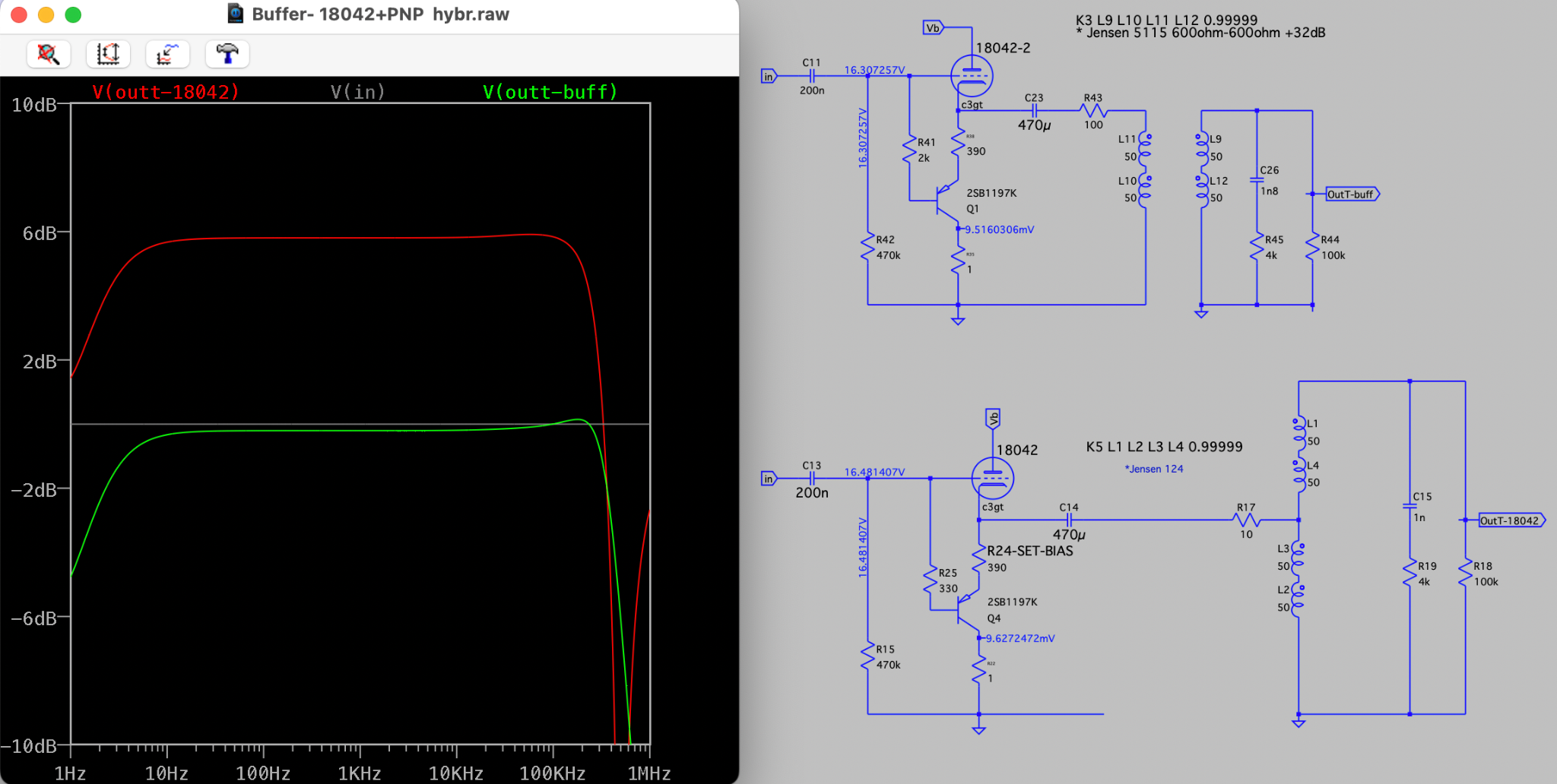

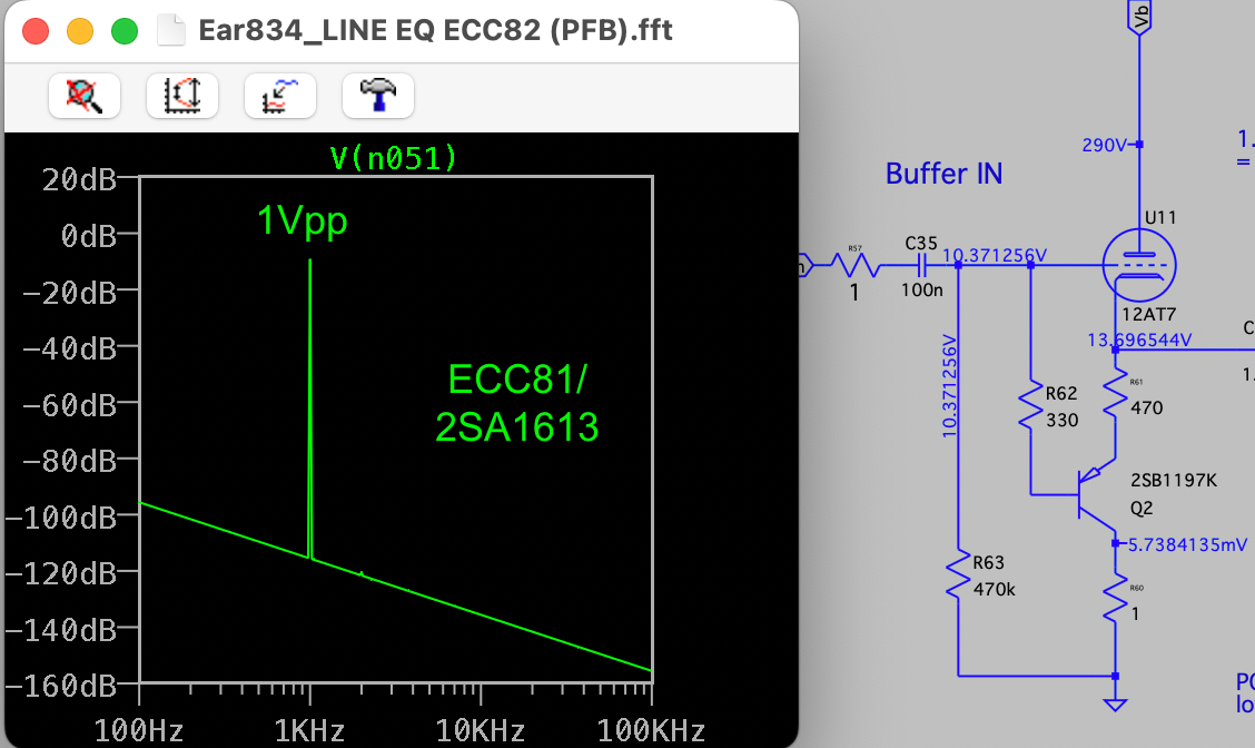

Susan, if I may? Something like this Triode-PNP hybrid follower? The distortion depends mostly on triode. The simulation flatters maybe, but still. . Output is 'low enough' for a transformer.
Impedance is fairly constant. [Made with 18042 as a test project for ETF'23; requirement was loading to a 600Ω output]. ECC82 is slightly different. ECC83 is great too. Just compare in vivo.
I am currently using such a stage without transformer : as a buffer after my 50k potmeter. The impulse and low level field presentation are astonishing of this hybrid. The input is self-biassing: the base current, ! Every small change in the coupling cap can be appreciated.
Nope.

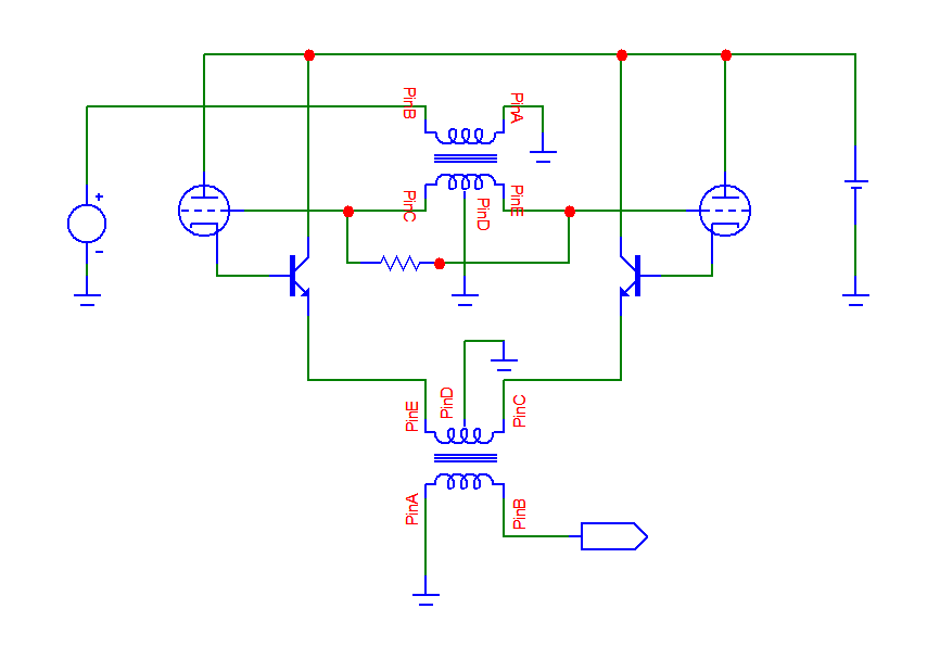

Fine to see your circuit simulations, but it is not my transformer/follower/transformer topology - see schematic and pic.
Tube is 7N7, Loktal version of 6SN7, BJT is 2SC5200.
Heaters powered by a PTN78060WAD non-Isolated DC/DC Converter with slow-start circuit.
B+ is +24V from a separate AC/DC supply.
Input-transformer is Hammond 124B, output-transformer is EI-96 quad-filar wound 0.8mm magnet-wire.

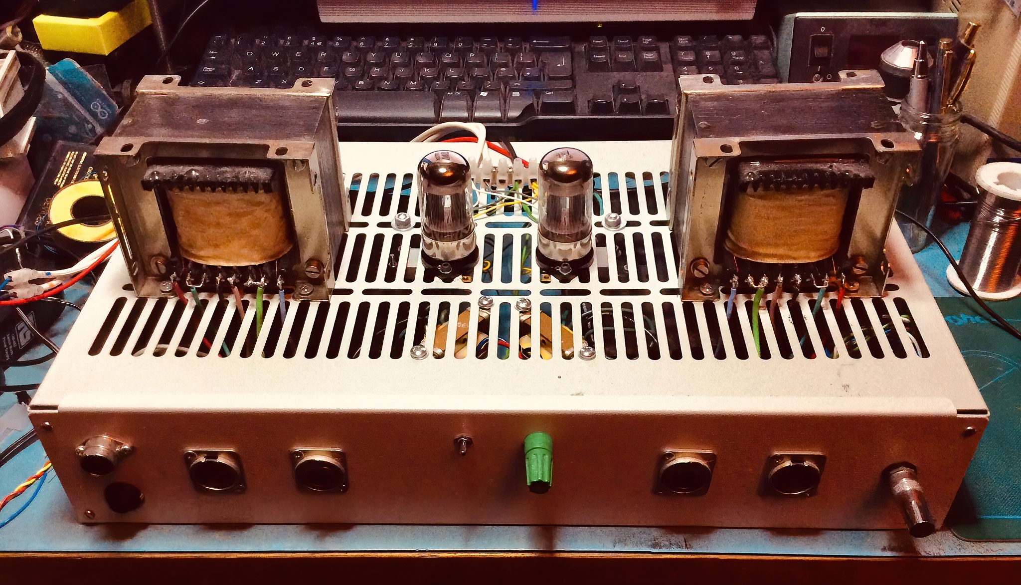

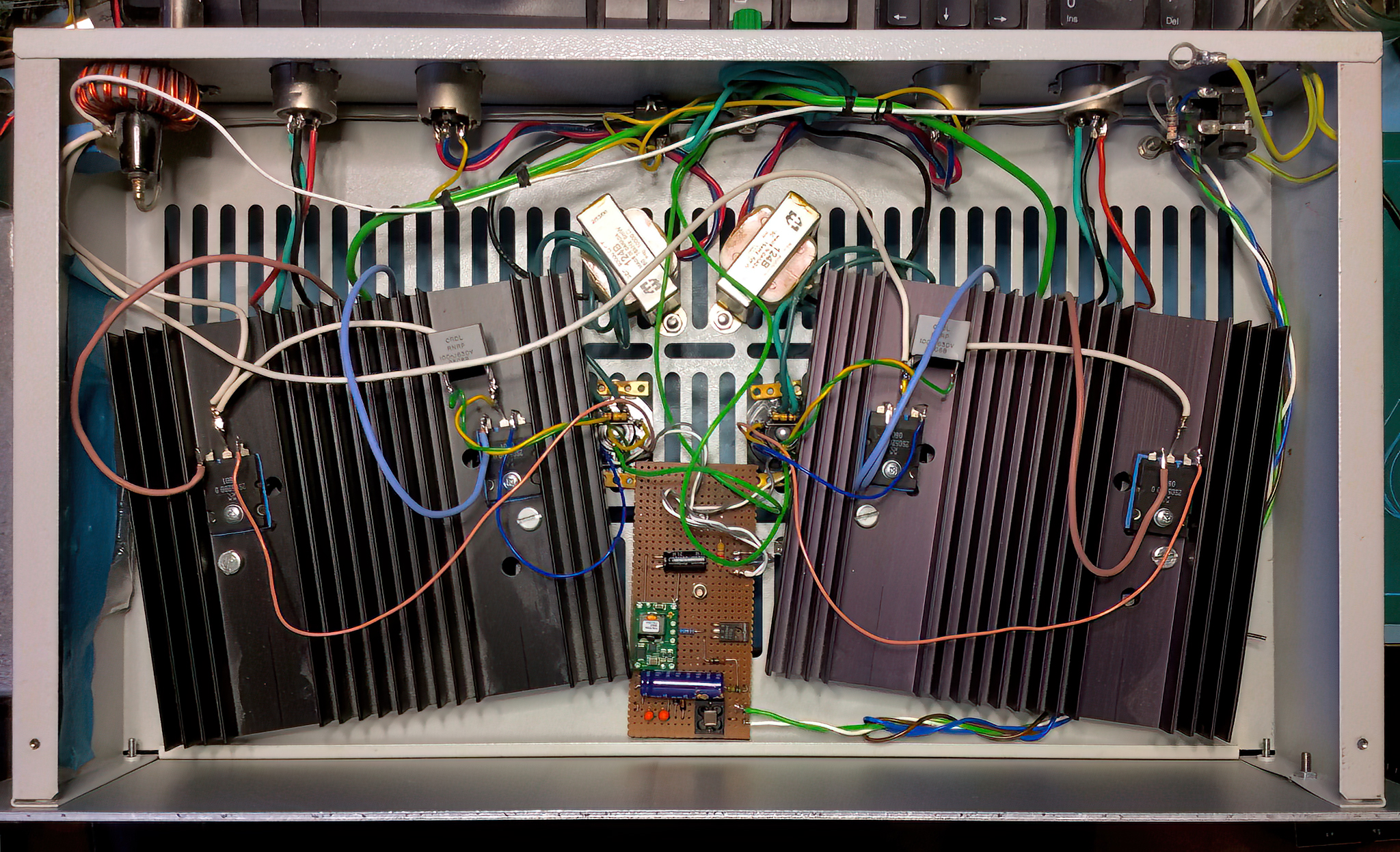

Schematic of Bipolar-Triode Hybrid line-driver​
Inside view of the Bipolar-Triode Hybrid line-driver, in daily use as part of our 5.1 setup.​
Rear view of the Bipolar-Triode Hybrid line-driver, in daily use as part of our 5.1 setup.​

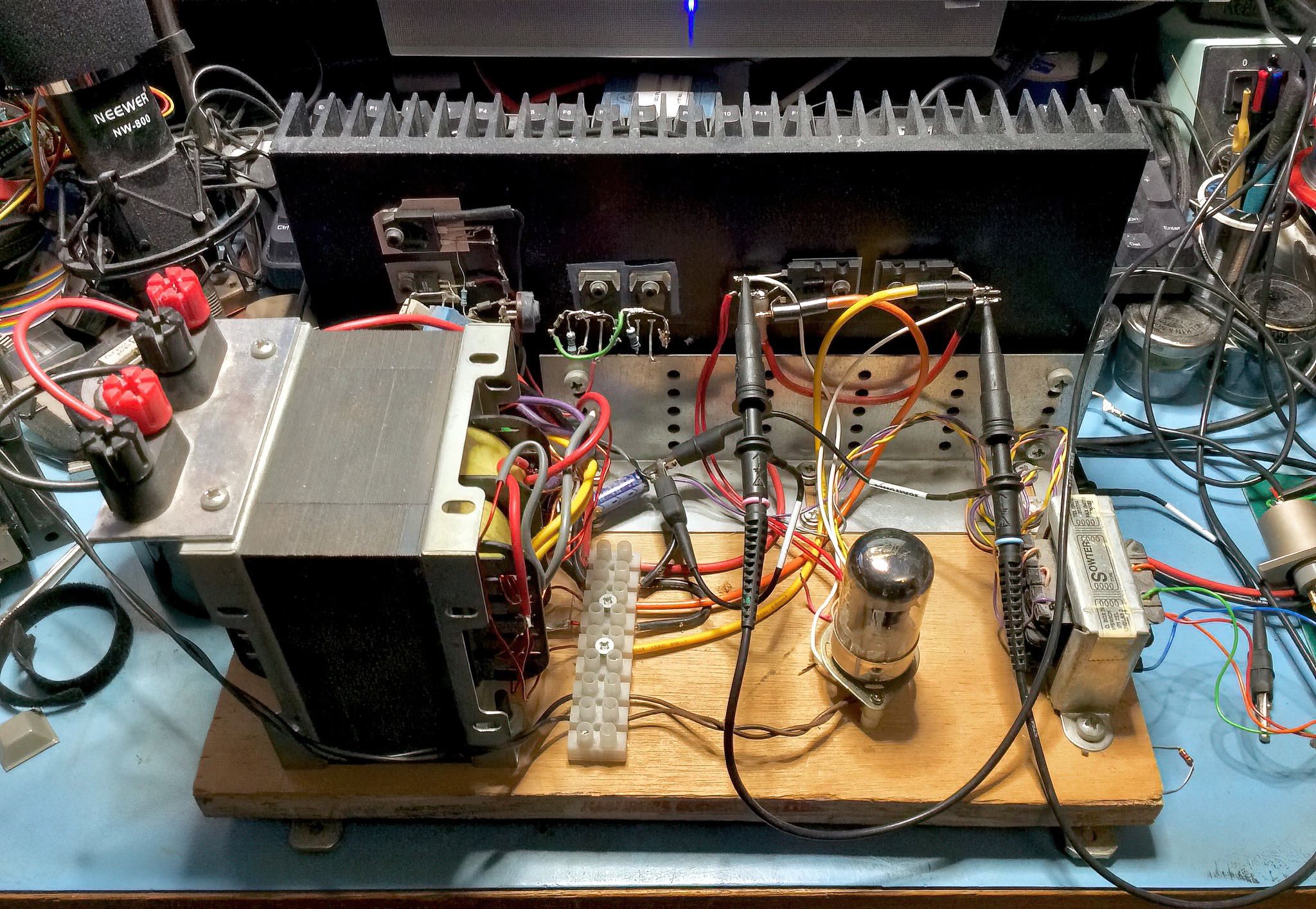

This is my current test-setup with a 7N7...

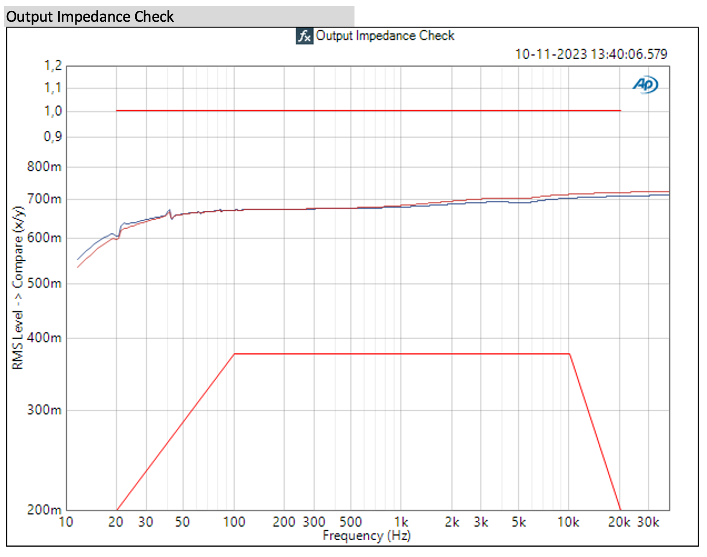

Here is my analysis with estimates.
4:1 Standard
Sowter 9840 OPT
2:1 Standard
Sowter 9840 OPT
3:1 Hexa-filar wound 3:1 Extra primary windings,
Standard 2:1 output wiring.
As proposed in the above post.
Total output impedance 0.257 Ω 1.03 Ω 0.456 Ω 0.62 Ω
Damping factor 31.2 (8Ω)
15.6 (4Ω)
7.8 (8Ω)
3.9 (4Ω)
17.54 (8Ω)
8.77 (4Ω)
12.82 (8Ω)
6.41 (4Ω)
Average power output (best-case for 48 V DC supply) 33.8 Watts into 8Ω
63.6 Watts into 4Ω
113.1 Watts into 8Ω
182.4 into 4Ω
57.3 Watts into 8Ω
103.1 Watts into 4Ω
63.2 Watts into 8Ω
110 Watts into 4Ω
Turns ratio 4:1 2:1 3:1 2.8:1
Impedance ratio 16:1 4:1 9:1 7.84:1
Secondary winding configuration Four in parallel,
none in series
Two in parallel,
two of those in series
Three in parallel,
Like 2:1, Two in parallel,
Relative distortion levels Lowest Higher In between, probablyIn between, probably
Bias current commentary for a given idle dissipation Tends to stay in Class A the longest, but high rail voltage requirements limit bias current.
Potentially not the best compromise but offers the best damping factor.
Tends to move into Class A/B the quickest due to highest primary currents. Could tend to stay in class A comparably to 4:1 after increasing the bias current and lowering the rail voltage accordingly for the same power output.
- Or, a higher power output can be chosen and move into class AB a little sooner.
- Potentially closer to optimal but can only be considered if the damping factor is acceptable.
Ditto, as with 3:1.
For the hexa-filar wound case, an assumption was made that more coils compensates for fewer turns per coil in order to fit within an EI-120. That is, the primary-side resistance is the same as for a Sowter 2940.

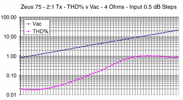

One thing to note on distortion (from measurements I did a long time ago with my HP8903B Audio Analyser), that after exiting Class A in PP the distortion flatlined until the primary-followers approach the power-rail.
Yes. That flattening has always intrigued me. The flattening surely was after exiting Class A. Just now I became curious about how far after exiting Class A and so I looked up some of my previous work from back in those days. It shows that a Zeus 2:1 idling at 750 ma exits Class A at 4.68 volts (1.37 Watts into 8Ω). That would be just past half way toward flatlining, right in the middle of the above graph.
If indeed the crossover point happens in the middle of the graph, then the implication is that crossover events are relatively insignificant in a Zeus. Audibly, I can confirm by ear that lowering the bias current is hardly noticeable. (I still crank it though.)
What hypotheses have floated which could explain the flattening?
Here's one: The flattening occurs deep into the square-law curve of the MOSFETs. Being far into their square-law curves, a MOSFET pair from the same tube and with similar idle bias traits (where you selected them) tends to match where the flattening begins. Either the curves become linear, and some MOSFETs are known to go nearly linear (early HEXFETs), or the curves become true parabolas and the difference of squares is linear anyway. Hence, at that point, something close to no new distortion is added. And after that point, maybe it is only proportional distortion added by the transformers, remaining at 1%.
