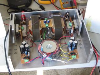

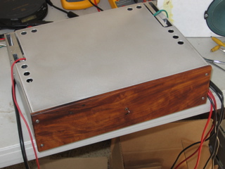

Thank you. It's actually more of a current feedback loop, but it does serve to prevent the current from rising as the temperature of the radiator rises. I'm kinda proud of it, as I don't have the training or experience to develop more complicated stuff.
Here's a shot of the assembled amp - completed casework tomorrow.

Ok, finally plugged it into the main system. I have it running the horn from about 1200Hz on up. Sounds very nice. Some more experiments on circuit variations to come (may have to make at least the appearance of progress on a few projects around the house first), but a few comments.
If you have a low impedance source, this is a great amp for high efficiency speakers. I had a little inductive hum when I put everything in the case and fired it up the first time. But by turning the power toroid some, that completely went away. No hum or noise whatsoever. You can stick your head inside the horn and hear nothing. This, with a very simple power supply. Also, no thump or click on power up or power off. And no chance of DC on your driver.
If you want to use it full range, you want to make sure that the input transformer has sufficient inductance, per Steve Eddy's comments earlier, to provide adequate input impedance for your source at those frequencies.
I haven't measured with a scope yet, but I calculate that I should be able to swing about 10Vpp (7Vrms) at the output, so about 6 watts into 8 ohms. Seems about right in my system, based on the output of my preamp.

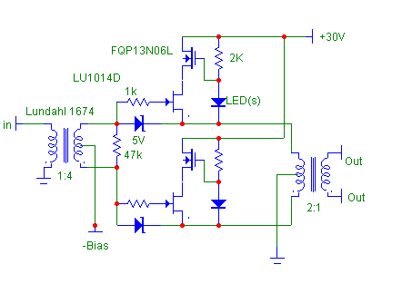

Yes, I have looked at the Z9. Even though this amp does no voltage amplification via the cascode, I think the schema biasing the MOSFET should work with some modifications. As I wouldn't use the top part of the power supply, some way of filtering the raw B+ would be needed. Or could use a small separate supply. But, as this is partly a mental exercise, how about something like this?
Would probably need two LED in series to get the bias voltage needed, or maybe an LED and some diodes.
Sheldon

> But, as this is partly a mental exercise, how about something like this? Would probably need two LED in series to get the bias voltage needed, or maybe an LED and some diodes.
Looks OK.
There was a post some time ago on noise measurements of LEDs vs Zener diodes. And the zeners were surprisingly good. Since then I do not bother with LEDs anymore. Just current source, Zener, with a 100uF cap across.

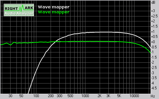

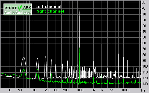

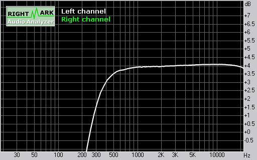

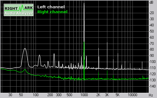

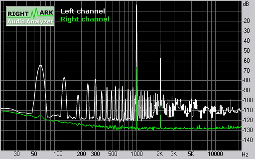

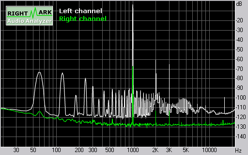

Just for completeness, the frequency response driven by the PP amp:
What is evident from these quicky tests, is that the Zeus is highly dependent on the driver and transformers. You can see that the distortion is high when driven by the soundcard alone (M Audio Transit). But when driven by an amplifier with presumably much lower impedance, the distortion profile essentially matches that of the amplifier alone. So the Zeus itself, as Susan has stated, will reflect the character of the driver. I didn't test it with my preamp, as I didn't want to drag it out of the system, but I would expect it to give low distortion as it has an output impedance of 75R.
The frequency response is a function of the input transformer, as you can see by comparing the response of the soundcard driven Zeus vs. the pp amp driven Zeus. Note that the response at the high end is good. The slight additional roll off at 20kHz of the PP amp driver reflects the response of it's OPT's. For my present use as a tweeter amplifier, the roll off at lower frequencies is fine. But if it were to be full range, a different input/splitter transformer would be in order.
Note: white is the Zeus/pp response, green is the pp response
