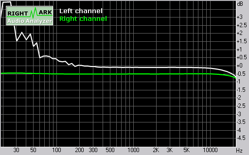

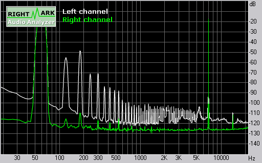

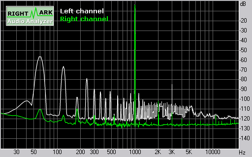

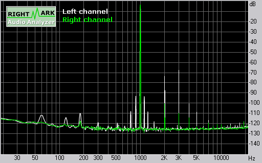

better measurements for the jfet version
Those measurements on the previous page were faulty, due to a toasted soundcard. Here are some better ones. First, frequency response. I should note that I'm using the amp above 300 Hz, and have gapped the OPT's, so I purposely focused on response above that in the design. The green trace is the soundcard control:

By the way, even those recent measurements were faulty. New sound card, but noisy set up. Cleaned that up. I also added a buffer in line with the sound card. The input transformer likes a lower impedance drive than my sound card allows.
