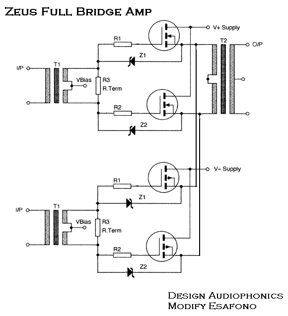

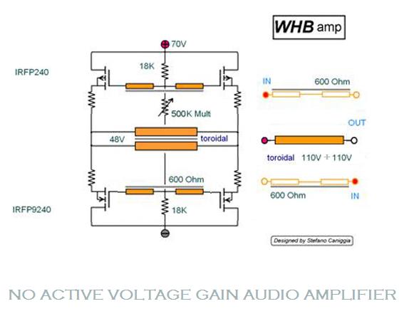

Zeus FULL-BRIDGE
thanks Kalus
there is another good plus about balanced Zeus:
you can have AB biasing and the sound of A class amplifier
because N and P channel working togheter
I have to drawing it better... (bias resistors are wrong)

thanks Kalus
Thanks Stee,
Would you draw it again, please? As I said I'm in the process of building the Zeus and may well give this circuit a go if there are advantages - I have 4 pairs of matched IRFP240 & IRFP9240.
What are the requirements for the output trafo - same as the Zeus?
yes exactly the same but symmetrical
