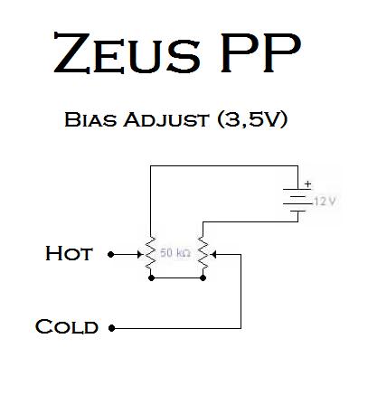

adjusting bias on Zeus Full Bridge
hello
just a double potentiometer for PP biasing
don't need:
1- class A bias - set around 7V gate to gate
2- ground (no dual power supply)
3- special output transformer - it's ok a toroidal PSU with secondary as primary and viceversa (no active VAS)
hello
don't need:

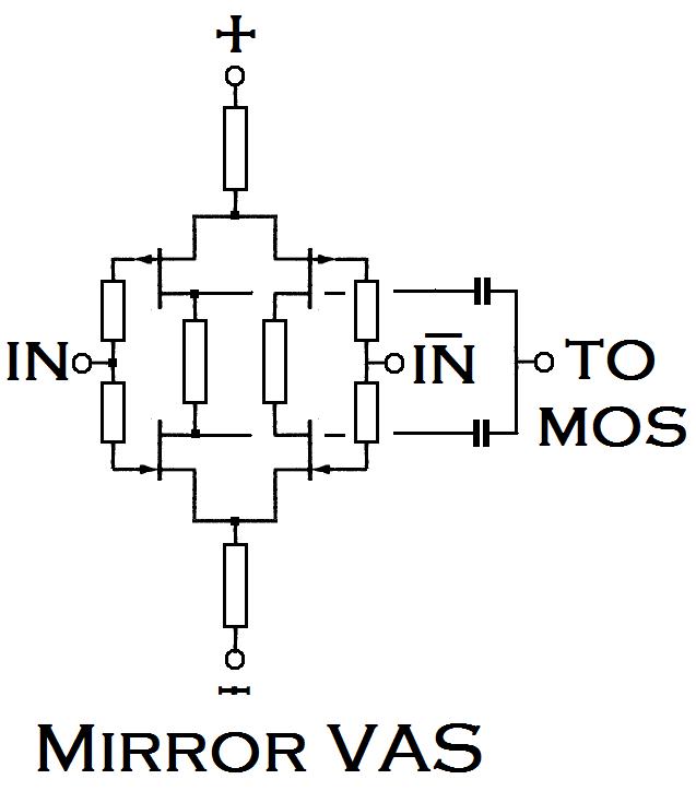

ciao
I'm not convinced an output transformer is required too.
Can the design simply have a natural sound in VAS?
My idea is that critical VAS need a mirror for better accuracy
so the input mirror must be VAS in the same time...
see this drawing
imaging 2SK170/2SJ74
then need just little hexfet in current (common surce) like IRF610/IRF9610 + last stage with big bipolar (common emitter)

susan's amp
I think one of the major keys to the great sound of this amp is that it has extremely low noise. Any noise generated by the supply ( of which there will be a lot ) is almost perfectly cancelled the almost perfect symmetry of the windings of the transformer or choke.
So if ur planning to eliminate the transformer / choke then I guess u have to figure out if u can think of an equally good way of keeping the noise down at such sublimely low levels.
Susan's passive VAS will have almost no noise, the cct you showed seems to have a lot of resistors. In my experience resistors, unless they are very expensive types, sound dreadful.
So my guess would be that the resulting amp would not sound as good as susan's - which I have heard - but, of course, I might be completely wrong.

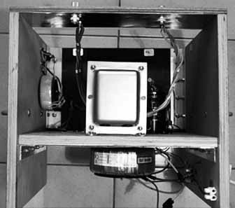

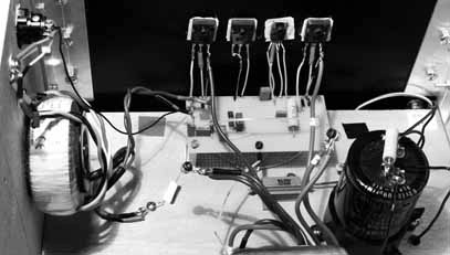

Monoblock Finished
I have now finished to assemble two monoblocks using toroid input transformers for now (2x115, 2x24V 30VA input toroids terminated by 10K in series with 1nF) and dedicated Sowter 9840 output transformers in a 4 :1 configuration. Connection of the primaries of the latter was a bit puzzling since I got very little output and distortion when connections were made as indicated in http://www.audiophonics.com/images/schematics/zeus-sowter-1stage-1-600.gif (???). Problem was solved when primaries of each of the bobins were connected in series (#6 with #7 in the above figure) or as indicated in post # 1166 which is now the definitive arrangement.
The amps now drive the 30R fullrangers fluently : Bye-bye bass distorsions (no postcard please !). They are the amps for the rest of my life ! Program : buy their dedicated input transformers and build the line driver which should be : S&B TX102 (+6dB)> buffer (Jisbos probably) > Lundhal LL1684 (phase splitting) > STP55NE06 mosfets based mini-Zeus (http://www.susan-parker.co.uk/zeus-line-driver-1.htm) > Sowter 9840 1 :2 may be asked to be wound with thinner wires since ref 9846 for T2 has disappeared. Thank you Susan Parker for sharing this excellent invention and for your support.
Re: Monoblock Finished
Nice! Yes, that figure always confused me. As drawn, the primaries appear connected in antiphase from one side of the split bobbin to the other. And yes, the amp does require a low impedance source.
Sheldon
lissitzky said:I have now finished to assemble two monoblocks using toroid input transformers for now (2x115, 2x24V 30VA input toroids terminated by 10K in series with 1nF) and dedicated Sowter 9840 output transformers in a 4 :1 configuration. Connection of the primaries of the latter was a bit puzzling since I got very little output and distortion when connections were made as indicated in http://www.audiophonics.com/images/schematics/zeus-sowter-1stage-1-600.gif (???). Problem was solved when primaries of each of the bobins were connected in series (#6 with #7 in the above figure) or as indicated in post # 1166 which is now the definitive arrangement.
Sheldon
