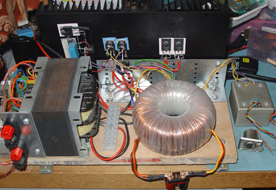

Toroid Output Transformer
Hi jkeny,
Yes, since we are running the mosfets in "analog" mode anyway.
Thanks. Seem to have missed a few posts recently
Have a job since last May, which keeps me busy.
I did build myself a couple of toroid transformers, will be putting up a bit of info on my pages about that soon.
The LF response is better (was getting down near to 1Hz), but the HF response above 10KHz is not so good when measured into a standard 8 ohm load. This is due to coupling, which isn't as good as with the EL bobbin even with multi-filar winding of the toroid.
However since most speaker tweeters have a rising impedance with frequency, it is likely that with a bit of matching for the crossover values this will not be a problem in itself.
Whilst I have got some quotes and there are some potential savings to be made compared to M6 EI version, my ongoing interest is in working on double C core transformers rather than toroids.
Note I get about 2MHz bandwidth out of the Zeus PP final stage with my quad-filar wound EI transformer.
Best wishes,
Susan.

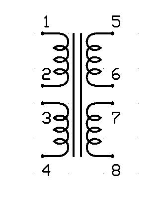

Hi Tyimo,
For the PP output transformer I don't use a gap. My EI laminations are fully interleaved in the stack with 1up - 1 down but could be groupled in twos or threes and that would be okay too if you have a ready made transformer.
Wit EI laminations one always gets a tiny gap, simply because of the mechanics of butting up the E and I sections.
I would recomend that you use the two output windings in parallel, which will give you 2:1 step down.
Note: 4:1 needs two sets of four windings, plus a lot of head scratching to get all the winding sections in their proper order - and yes, even I have to think about it when I wire up a new transformer for the first time
What size is your transformer?
Best wishes,
Susan.
Tyimo said:Some question about the OPT:
Is there any air gap?
If I have a Quad Filar wound OPT with similar windings (each winding = 155 mH ) how should I connect it 2:1 or 4:1 mode??
Best wishes,
Susan.

Tyimo said:It was not clear to me because on your:
http://www.susan-parker.co.uk/zeus-original-irfp150-pics-fft-1khz.htm
you wrote 4:1 and on the 35W OPT Specification there is the simple quad filar wound OPT:
http://www.susan-parker.co.uk/zeus-out-tx.htm.

Output Transformer for Ribbon Speaker
Hi Miro,
Don't worry, we all are learning. I have been working on these amps now for over 15 years
For use in a Zeus amp system I would recomend winding a custom output transformer with multiple secondaries that can be connected in parallel. It would be a bit more work, but would provide the best soultion.
Impedance is the square of the turns, so you would be wanting something like a 16:1 step down.
Best wishes,
Susan.
Hi Miro,
fivestring said:please forgive my ignorance, but when it comes to transformers I`am a complete moron. What type of output transformer would you suggest for a pure ribbon, driven with your Zeus amp from 300 Hz up? The ribbon itself would be 1 meter tall (or more), with a impedance of some 0.2 ohms and the desired impedance would be 4 ohms.
