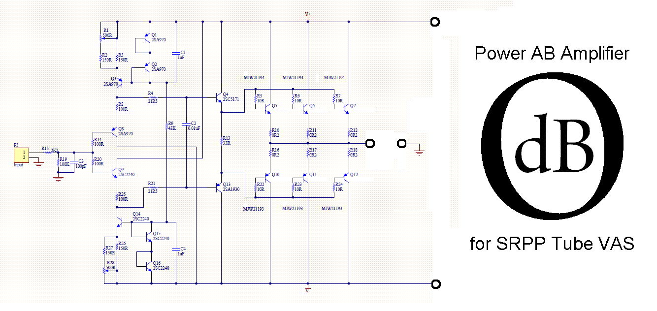

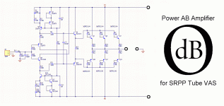

0dB amplifier - no gain
see the best amplifier
good for SRPP VAS
but also for Transformer VAS

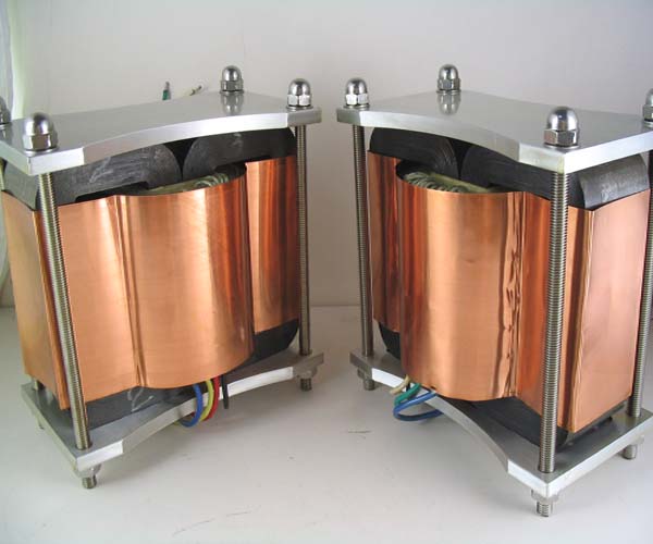

Hi Roscoe,
Thanks for the post.
I have a NOS in sealed original boxes pair of UTC LS-667 output transformers which should be ideal for these amps. I originally bought them to use in my pair of monoblocks, but finances require the sale.... $250 + shipping...
Regret that for the UK the shipping costs would be very high.
Hope you can find someone who would like to use them.
I am prototyping a pair of amorphous C core transformers (waiting on them, probably a few more weeks till they arrive), which will be interesting comparison to the M6 EI laminations. When I get them and have runs some tests I will post up the results.
Hi Stee,
Yes, putting an output transformer in there would give the whole PP output stage a nice solid reference point, then one can cut back on the negative feedback.
Have long intended to try out something like that, but not found the time yet.
Meanwhile I am putting together a new pair of monoblocks which will use the C core OP transformers, but with internal power supplies. The PSU transformers which I already have are also C core type, a bargain e*ay purchase. I have come to the conclusion that toroids for mains power are best avoided as they pass too wide a bandwith of noise and (here in London) we have very poor symmetry mains line power with appreciable DC offset which makes them hum.
Best wishes,
Susan.

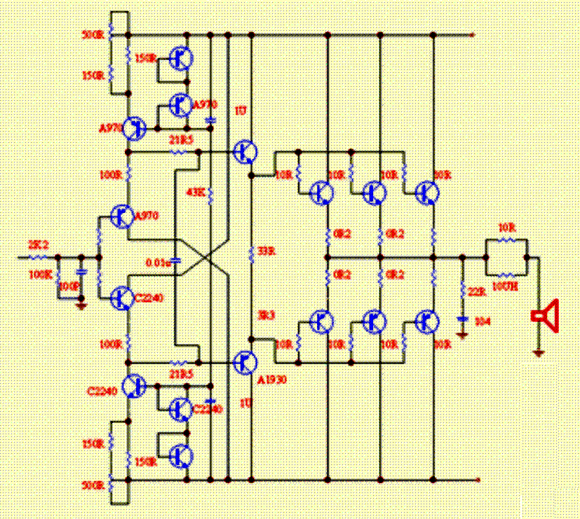

Hallo Susan, do you know about commercial amplifier models, what use basicly the topology of the schematic about post #1?
Perhaps the Paravicini-M100A about
Paravicini M100A Twin Tower2 and
M100A
