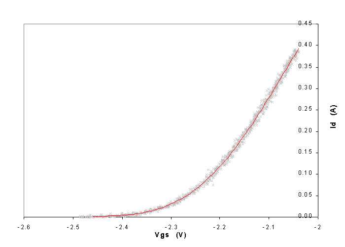

To operate the LU1014 in triode mode, you need to go down to Vgs around -1V. The exact load resistance / Vgs / Vds combination you need to experiment with, and it varies from FET to FET a bit.
I doubt that your gate current has to do with Vds alone. If you look at Fig.5 of the datasheet, you would notice that you only get gate current in mA's if you forward bias the gate to Vgs > 0.6V, as one would expect.
The reason why the datasheet shows gate currents up to 30mA is that in their original application (i.e. switching), you DO want to forward bias the gate.
Please try to measure a new, undamaged device with a large gate resistor (say 1k) and low Vds (say 3V), starting with -2V Vgs and NOT in your circuit (just to eliminate unknown problems). Increase Vgs slowly to increase current. And you can measure the voltage across the gate resistor to see whether there are gate currents. It does not take so much time, and will answer a lot of questions.
Attached a measurement with Vds at 12V, with a 1R source resistor and a 4R drain resistor (to simulate the load in a possible application). Just to show the device works without problems at 12V. Gate resistor was 1k.
Patrick

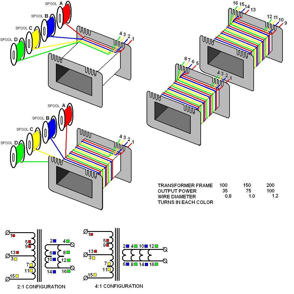

bokakob said:
I made a new picture for the output transformer. Perhaps someone who can, would correct it.
Looks like you've got it.
Sheldon

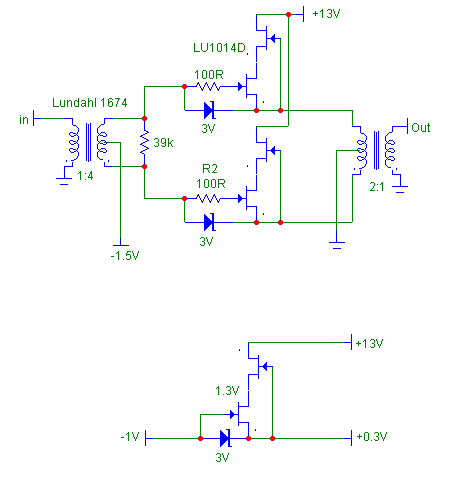

Since I already have the matched FET's how bout this for a low power version? The partial schematic shows approximate voltages for the cascode at quiescent conditions. We can swing a maximum of about 11V here.
Sheldon
Save your LU1014s. IRFP240 only costs US$1.xx each.
If you have to do it like that, then at least parallel 2 matched LU1014s for the cascode.
a) You lower the dissipation for each JFET at the cascode.
b) By halving the current of the cascode and hence putting its gate voltage more negative, you get a higher Vds across the driver JFET.
Patrick

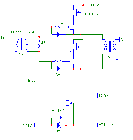

Well, this may not be the best of all possible ways to do this, but it works. Sounds pretty good too - at least as far as I can tell with a single channel driven from a cheap portable CD Player. With no signel, it's as quiet as a grave. Ear right on 96dB speaker, no hum, no buzz, no nuthin. I'm going to go ahead and build it up. The way I do the case will allow me to easily sub out the entire output block, so I can easily try different topologies.
Shown with current operating conditions. The resistance of the transformer windings are 0.10R each - measured with a battery and 100R resistor as a current source.
Sheldon

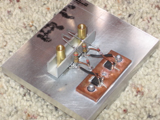

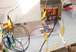

Here's a picture of the amp. The input FET's are under the aluminum bar clamp, shown above the copper bar. The transistors soldered (with Tix solder) to the copper bar are the top cascode FET's, as they will need the better heat sinking. The little perf board on the top left hides the input transformer underneath. The main power supply module is in the lower left. The bias supply is a simple CRC supply fed by a few extra windings on the main transformer, per Susan's suggestion.
Sheldon

The zeners were supposed to provide some protection against killing the FET with too much voltage swing. I actually just removed them, as they conduct enough to upset the bias a bit.
As for 200 ohm, well, I had them. Basically just a WAG. If you've got a preferred value, I'm willing and able to incorporate it.
Sheldon
