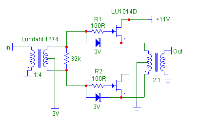

I've mulled this one over in my limited understanding of electronic design and have come to the following conclusions (take with a large grain of salt):
It's possible to use the Lovoltech devices, but the maximun power supply voltage should be 12V (absolute max. of 13V). At 12V a swing of about +- 10V can be achieved at the primary, as around 2V is required to bias the FETs'.
I think, because of the strange reverse current on the gates, they don't like any inductance on the gate. Means they can't be biased through the transformer, as Susan's design is. Further, I don't see any simple way to cap couple the input transformer to the gates and used a fixed bias on the gates. That would require a relative high impedance bias source, but the reverse current at the gate fights against it and, since it increases somewhat with increased current in the FET, it would create a positive feedback and cause the FET to go wide open.
So, we're stuck with a resistor (and big cap, as Susan pointed out, if we don't want full class A bias current). For about 1Amp total bias current, it seems to require about 1.7V across the bias resistor, so an alternative to the resistor and cap is about 70 cheap LED's wired in parallel, with the color chosen to suit the desired bias current (could have fun with that one).
Or, maybe go back to Susan's design, but for a mini version use something like an STP16NF06L, a TO220 mosfet, which looks like a scaled down version of the STW34NB 20. I'm going to get a batch of those to try (they are inexpensive).
I've had some very interesting PM correspondance with a DIY member regarding possible alternative drive schemes for the mosfet, which I'd like to compare at some point. But they need testing first.
Sheldon
Sheldon,
I am sure you have read the Zen Version 9 thread at the Pass forum. Why not cascode the LU1014s to get best linearity (if that was your motivation in using them in the first place). They are two possible ways, one like Nelson Pass does at about 1.3A bias, one like what I do (see the MOSFET headamp thread of Grey Rollins) at 0.3A bias.
http://www.diyaudio.com/forums/showthread.php?postid=1130939#post1130939
With my very limited experience with the LU1014s, I would suspect that your JFETs are possibly damaged. Anything other than a few uA on the gate is suspect at least. They are FETs, not bipolars !!!

You may be right Patrick, cause your circuit or the Pass circuit couldn't work with the current I see back through the gate. My unloaded supply has an output voltage of about 13.5V. The maximum Vgs is -12V. That's the only maximum I could have exceeded. The only thing I can think of is if I had the gate disconnected with the source open, then the potential from gate to source, when the gate was connected could have exceeded -12V. Been working more with tubes and sometimes forget that these little sand things are intolerant of mistakes, even for an instant.
I'll have to try some new ones.
Sheldon

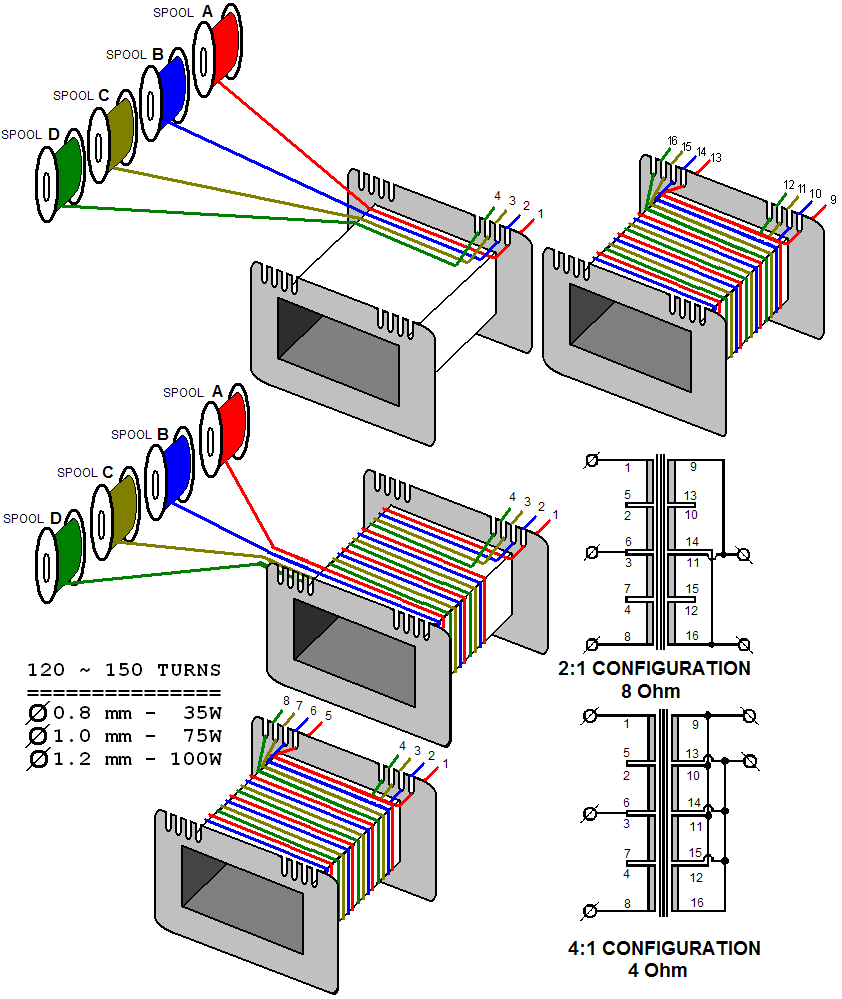

I assume that the two bobbins shown represent two halfs of a split bobbin. As I intrepret your figure, you have all the primaries on one side, and the secondaries on the other side. I think the intent is to have the primaries and secondaries wound together. So, for instance, the windings from one bobbin should be in series with the windings from the second bobbin, with the taps taken at the junction between the bobbin halves. In principle it's the same as winding on a single bobbin but looping out for a center tap, at the halfway count.
Sheldon
Re: Zeus output quad-fillar transformer configuration
bokakob said:
Oops - did not realise that after "preview" I had to re-attach the file.
Nice picture, I appreciate the time and effort to make this.
For the three wire diameters one would also use three different sizes of bobbins which roughly ratio to give similar(ish) number of turns.
0.8 mm = EI 1-1/4" (EI-125)
1.0 mm = EI 1-1/2" (EI-150)
1.2 mm = EI 2" (EI-200) or EI 2-1/8" (EI-212)
If one only wants to operate in 2:1 then one can wind a single section bobbin (which will look much like the illustration). This is simple and can be done by hand (or on a simple rig with a large hand drill held in a bench vice).
A dual section bobbin needs a bit more sophistication as it is desirable to match both sides to be the same number of turns. Given the nature of transformers and the winding interleaving a small mismatch of one or two turns will work acceptably.
My original Zeus 35 prototype transformers were wound on a single chamber bobbin in two layer sections and they are unlikely to be perfectly matched for turns and the outer section will have a higher DC resistance anyway.
The nature of the interleaving is as Sheldon describes (thanks for that).
The idea is to use one winding from each side for the two primaries, and the corresponding sections or all in parallel for the secondaries. This ensures maximum coupling between the two mosfets and should compensate for any small mismatches between the two sections. The all paralleled secondaries can likewise be a little mismatched between pairs as this should even out in operation.
Looking at my web page:
http://www.audiophonics.com/audiophonics-zeus-out-tx-75w.html
I see that it could use a wiring diagram as well, which I will add.
The reason I use quad filar windings and two secondaries in 2:1 or four secondaries in 4:1 is to do with copper cross section area and balancing current flow. I also want a nice low DC resistance to act as a brake for the speaker driver's linear (one hopes) motor.
Whilst that is how I have the habit of doing things, I am sure that Tri-filar winding is fine particularly for 2:1 and lower wattages.
And it is worth hand winding one's own transformers if one can, the savings can be significant.

Lovoltech devices
Hi Sheldon,
Thank you for your update.
Sheldon said:
I've mulled this one over in my limited understanding of electronic design and have come to the following conclusions...
I remain puzzled by the Lovoltech device's behavior.
I also haven't had any reply from my email asking for clarification (will let you know if I hear anything).
I would go with Patrick's possibility of gate damage, but the normal use turn on current is something that to me seems to indicate that there may be something else going on.
And Mr Nelson Pass's Zen 8 & 9 variation circuits use the LU1014D as a gain stage, so the operation is different to here.
Hum...
... still puzzled.
