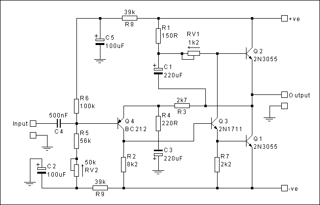

Basicaly there are 2 different amp versions with I would like to try the output transformer:
-JLH69 with dual supply(+/-22V) and no output cap. (the attached schem.) In there I could use toroid transformer.
-a mosfet follower amp (now with CCS: Bias 2A 30Vdc) There I need to use EI gapped transformer.
I think the first one has no problem and in the second one I would redesign the amp without CCS like in yours. Maybe it would be something like a choke loaded follower?
Please help me to learn how to design and calculate the output transormer for both (and different kind) amp!
Ca. 15W on 8 ohm

Hi Tyimo,
Power of 15W on 8 ohm is nice and sensible!
For the first version where you just want to experiment with transformer coupling with a 1:1 ratio you can use the secondary pair of a mains toroid transformer.
Would recommend something of 200VA or bigger, the main thing is getting enough turns so you really want one with an output of 55 + 55 Vac (or thereabouts, but not lower than 45 Vac). Higher is okay as long as the windings are bifilar wound otherwise you won't get the coupling.
For the second version you need a gapped core. This is most easily done with EI laminations but I have seen gapped toroid cores although not in standard pre wound mains transformers.
If you were very adventurous you could get a toroid core and slit it to make a gap (being careful that all the bits don't go "sprung") but I suspect this is being a bit over the top.
For SE version tri-filar wind three wires about 150 turns and then put two in series for the primary and the third is the secondary.
For small powers the EI120 size core should be fine, however you will be limited on current for biasing to get the number of turns for the wire diameter.
N.B. the given current rating for wire is normally given in free air and one has to derate by at least 60% for winding on a EI core (after Partridge article in Wireless World 1938 Dec 15th p529-530) and for larger transformers by 75%.
18 AWG (1.00 mm) is 2.36 A in air.
14 AWG (1.60 mm) is 6.0 A in air.
12 AWG (2.00 mm) is 9.4 A in air.
I run my EI120 transformers with 1.00 mm wire at 0.75 A per winding. With 12 AWG wire a max of c. 2.8 A per winding is indicated.
Remember that the SE transformer stores the energey required to go in the opposite sense to the supply rail in it's inductance so these higher biases are not fancy but necessity.
For a toroid with its large surface area to winding section the derating is much lower and with mains transformers the (max) current is normally specified for the windings.
In theory the larger the core cross section and the greater the gap that one uses (which needs more winding turns to maintain inductance) the lower the iron distortion will be. However other factors come into play so optimizing one factor does not necessarily give benefit to all others.

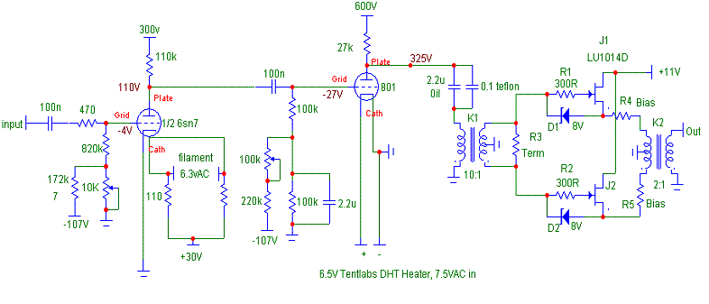

I've been following this thread since its inception and have been (slowly) constructing a pair of Zeus 75s. These have strictly followed Susan's circuit and use all her recommended parts.
Configuration
Input transformer: Sowter 8160 with 50% mumetal laminations in 5:1 configuration (primaries in series)
Output transformer: Sowter 9840 in 4:1 configuration
Mosfets: STW34NB20s Vgs matched to < 1mV at 500mA in test jig
Bias: 750mA per Mosfet supplied by L200 tracking current source
Heatsink: 0.2/W SK158 300x200x80 from Dau

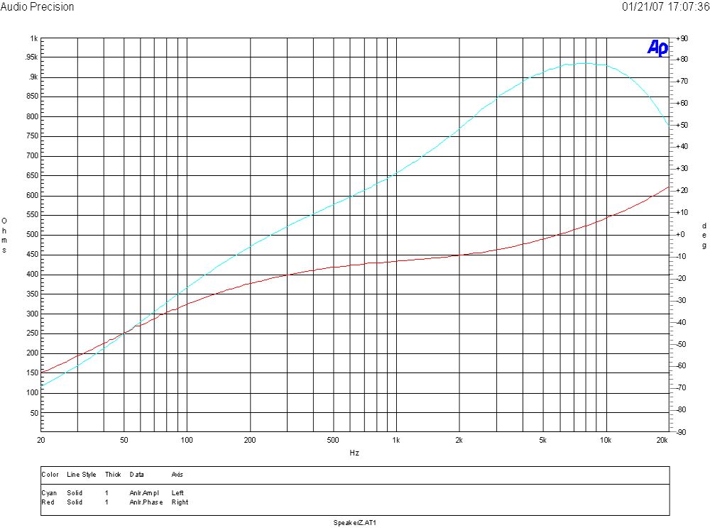

I've encountered the difficulties mentioned frequently by Susan in driving this power amplifier. A variety of DACs and preamps objected to its the low input impedance (stated to be 600 ohm). I'm currently constructing some line drivers, AD845+THAT1646 and AD8610+THAT1646 based. The THAT chip, a recently introduced line driver, has an output impedance of around 60 ohms maximum. Before finishing these off I decided to run an Audio Precision across the design to determine if this line driver would function well.
In the attached graph the cyan curve shows the input impedance. The input signal level was 500 mV. At high frequencies ~8kHz the input impedance is approximately 900 ohms - low but can be driven by a source with a low output impedance. By 600Hz it has fallen to 600 ohms - a standard reference value. As the frequency decreases to 20Hz the Zeus75 input impedance drops to 120 ohms. This is a very difficult load for most preamps and perhaps explains Susan's like of 'chunky' preamps 🙂
James

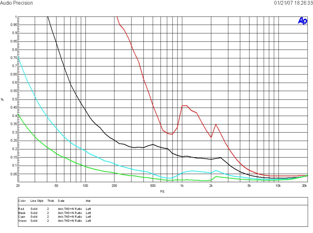

In view of this difficult load I decided to investigate the THD+N characteristics. The input signal level was 500 mV and the measurement bandwidth was 22Hz to >500kHz. The curves in order:
red - source output impedance = 600 ohms
black - source output impedance = 150 ohms
cyan - source output impedance = 50ohms
green - source output impedance = 25 ohms
I was tempted to drag in a conventional power amplifier to provide a <0.1 ohm source impedance but the trend is already clear. As can be seen, not unexpectedly, the distortion decreases as the source impedance is reduced. I can now see that my line driver with its 40-60 ohm output impedance will not be a good match for this.
James
