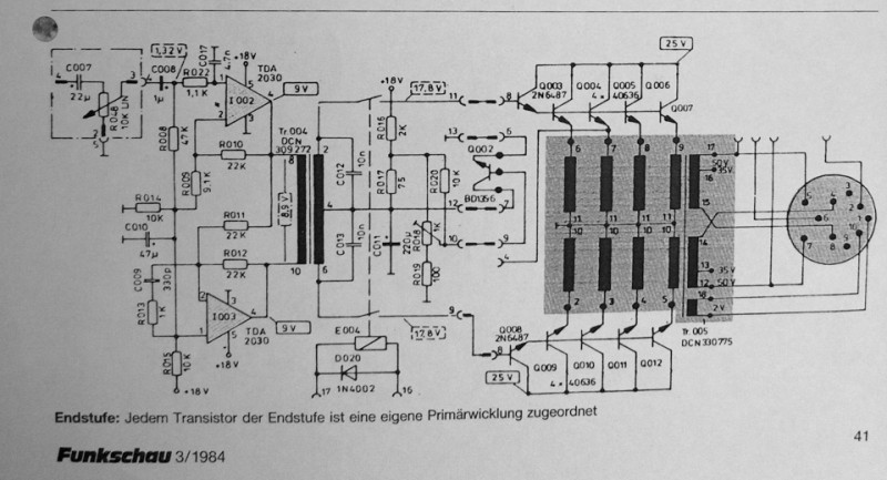

Hello Susan,
your Zeus is a nice and simple design... alas not quite cheap
if one buy the transformers.
Do you know his ancestor from Dynacord?
http://www.audiophonics.com/audioph...r-ad815-1.htmll
this link seems not to work!
Regards
Heinz!
Regards
Heinz!
Hi Heinz,
Thank you for your post.
Thanks. I agree the transformers do addup if one has to buy them all at once. However one can tryout the principles using mains power toroids and a headphone output which is very cost efective.
This gives a easy introduction and enables one to get a feel for the "Zeus sound".
No, never seen this one before. Thanks for the schematic.
Ops, seems to have an extra l on the end.
Should be:
http://www.audiophonics.com/audiophonics-zeus-line-driver-ad815-1.html
Thanks for pointing that out.
best wishes,
Susan.

1:1 output transformer question
Hi Susan!
I would like to ask you for some help!
I would like to try a SS amp with 1:1 output transformer. I have heard so many oppinions pro and contra about output transformers, that now I would like to test it myself.
I now the sound of the direct coupled and also the capacitor coupled amps, but not the transformer coupled. So, I would like to try it, for example with the good reference amp the JLH69 (if it is possible at all.... ) or with another ca. 15W capacitor coupled Mosfet follower amp instead of the output caps.
I know your Zeus PP design and I saw that you built also a SE version of the Zeus.
Could you help me how can I calculate the parameters of such an 1:1 output transformer???
I could try EI types and toroidal isolation transformers too.
What do you suggest?
Greets:
Tyimo
Hi Susan!
Greets:
Tyimo
Re: 1:1 output transformer question
Hi Tyimo,
SE needs a gaped transformer, so standard toroid won't be suitable.
However you can use the secondaries of a toroid in PP for a 1:1, although the distortion levels will be higher.
This is a size comparison between gapped EI for single ended and standard EI interleaved for push-pull:
For SE you will need higher bias, so the windings will need to be of a heavier gauge (or several in parallel).
What power are you looking for and what sort of load (4ohms, 8ohm, ...)?
Best wishes,
Susan.
Hi Tyimo,
Tyimo said:I would like to try a SS amp with 1:1 output transformer. I have heard so many oppinions pro and contra about output transformers, that now I would like to test it myself.
Best wishes,
Susan.
