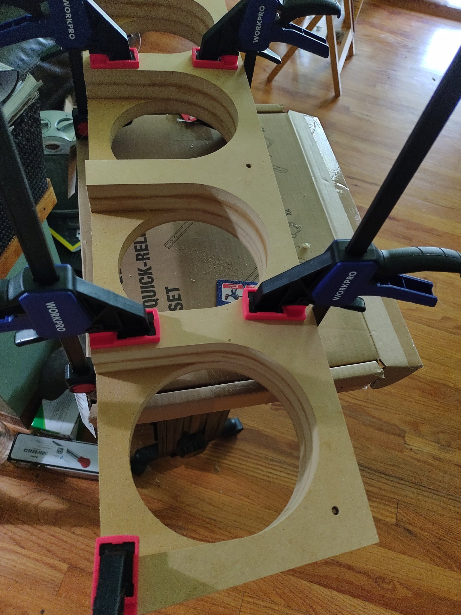

I have started. By the way, those inexpensive clamps you put a link to seem just fine.
Reactions: xrk971

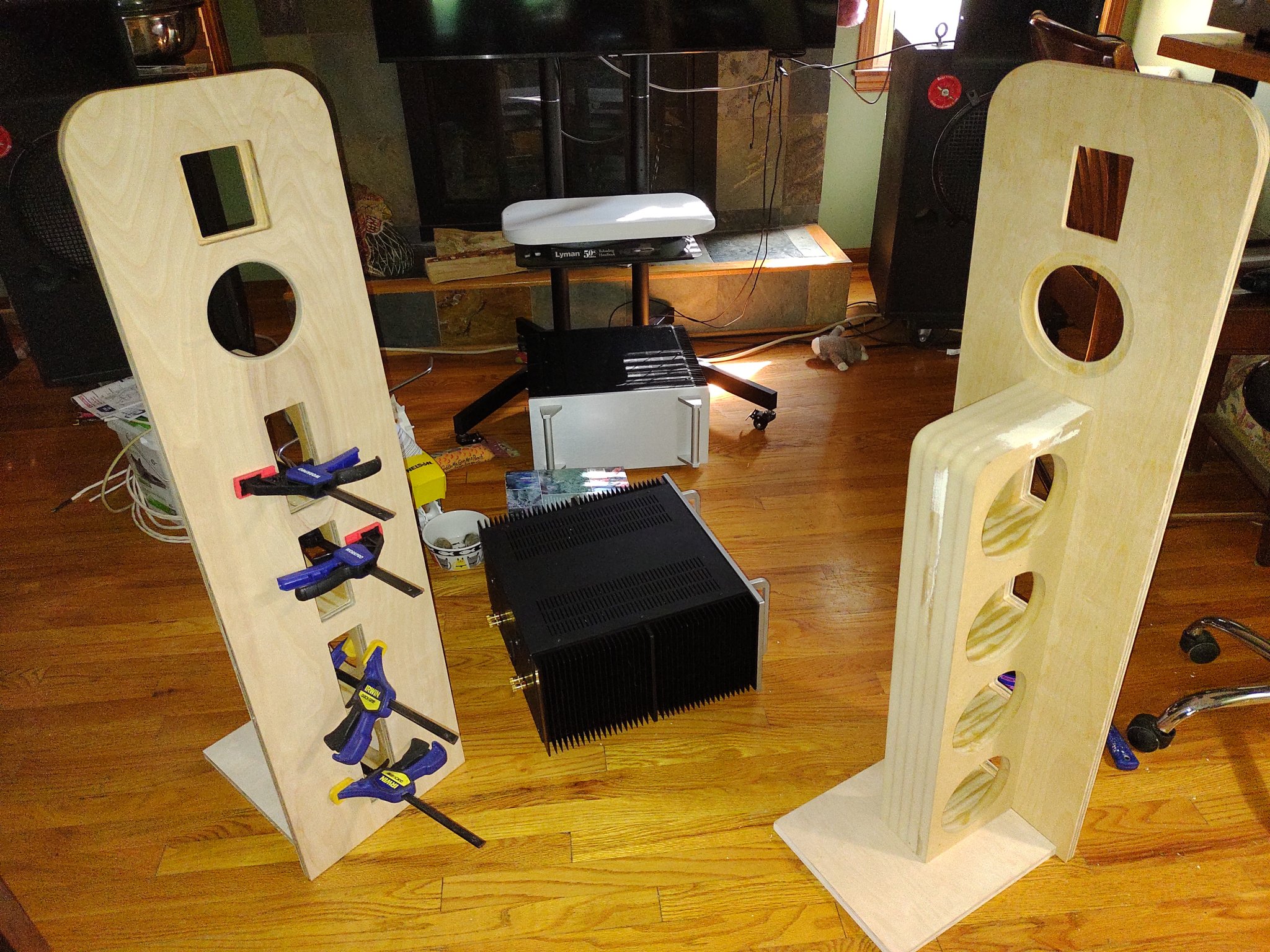

Well, I guess it's the same "glue mess" but easier to clean up. I just glued the first, clamped for 30 minutes per directions. Then added next layer, clamp for 30 minutes, so on. Left clamped over night. Wiping excess glue after the squeeze.
Russellc

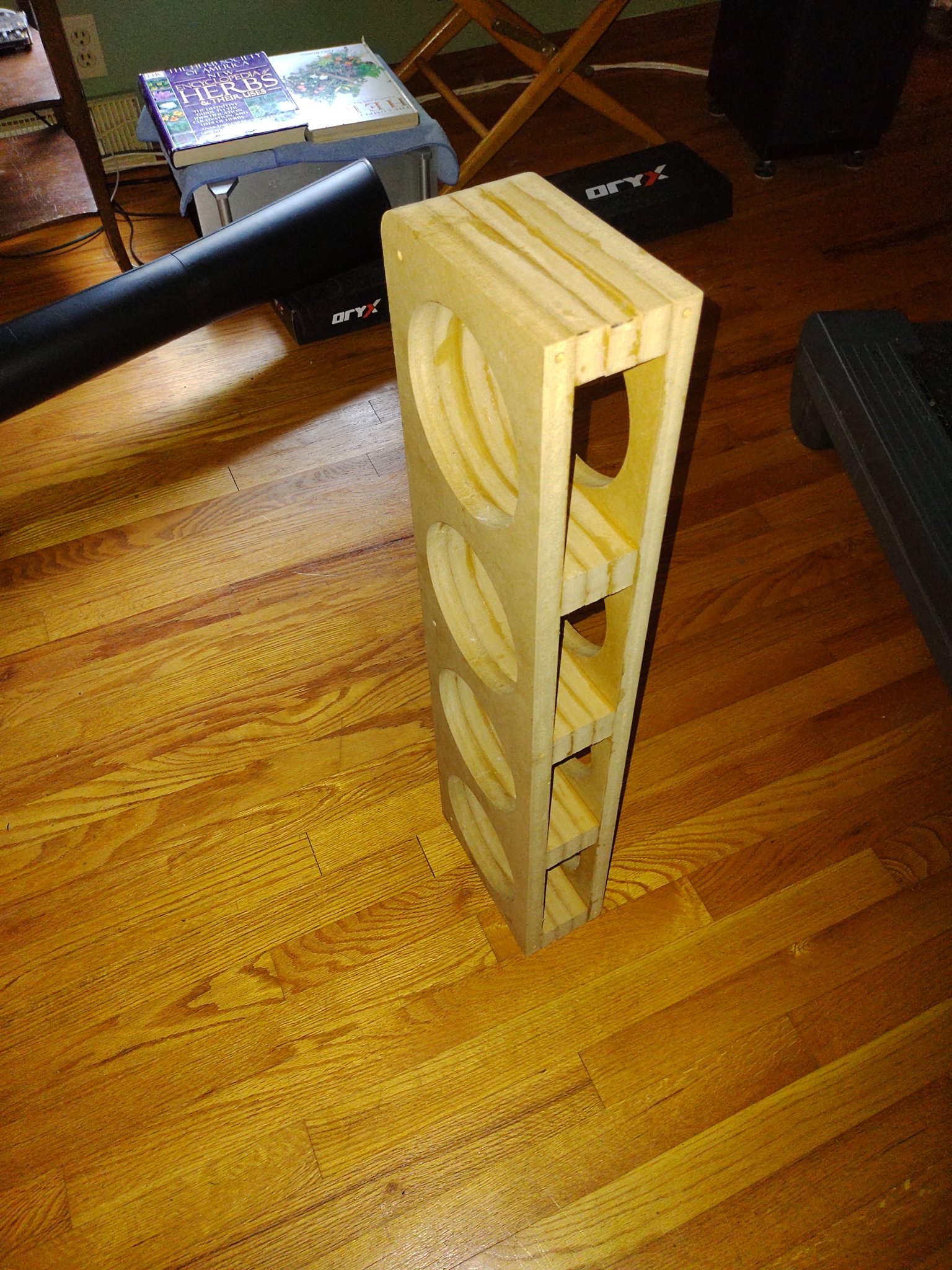

I have both bass units assembled. Have been sanding edges of all the parts, then filler, sand smooth.
I figure to attach the front panel next, I think that will be logical order, it will determine that faceplate is properly aligned, then base can be attached, clamped so it is perfectly perpendicular, not "tilted" in either direction.
More sealer and sanding, then prime and paint.
Russellc
Ready to put wings on. Guide holes for screws on same side all 4 pieces, so wrong side for 2. No big deal, I just drilled a tiny hole all the way through. There is a slight bowing to the wings, so that if top and bottom are flat to the edge of face plate. The bow takes it a little beyond the edge. Careful placing of the long square piece will hold it even once wing is screwed to it
Bubba
Reactions: xrk971
Are you going to leave screws exposed, or fill and sand?
The long square pieces that the wings screw to will require careful placement. Once I get it positioned at the top, I will put a screw through, then pivot the piece down a screw it as well, at least temporarily. Hopefully this effort will result in the wings edge fitting flush to edge of face plate, all the way down. This assumes the long square piece is straight and if not, I will have to find a method to attach it so it is.
