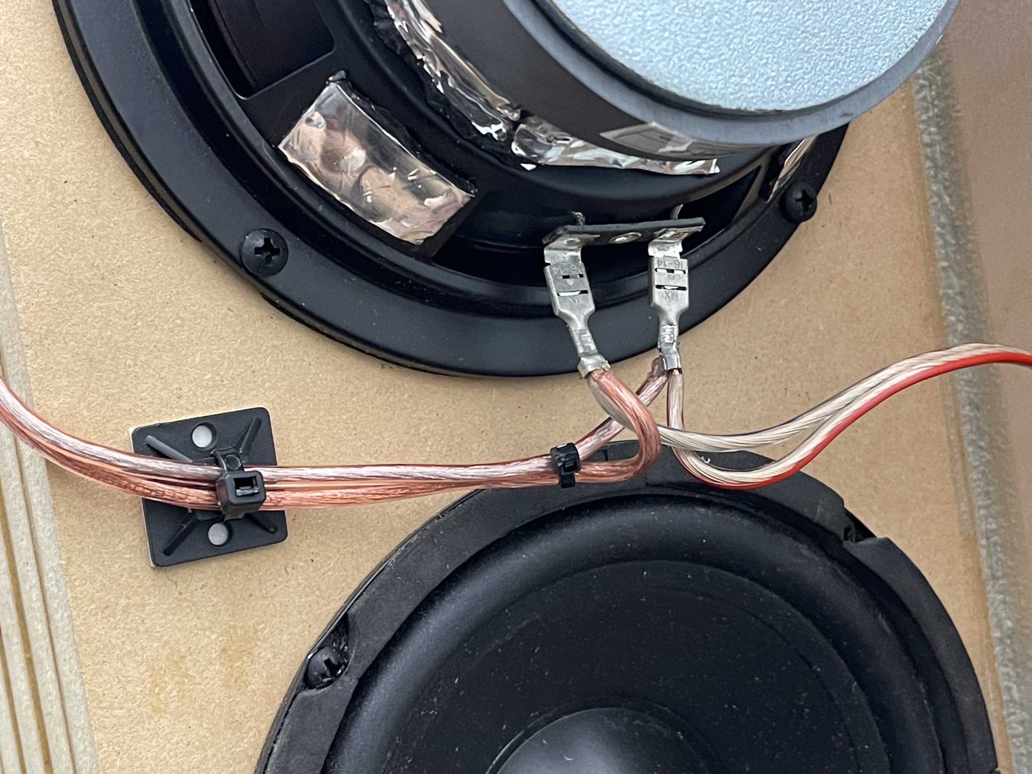

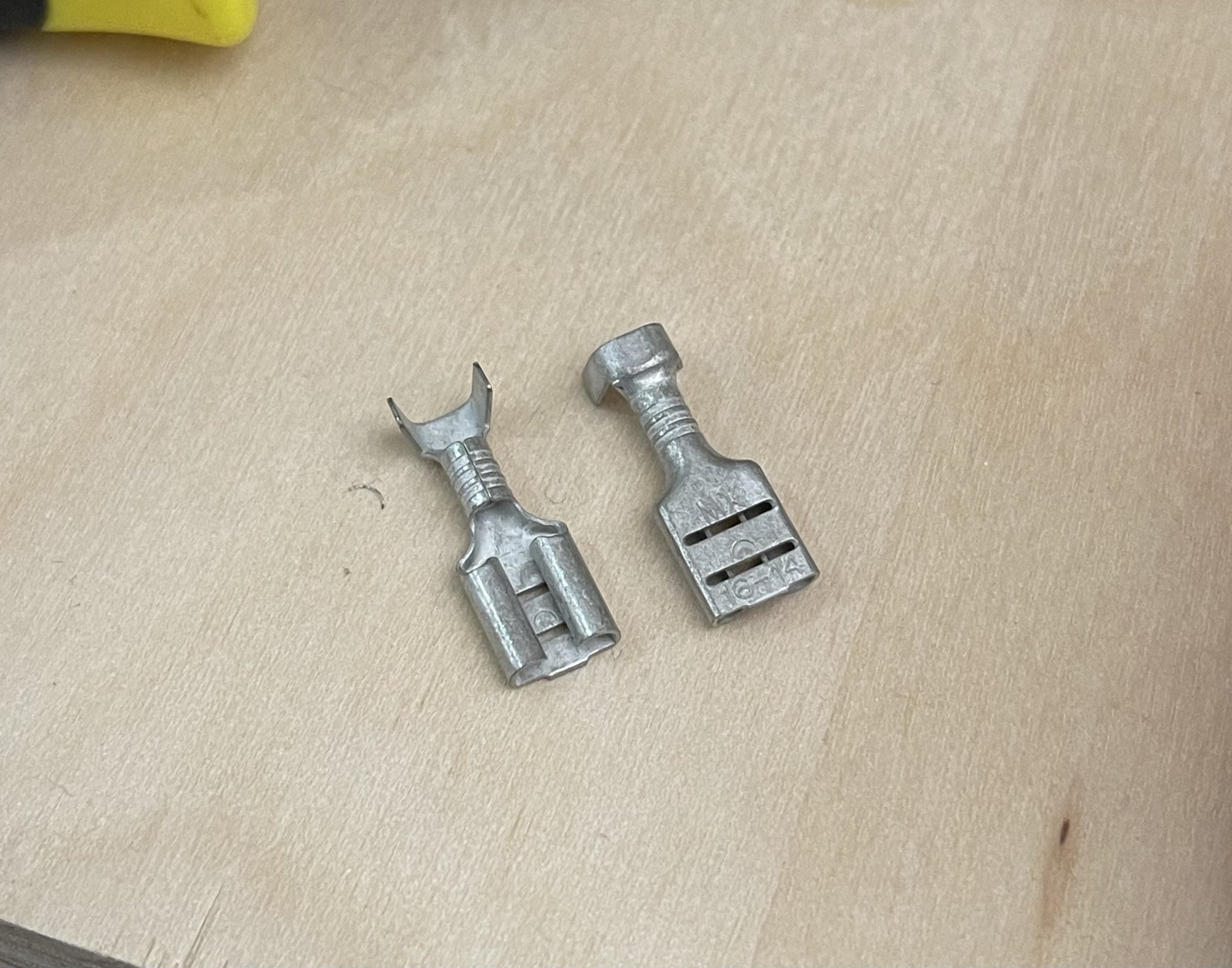

Parts Express 095-522 seems to be the correct crimp connector (no plastic sheath). Nicely made with tin plating I think.

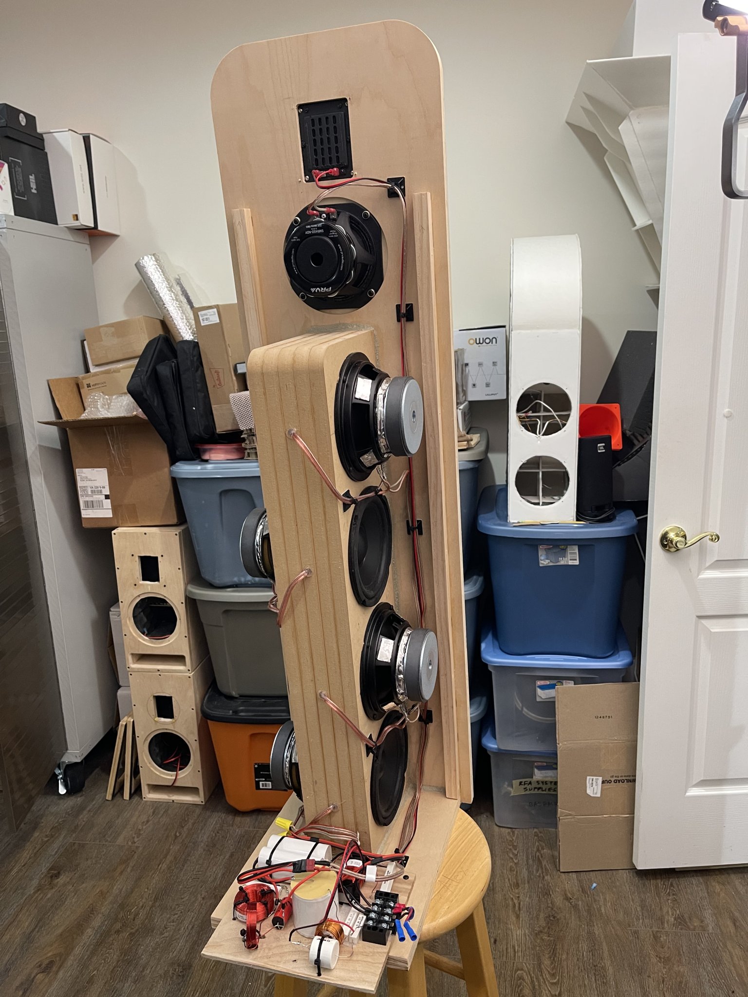

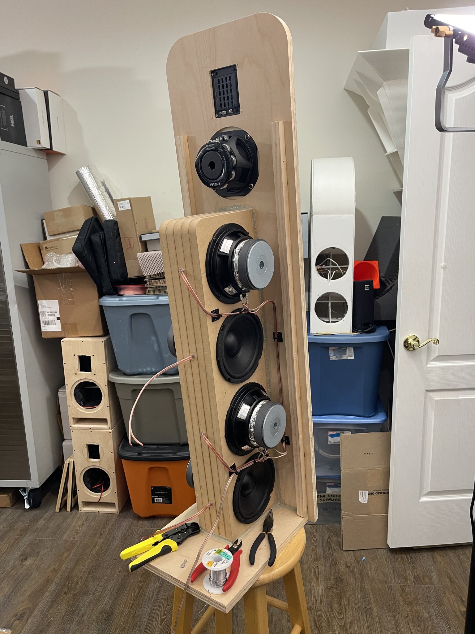

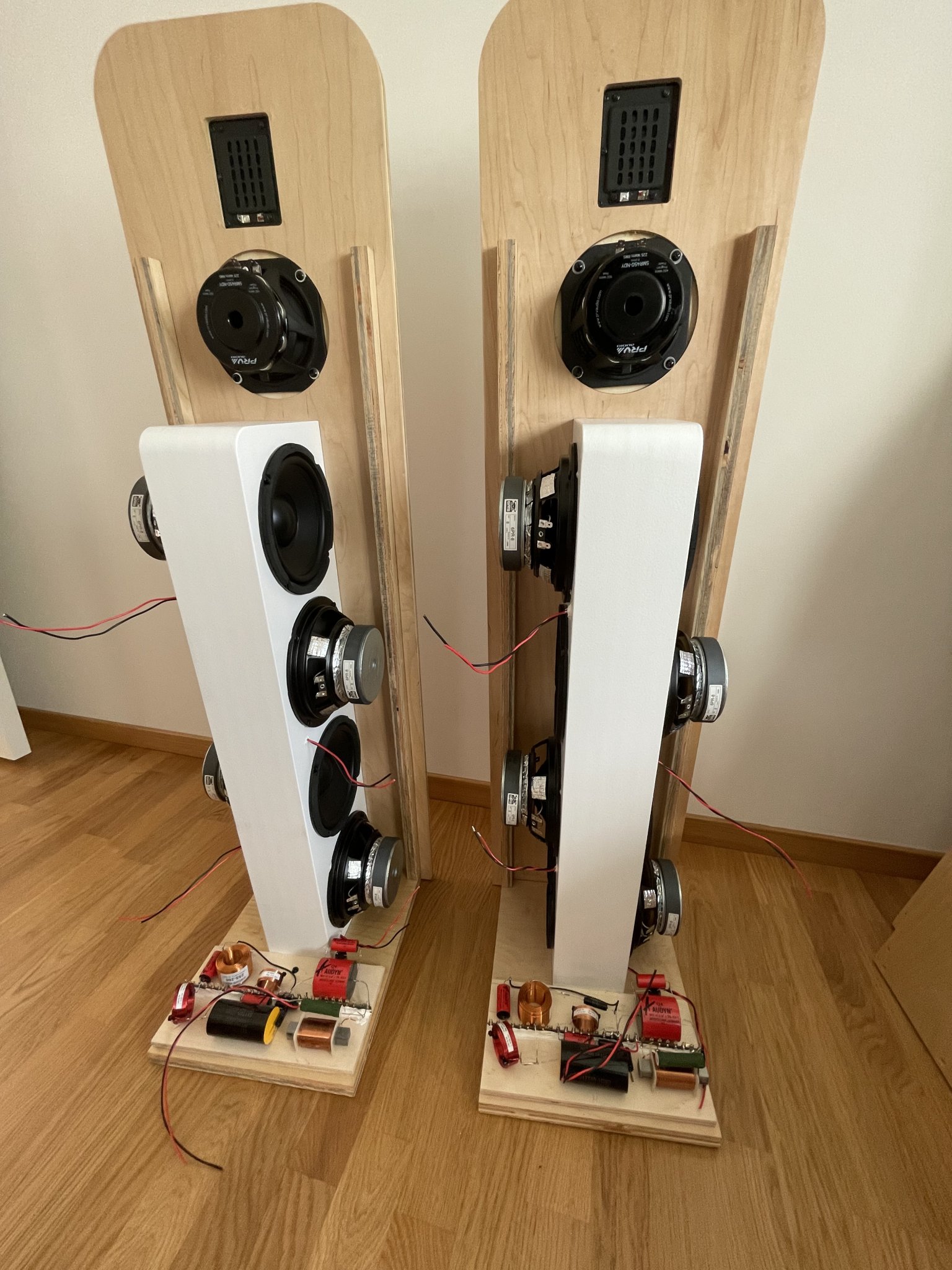

Just finished wiring one side of woofers. Used a 1.5v battery to check proper polarity by looking at motion of all cones with excitation.

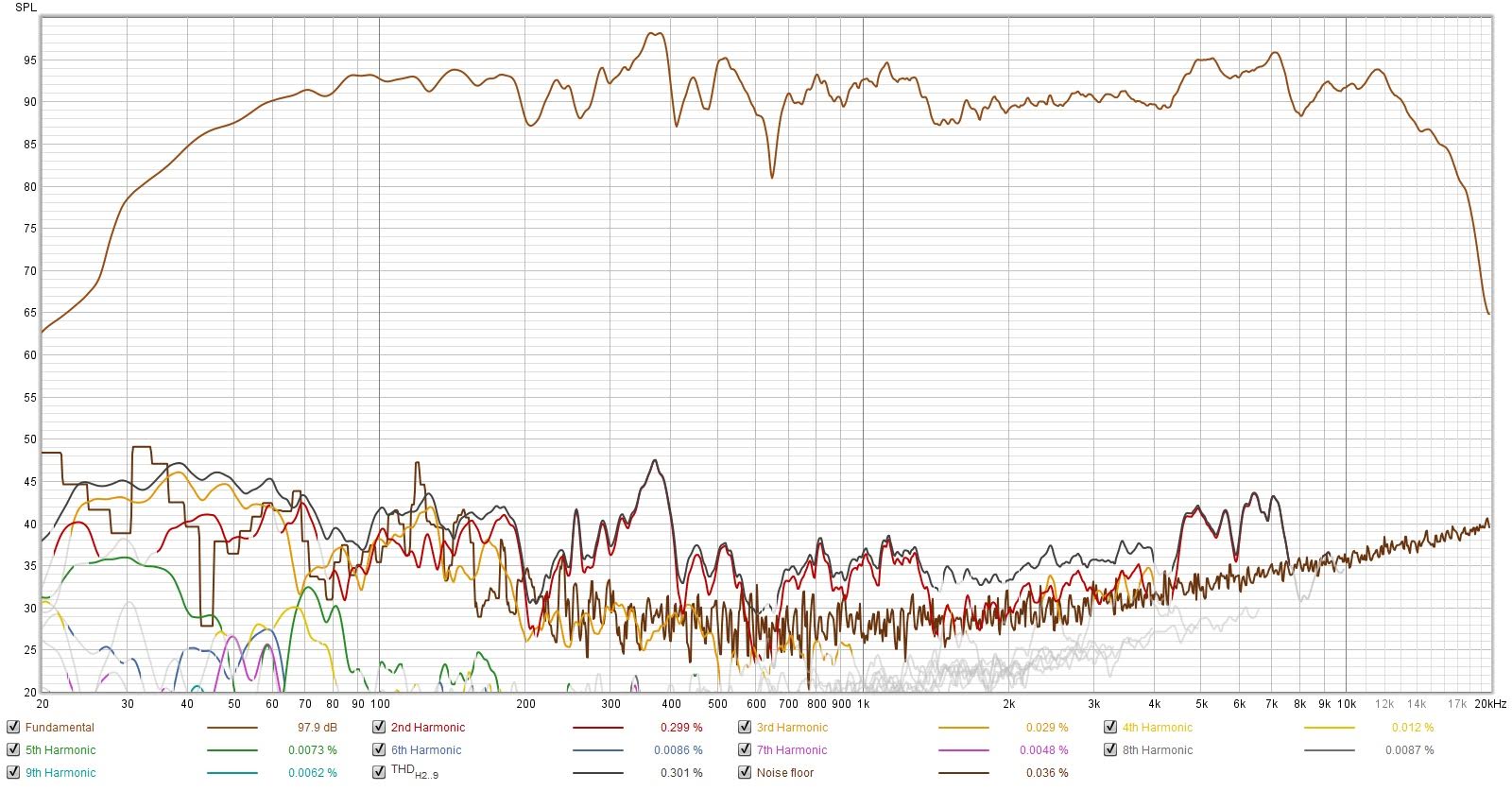

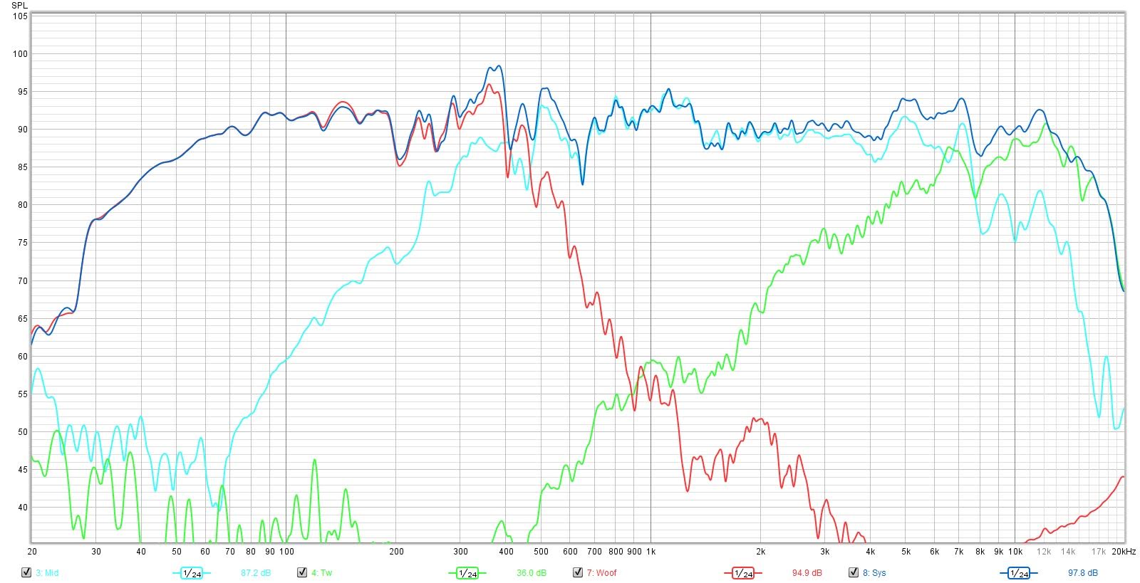

Measurements of the XO response shows pretty consistent with previous speaker - there is a small peak in the woofer output near the XO frequency. Probably driver to driver variability. The mid range also has a little more structure at the top end.
But overall, the sound is very lively and dynamic. Distortion is low and speaker is clean sounding. There is a distortion peak around 370Hz but level is low - it’s probably related to a cone breakup mode for this batch of drivers.

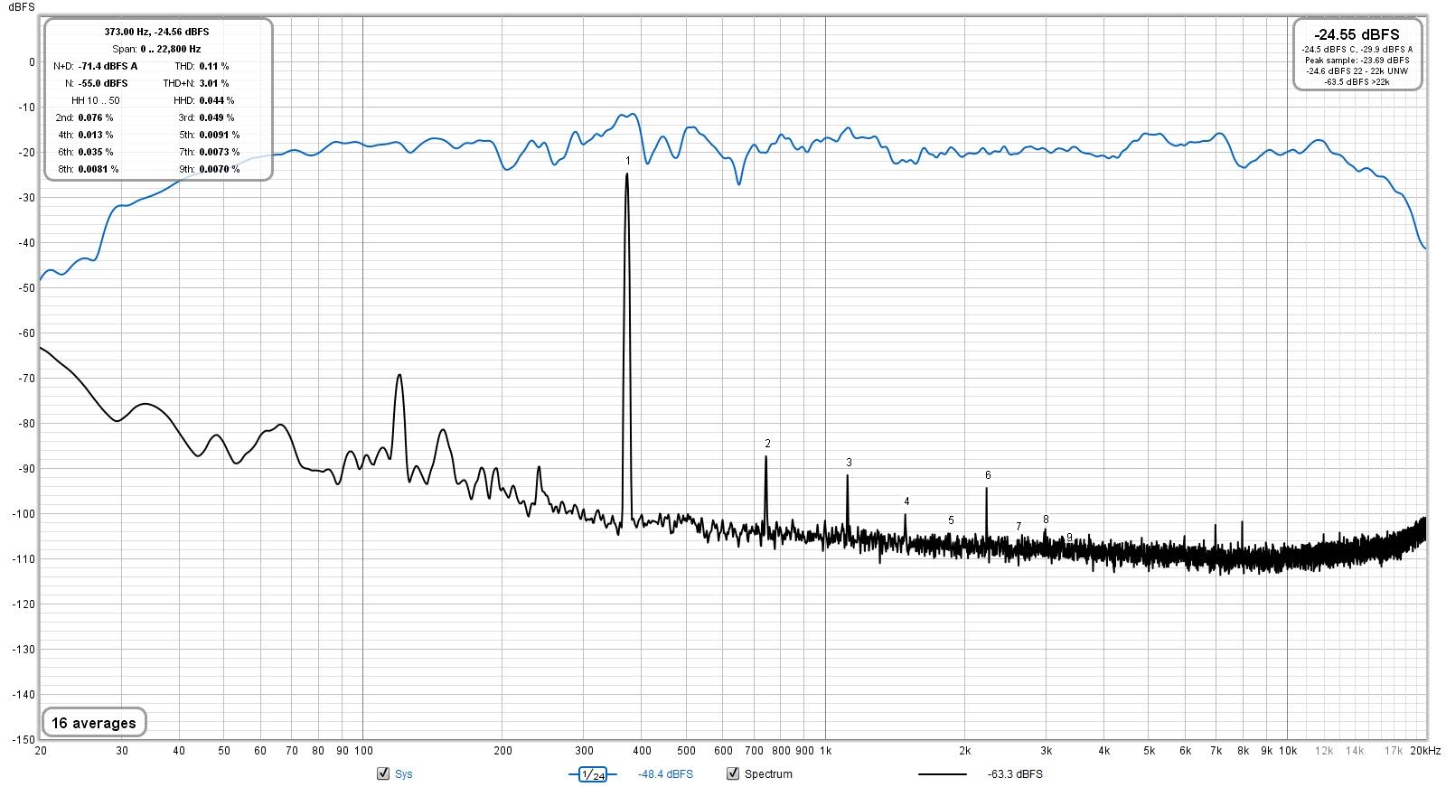

I gave the speaker a test tone (sine) at 370Hz and monitored the FFT spectrum and it shows dominant even order harmonics and circa 0.11% THD for 2.0Vrms. The even harmonics are at least pleasant sounding vs odd order.
