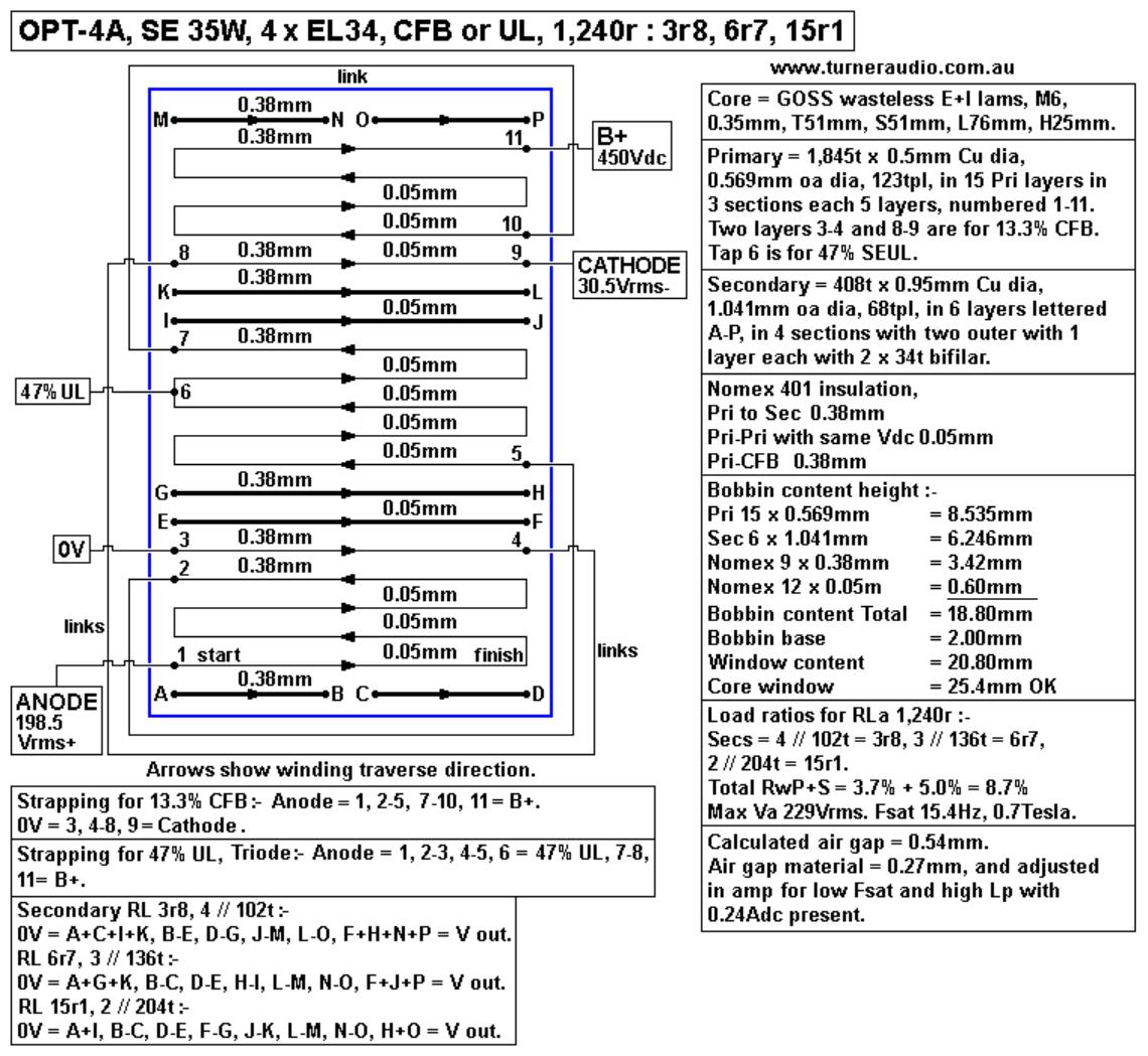

Winding my own output transformers...dumb idea?

This is not about undersizing core afainst neded power, in this example of iron core from the photos, the winding space almpst does not exixsts, it is for special purpose core capable to accept very small nuber of turns... 🙁
That window is 40x25mm=1000mm^2, it almost equals to EI114, 57x19mm. The biggest disadvantage of EI core is height of window that far too limited, only 19mm. It hard to contain any large coils. It's first time I customed the silicon iron directly from a factory. I amnot satisfaction with that, but it work better than most EI core I have. It can delivery 18W evan at 20Hz, without any observed distortion.

Hi 50AE
Thank you. I appreciated your detialed explanation.
You siad " So the first rule of thumb is keeping the anode far away from ground as possible." Let's using Mr. Turner's drawing as an example. If Point No1 connect to anode, I should avoid make Point A be at ground potential. Am I right?
If a singal swimmng 70Vrms on primary wilding, secondary is only few volt. What the different if I let Point A at ground.
