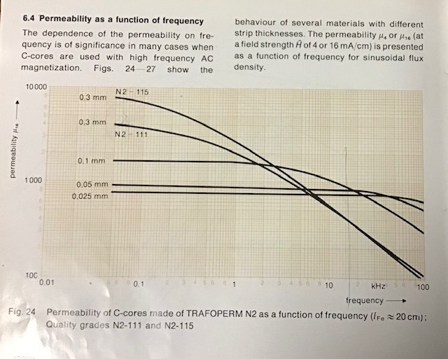

The thinness of the laminations has the benefit of maintaining the effective permeability of the core (and hence primary inductance) to as high a 'low frequency' as practical, with the aim of suppressing low frequency phase shift and roll-off gain in the region where it can complicate GNF stability. This topic come up recently in https://www.diyaudio.com/community/...ncy-dependent-inductance.389901/#post-7118671 . The last reference in that discussion is available via https://ur.booksc.eu/book/39310494/1a2ebb .
No that is not true. With thinner laminations the permeability drops a lot. That's information Vacuumschmelze gives about there cores.
No.

Unfortunately no link, it's from a datasheet i have from Vacuumschmelze "strip wound cut cores"
Thanks for posting the graph.
But as I understand it, eddy current losses also go down . How much that influences sound, I don't know, but it's talked about in so many papers that it must be worth some consideration.

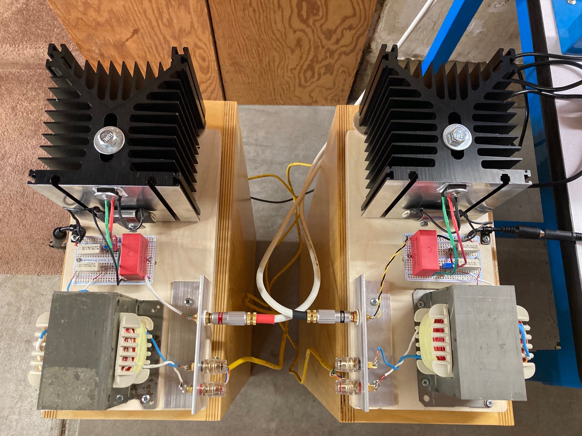

Cheater. That looks very solid state, where impedances tend to be on the low side. It’s realizing high quality high impedance transformers that are difficult. A lot of turns = a lot of problems.
The eddy currents get down with thinner laminations indeed but with higher frequencies they go up. But, core exitation levels at higher frequencies go down rapidly. Most of the time your speaker has more limitations
High impedance transformers are not really a problem, even compared to low impedance transformers, this is over exaggerated. In fact, low primary impedance have problems on their own, for example coping with leakage inductance, where in high Z transformers you have watch out for shunt capacitance. There are however some issues with unrealistic expectations, especially for step-up transformers.

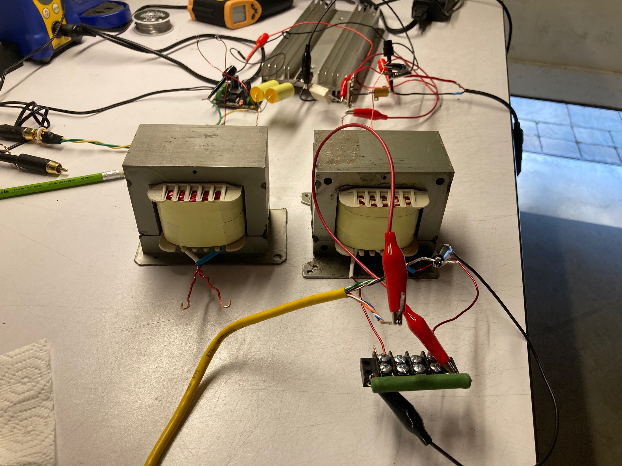

Salvaged iron?
No big deal.
Salvaged wire????? 😱
Avoid it like the pest it is.
Main feature of insulated wire (called magnet wire by some) is .... ummmmm ... its insulation , which depends 100% on its enamel integrity.
I do NOT repeat NOT trust it,period.

Salvaged iron?
No big deal.
I have a whole bucket of it - and I use it for making speaker crossover coils, car amp DC-DC converter trafos, and some types of SMPS filter chokes. Nowhere were plug-in power is required or if there is a lot of volts between turns. That lets you save all the expensive virgin wire for making power trafos.
I don’t think he was being serious there. Those did look like salvaged cores. Works fine for power trafos, or audio at impedances where a little leakage reactance and distributed capacitance aren’t going to bother anything, and where a relatively low primary inductance can be tolerated.
Reactions: JMFahey
I wasn't 🙂 But I will be serious in suggesting that no one should be daunted by the prospect of winding their own output trafo, whether for electrostatics or some weird tube or for a cheat move like driving it with a MOSFET just to see what your old microwave oven sounds like. It won't be perfect and that's okay, 80/20 rule and all that, this is DIY afterall, not dialysis.
