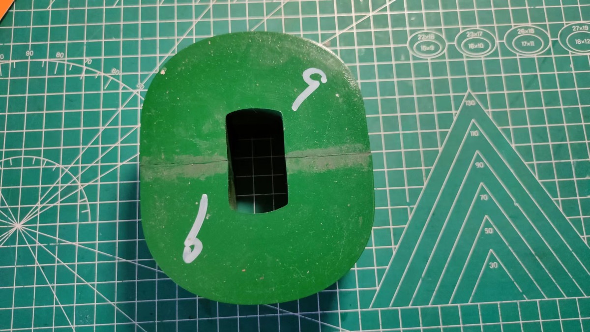

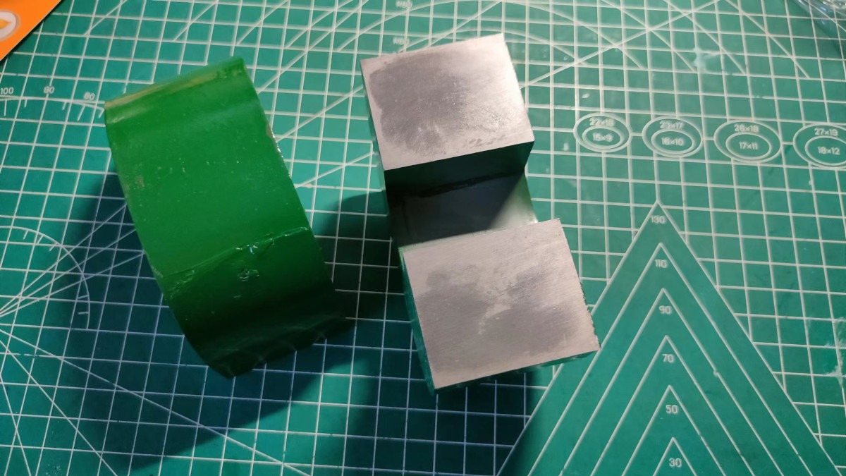

Hi Zoran
I could't agree with you. I ran lots of tests with many of Silicon iron I can get. It came from UK, Gemary, US, J apan, and also China they made in recent decades. Considering the different AFE, and ML for each iron, I wound turns of 80~300 for individual one. The results are very interesting, almost each different item shows different behave.
I applyed 10vrms sine wave at 10~1000Hz for the coil. Some of them show alot of distortion at lower frequency. One of them have a same distortion from 40Hz up to 120Hz, looks like have a constant pereability. A few of them have very low distorion evan at 10~20Hz.
Finally, I choise a type of silicon iron which performance is best, and it is still manufacturing. The thickness is 0.23mm, high permeablilty grade. I also noticed that Silicon iron is a shape sensitive material. C type or CD type is better than EI.
I palced a order to a local factory and received it. 😎
Andy

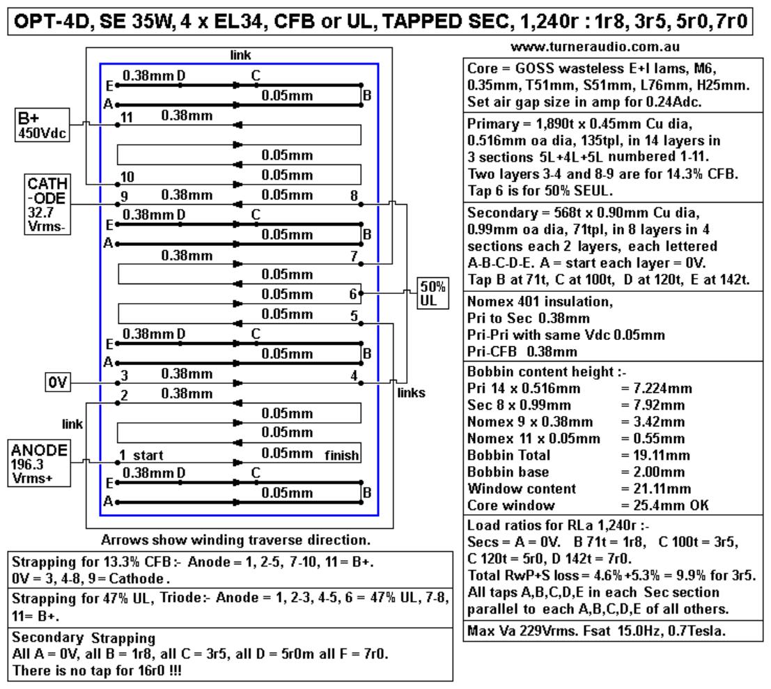

Hi 50AE
I read all Partick Turner 's article about OPT, I found there is a few way for interleaving. Did I miss something? Can you give me some tips?
Andy

Hi 50AE
Andy
Patrick has quoted some types of OPT interleaving, just keep exploring his website. He has given explanations behind his reasons, although they can be scatered around. He has also explained how to calculate primary to secondary capacitance.
