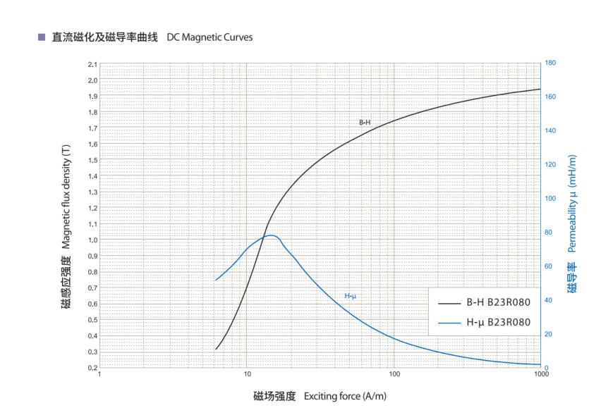

I collected some datasheet of silicon iron back from 1970's to 2016. Few of them have a detial about AC permeability in low-intensity magnetic field. They always offer a DC permeability VS exciting force.My Vacuumschmelze databook is full of those permeability curves. I have also data from other manufacturers from all over the world. It’s not so rare as you say. But skip the EI cores.
At AC power source, there are two kind of permeability. Elastic and viscous permeability. I never find any specification give that graph.

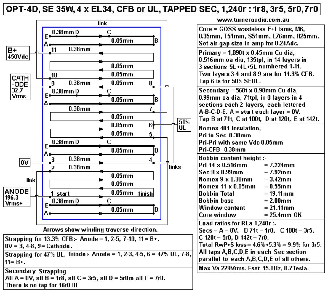

Think of capacitance as dependent from alternating voltage potential difference. Primary voltage swing is highest at the anode (makes sense), while it is ideally 0 where the DC power supply, shunted by the decoupling capacitor. An regular tube amp OPT has a high ratio impedance transformer, for example a 3,5k\8R transformer has ~21:1 turn ratio. That means, if you have 210V AC on the anode, you will have 10V max secondary voltage. In practice this secondary voltage is too small to be of practical used, so Patrick for simplicity sake assumed the whole secondary winding would be considered as 0 DC potential.
In Patrick Turner's interleaving schematic depicted, the P/S capacitance will be the highest at the first primary (Anode) layer an the AB CD secondary layer.
In this layer the capacitance factor Cf = (12,5/13)^2 * Cst. Cst stands for static capacitance, the equivalent of a parallel plate capacitor. The 13 is the number of primary layers in Turner's interleaving schematic, and 12,5 stands for the current layer number with 0,5 subtracted for an averaging midpoint.
On the other hand at the top B+ primary and MN OP secondary layer, +, Cf = (0,5/13)^2 *Cst. You then realize it's 625 times less than the anode counterpart. Capacitance decays proportionally to impedance, from Anode to B+.
Patrick used layer numbers from a simplistic point of view of believe. You can use voltages or even impedance decay if you want. In another great book called "Transformers for Electronic circuits" by Nathan R. Grossner, the formula quoted used voltages.

Nice graph, those curves can be easely found from several manufactures online.I collected some datasheet of silicon iron back from 1970's to 2016. Few of them have a detial about AC permeability in low-intensity magnetic field. They always offer a DC permeability VS exciting force.

Hi 50AE,In Patrick Turner's interleaving schematic depicted, the P/S capacitance will be the highest at the first primary (Anode) layer an the AB CD secondary layer.
If we removed the secondary layer closest to primary Point 1, we can highly reduce the capacitance. But what the biggest fault? A greater leakage inducutance?
Best regards!
Andy
Yes. You will get a point with higher leakage. But in a situation such as this one, you might get a more beneficiary ratio Cs for Ls tradeoff. On the other hand, it would be a dumb thing to do it at the top where the B+ is, because you would get the higher leakage with no practical reduction of capacitance.
The key for making good identifying transformers is to identify which flaw can become a benefit. For example you could use the outer secondary layer for
Once you start calculating capacitance your imagination can soar. But beware, you need some failed projects to identify how capacitance distribution affects all varieties of transformer geometries.

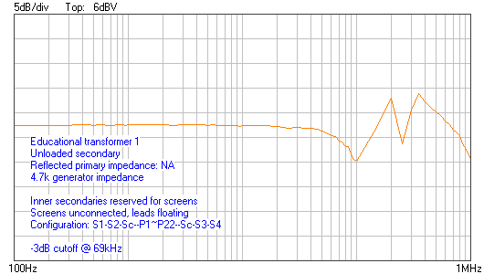

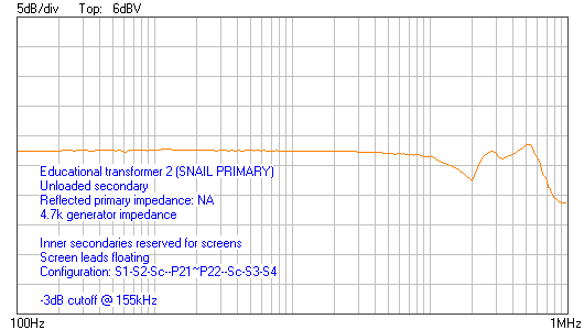

Take a look of RDH4 and N. Crowhurst papers as well. There are asymmetrical types of interleaving, such as P3-SS-P6-S. It's a benefit to start at the bottom P3 end as anode.
Take a look at these two transformers. They have the exact same interleaving. S3-P22-S3. But differently dumped capacitances around. Notice the doubling of frequency in the dipping resonance. The transformers have a calculated 75mH of leakage inductance, Patrick's formula used.
Impressive! Anyway, what's the difference between both configs? I just can't get the abbreviations sorted...
