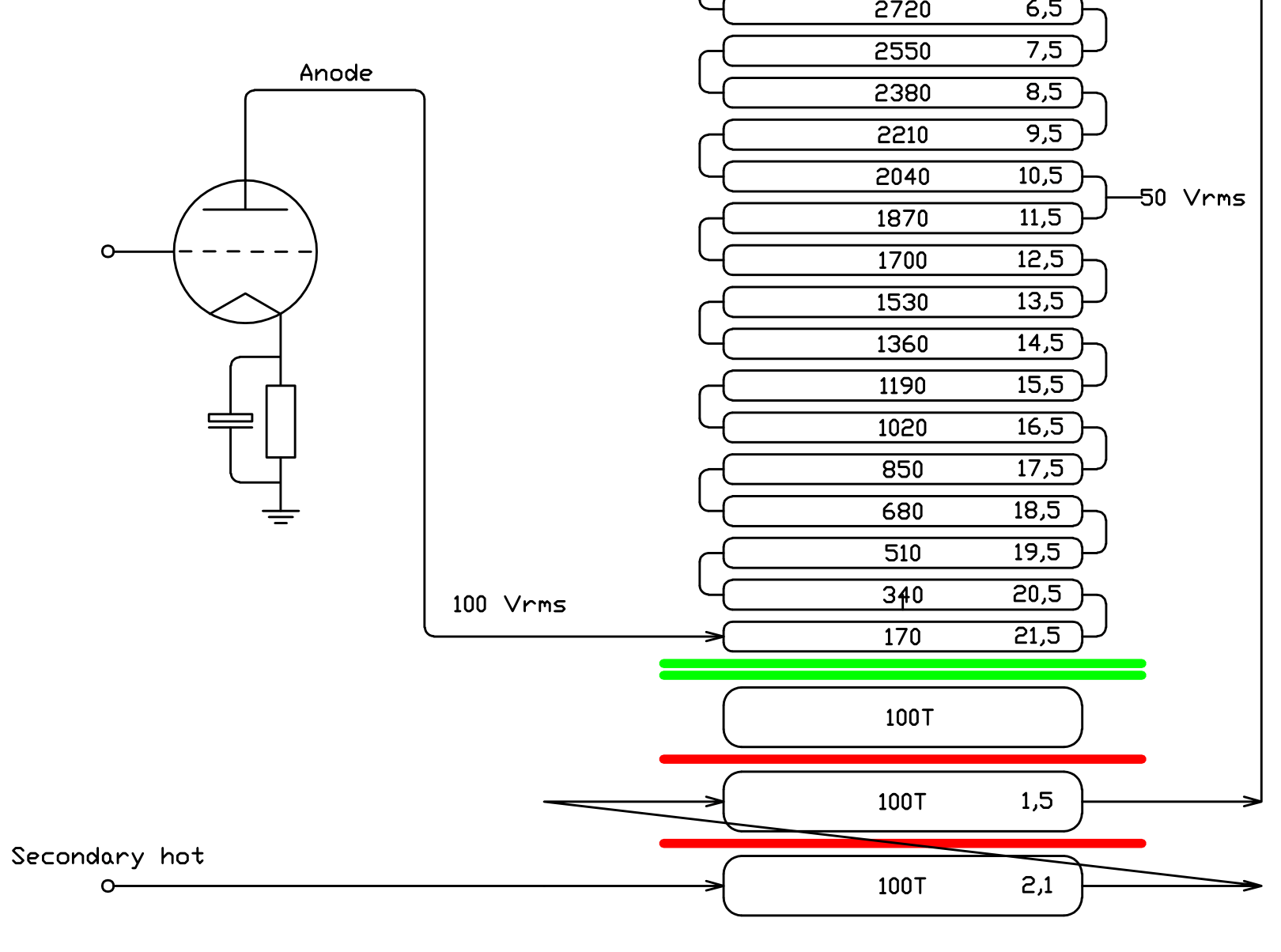

They both have 22 layers of primary interleaved between three layers of secondary on each side. That makes for a SSS-P22-SSS configuration
The first transformer starts with a consecutive winding. The anode starts at the bottom, then 22 layers are wound. The B+ layer is the top primary layer.

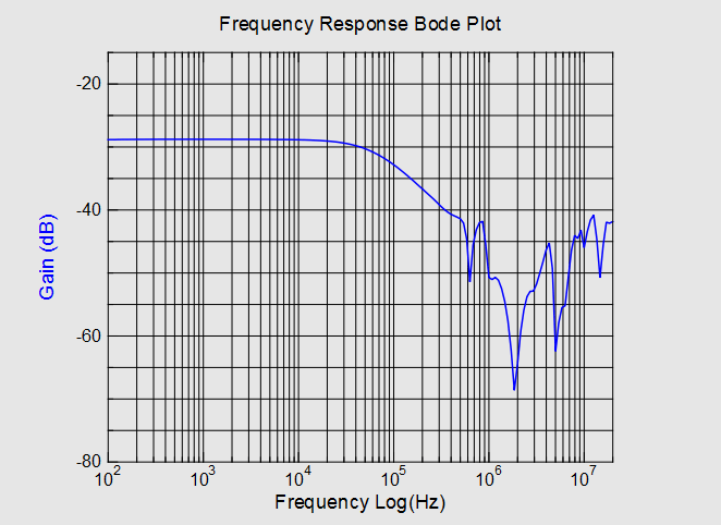

The second transformer however has its anode layer placed in the middle. And all anode layers have free separate connections end. You then start connecting them with voltage gradient dropping from the center progressively to the ends. This is why I called it snail primary - it reminds of the progression of the inner center to the outer ends. Basically in the end by doing this, you increase primary clumped capacitance by a factor of 4, but have decrease the bottom P/S capacitance by 205 times in this situation.
This technique is useful when designing high leakage inductance transformers, where you need to be careful with P/S capacitance. One P/S capacitance bridge is not really problematic, but two and above can become so. while clumped primary capacitance is less problematic. In this example, I have moved the resonant frequency 2x times above the audio range.

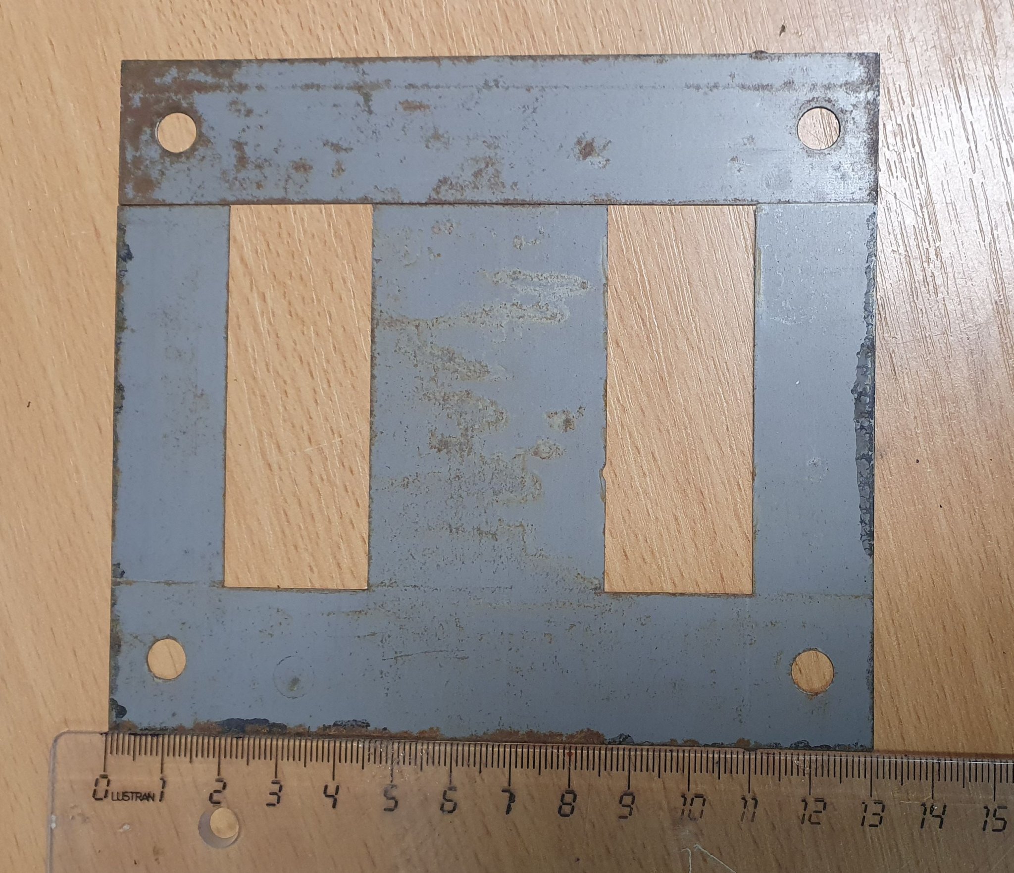

I "found" the core lamination (see pic) on my shelf, and have wound a PP output transformer with 20:1 turns ratio, 60 mm packet thickness. One layer is 0.35 mm. Unfortunately I had no information on the characteristics of the core material. It is a homogenous grey iron, without any visible crystal domains. It looks "better" than common mains transformer laminations, that I also have in the same size, and the crystal domains are visible there. Also the color is different, not so smooth grey.
Has anybody any idea, if it is suitable for the purpose? Actually it works well, but since this is my first and only output transformer design, I can't compare with any other.

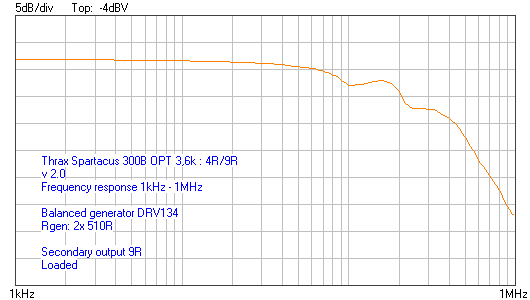

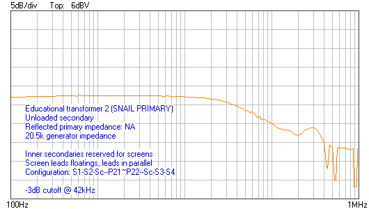

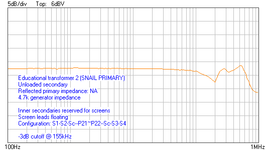

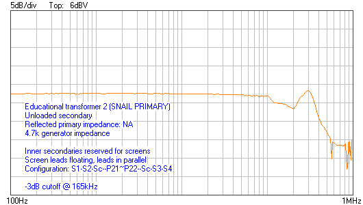

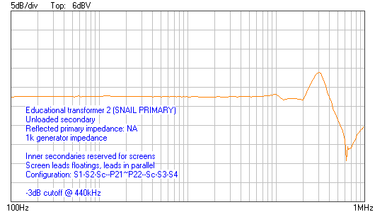

Some more measurements of transformer 2.

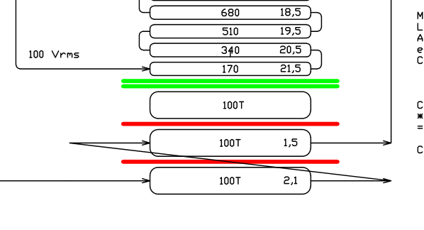

The secondary layers close to primary layers with double green lines, it seems not to connect any other wire. Used as a screen for sheding capacitance?

Yes, the unconnected layers where dedicated for screens and the main purpose of this educational project was demonstrating the influence of screen windings and their connections.

Dear 50AE
The hottest secondary relative potential = Pl/Sl =22/4, which is 5.5, 2.353 is sqrt root of 5.5. How do we calculate this?

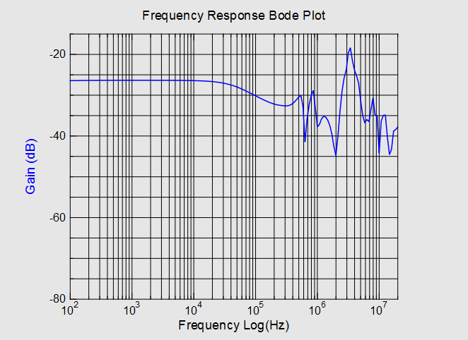

But I like that the dip gets worse and that the peaks are dampened.
For SE without feedback it is not a big problem, usually the tube designs are so "bad" that no frequency above 100 kHz would hurt. Which in most cases is an advantage. In more complex designs with FB, it's totally different.
